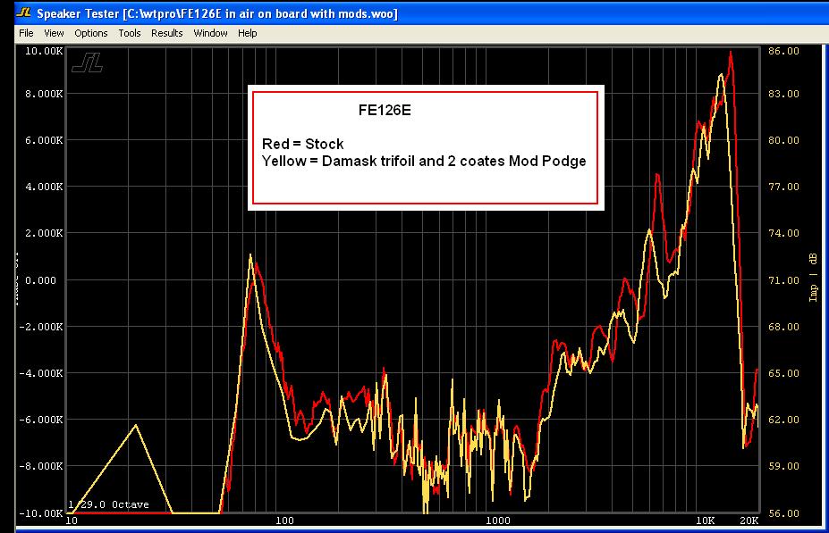

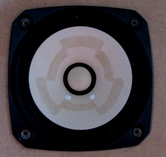

I've just put the damask pattern on one of mt FE126E and let it dry. Swept response measurements of the driver before and after (on a large open baffle board) don't seem to indicate any difference. It's a pretty simple pattern and I applied it with a small brush (see picture). Does it take multiple coats?

On closer inspection I can see a db or so knocked off some the of the peaks. I'm also seeing some small changes in TSP (e.g. FS is down ~ 1 hz).

To match what Dave provides you will want to widen the radial component of that patterns, to the same width as the circumferential portion.. However, if you have two baffles and can place the drivers in a way that allows for a stereo illusion, it would be interesting to hear your comments on the change in sound quality, with thinner and then thicker radial legs.
If not, you can mount them nude on stands, with the magnet braced to get the frame vertical to the floor, along with setting them on some closed cell packing foam to kill most of the reflections from the stand platform. They will still provide bass down to 80 Hz done in this fashion and will not suffer the indignities forced on them by any sort of baffle. You might even grow to like the omni sound, once the EnABL patten has been fully applied.
For the most part, the objective tests do not provide enough information to make treatment decisions with.

Looks like you have enuff... The damar works in conjunction with the puzzlekoat. The whole is greater than the sum of the parts.

I'm sorry if this is a dumb question, but what is the vertical scale and why does it look so not-flat ?
p.s. I'm encouraged by the reduction in the 7kHz peak.

The vertical scale is dB. The FE126E has a pronounced rising high end. You can ignore anything below about 500hz because it's not valid with this particular setup.
dhenryp: Looking at your before and after measurements, you appear to have added some mass to the cone that has lowered sensitivity by about 1/2 dB, and has knocked an extra 2 1/2dB off the 6kHz peak but left that enormous 14kHz peak (20dB) unaffected. This driver needs rather more than surface treatments to rescue it...

Yes, rather more. The EnABL process is yet to be applied and hopefully the two extra patterns that audibly help with these peaks, mid cone and mid dome roughly, will also be applied. I will be very interested to see the FR as the pox spreads.
Even so, a fully tarted 126 is a very lively beast.

You are missing the point here. You are looking at the overall rising response of the driver, a problem that goes way beyond surface treatment. Cabinet loading may or may not go a long way towards bringing down the top end. A zobel and/or some series resistance would help a lot. Also remember that this plot uses a rather expanded vertical scale so as to capture detail. Most manufacturers (like me!) use a 60dB or better vertical scale which smooths thing a lot.
I would like to note the seriousness of the 7kHz spike. This is smack in the middle of the sibilance band. Female singers, particularly those with weak voices and have to swallow the mic put out a huge amount of energy here on "s" and "p" etc. I often have to put a hole in the EQ here even without a spike in the driver.

Bob Brines said:You are missing the point here. You are looking at the overall rising response of the driver, a problem that goes way beyond surface treatment.
I rather thought that was the substance of my post. By the way, I don't call 3dB/div. an expanded scale, it is perfectly reasonable to expect any loudspeaker to be flat to be +/-6dB at worst, with perhaps +/-2dB achievable on a very carefully engineered system.
That driver needs some serious equalisation to tame its basic defect. As for the Zobel taming the peak by 7-8dB, a Zobel can only behave like an equaliser if the driver is driven from a non-zero source impedance. I had assumed the frequency response was measured driven from a pure voltage source, but that was perhaps not the case?

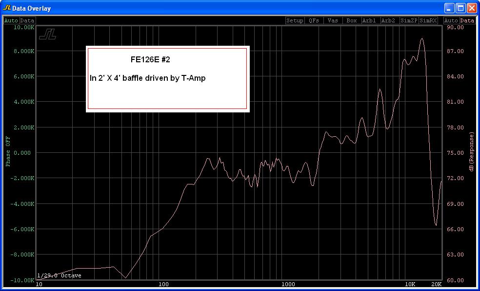

I think there may be something screwy with dhenry's measures... an earlier FR (in the Bugel-Horn thread) shows ~15 dB rise, the one here near 30 dB. And i think the 15 dB is not realistic either. I'll have to drag a Frugel-Horn out and do some measures.
dave
dave
Here is a new measurement using my test rig to drive a T-Amp then the driver. It shows a 15-17db rise not the 30db of my previous measurements. These is also effectively zero change with a zobel and this setup. It seems the output impedance of my "naked" setup is significantly > 0.
Previous measurements in the Bugelhorn and little Big Horn are some combination of amp and no-amp so they are suspect too.
Sorry for the confusion. It's a new test setup.
Denis
