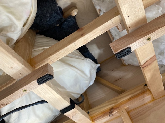

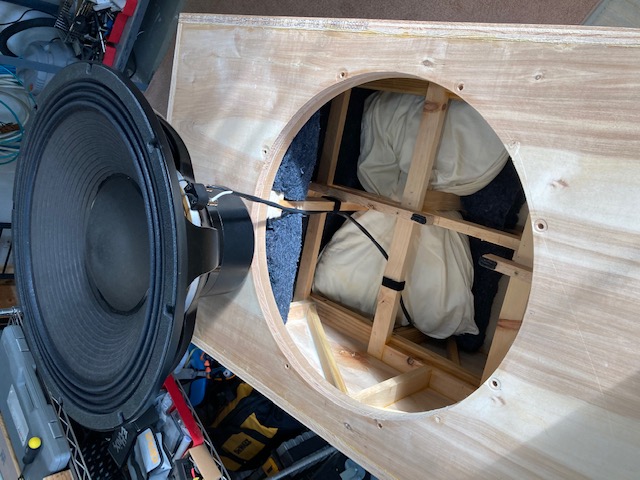

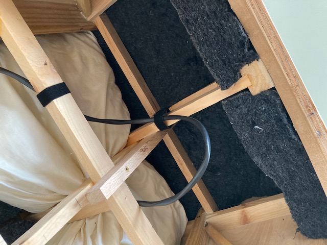

Bracing is mainly for panel resonances and stuffing/damping is for internal reflections/cancelations. Think of the box as a small room. It has the same issues that need to be addressed.
Your bracing looks decent. More never hurts of course. Pipe resonances might be exciting internal box modes. Any harmonic distortion can also excite resonances despite crossing fairly low. I'm pretty confident your issues will be decreased with more damping material even if you kept your port open. Small boxes are easy to get right for bass because they're small in comparison to the wavelengths being produced.

I would cover all bare surfaces except the baffle with the material you have available. See how that goes.
Interesting article, I wish it was little more thorough w.r.t how much stuffing and pics of how it was done. But still really nice. I will definitely be adding more. I was initially told not to bother adding any, but the folks telling me this were likely looking for max output, so that explains it now. I'm going to load the sucker up. 🙂

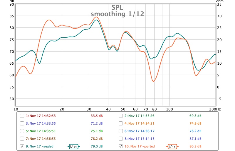

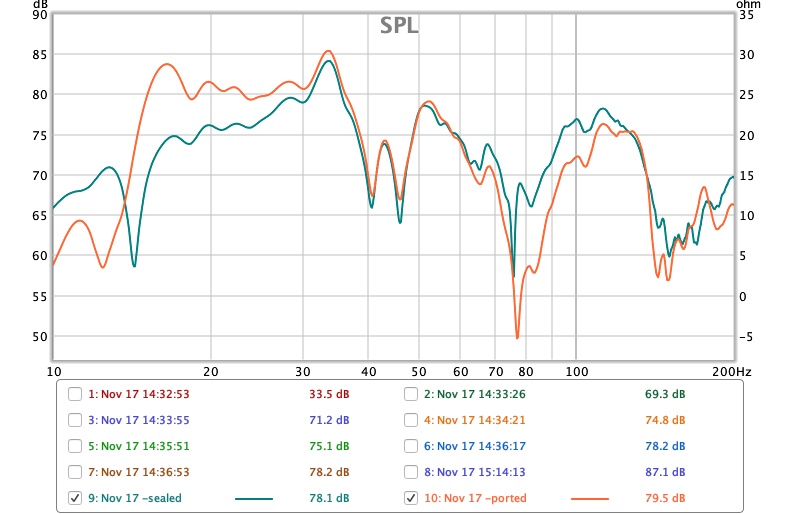

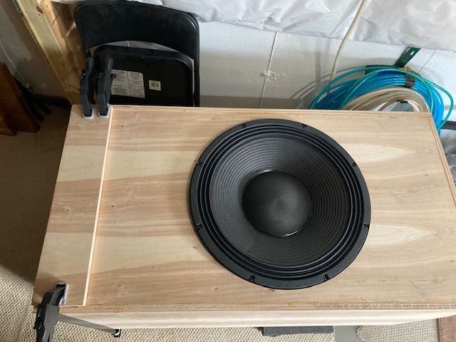

Ok, so I got a boost of effort the last couple days and made some changes to the box. I added about 50% more bracing, especially along the side panels, and it has a better knuckle rap response around the entire enclosure – corners sound like sides. The original lighter wool fill is still in there top and bottom, but I also and three types of fill inside.. poly fill, gray dense wool and two pillows innards… Hey, its what I had lying around. I also added some sticky tar stuff to some strong oak beams that are 1/8” away from the back of the driver basket. This is a trick I observed the Tekton company doing with their woofers (which sound great), so I figured why not. The tar I had on hand is actually... tire plugs. I have the real stuff at work (you know that stuff they keep car audio grills on with), but I was too lazy to go get it. This essentially helps makes the back of the basket a supporting structure and helps reduce vibration on those center support beams. I am not sure what the effective reduction in cuft is after all of this, but I’d guess at least a couple.
I added spare piece of birch and some foam tape to cover the bottom ports. – I hear no air movement when compressing the driver, and it bounces right back:

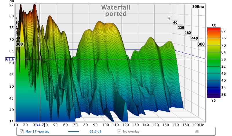

Here are the new sealed and ported response curves. These are the same graph, except the second one is smoothed 1/12. You can see that the ported version is better lower, but the sealed version is a bit smoother up top, all of which is what I was hoping for. I used no eq’ing for these measurements except a 15hz high pass. Like a moron I forgot to take a measurement without EQ before all of the changes, but I do have a EQ’ed one to compare later. And I guess at this point, I don’t really care – I’m using my ears from now on mostly. It definitely sound better now even without any EQ.

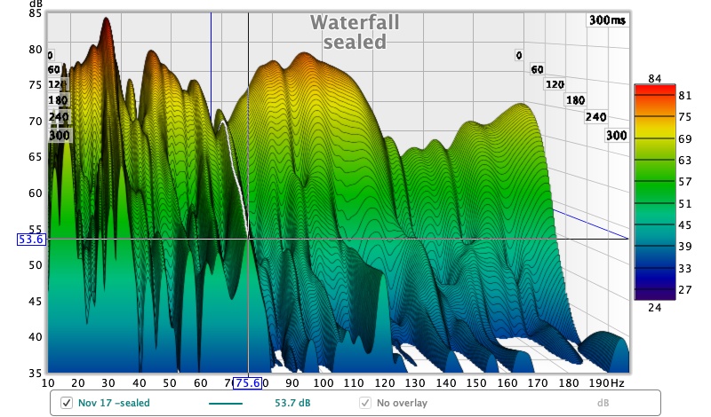

Waterfalls: This is my first time making waterfall graphs, so I may have messed up some ranges there. I was surprised to see the sealed box have a larger decay, but I guess it makes sense because those waves have to dissipate inside and the low frequency waves are much longer than the box – but doesn’t sound like that. The ported box sounds a bit tubbier.
Observations:
•Ported box with new sound deadening is much better sounding. Sealed sounds even tighter.
•It has lost some of that box noise I was hearing, but I lost a LOT of output – more than I was expecting even for ported. I had to put the gains way up from where they were and max my AVR’s sub output. I had to play the measurement sweep at 7-10db higher with the sealed box to get the same max db on the response chart from the ported box.
•Even with everything maxed, I don’t get enough volume with the sealed or ported box. I’d love to hear this hitting a bit harder to see if the nasty noises persist. You can tell especially with the sealed box that its not getting enough juice. With loud music playing with a good bass line, I can barely hear when I turn the sub on and off. I’m thinking about buying an amp again.
•I may have to play with placement; it doesn’t seem to work as well in the old spot as it did before – there is a slight boost to perceived output (maybe just +3-4db, nothing really hot) as I do a bit of a sub crawl around the room.
•Overall, this was a really worthwhile exercise and made a big SQ difference IMO - a surprising amount frankly. I may just be fooled by the lack of output, but we will see. In playing some music through it without the mains on, I could just tell that everything was a tighter right up to 85-90hz or so, then I started hearing the discoloration again..
Observations:

Loss of spl is to be expected going from unlined ported to sealed. Have you hit the clip indicators on the amp yet? Probably time for a bigger amp if you have. If not, you might need another gain stage to drive the amp to full power.
These woofers aren't really meant to go much higher than 100hz. That being said, Josh Ricci of Data-Bass had no problems getting a clean 200hz out of all the 21's he's tested in a 24" sealed cube. You might have to divide the internals into smaller compartments by placing dividers along both planes if you want to go higher than 100hz. Or even more stuffing as long as you have free space directly around the driver(don't want the material to couple directly to cone movement).

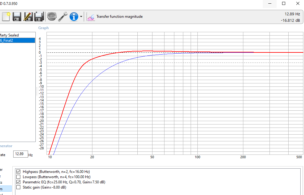

I've never seen the amp clip, but I was playing tonight with my minidsp and I was able to apply a shelf to raise the output 9db before hitting the top of the display curve I was looking at, and that let me get a bit more volume out of it. Its acting like a line driver, but I dont know if there is a distortion tradeoff there.

I believe that amp has a .775v input sensitivity setting. This should get you closer to full power with your current equipment. Might even be able to hit clipping. If that doesn't work, pretty much any cheap little prosound mixer will get the job done.
The amp is in bridged mode on the dsp, are you using the binding post or speakon? Is it wired correctly?
This amp bridged into that box at clipping should bury your other subs in sheer output.
