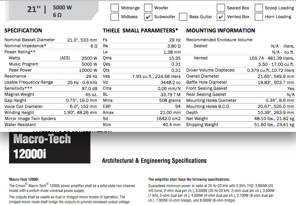

The Crown MA12000i bridged mono is rated 7kW into 4 ohms, 8kW into 8 ohms (20ms).
20ms is only one cycle of 50Hz...
Eminence rates the "6 ohm" NSW6021 for 10kW peaks, it could handle the peaks from a MA12000i with dynamic music.
Subw00er tried the Crown xls2502, which only is rated for 1550 watts bridged mono into 8 ohms, 2.4kW into 4 ohms, so has yet to hear around 6dB of the NSW6021's peak potential.

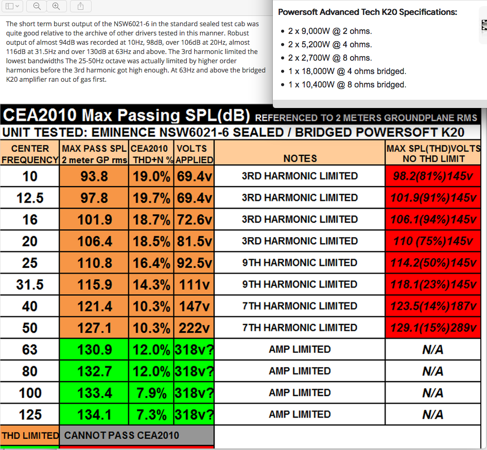

Josh Ricci's Data Bass tests of the NSW6021 using a bridged Powersoft K20 indicate the driver handles peaks somewhere in the 17kW range above 63Hz while still passing the CEA2010 distortion test.

A single driver taking the full force of a bridged K20 is certainly impressive, though.

this level of power handling is also claimed by B&C, they state most field failures of the largest drivers are due to over excursion and not thermal. They also state that long term thermal power handling is limited by the motor structure heating up beyond 100c beyond which the adhesives holding it together start to fail. I have had (far cheaper) drivers fail due to thermal failure of adhesives in the motor so I find this believable:

I contacted Eminence and they used the PL380 (among others I'm sure) for testing. PL380 Power Amplifier – QSC
Its a little bit rich for me, so I was thinking about going with a Crown XTI 6002 which can be found for a little less and only has slightly less power, but still a lot more than the 2502 I tested.. XTi 6002 | Crown Audio - Professional Power Amplifiers
