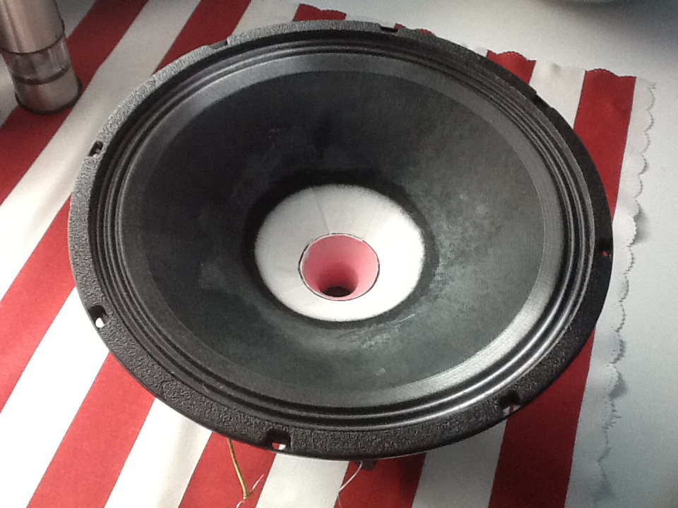

here's a little Eminence 12cx in my pile - its less sensitive than the Martin 1114 but sports a 4" coil, good xmax and 109oz magnet - it may make a nice Karlsonator
Banana skin ?
Sillycone on the floor, ran the can opener and kitty came runnin, hit the spot and slid a**h*les over elbows into the wall
that heavy Eminence is sold by TSG out in Utah - subjectively its not as loud as the discontinued 1114 Eminence coax sold by Martin Sound and neither seem quite as loud as a B&C 12PE32 in another of my Karlson 12s.
I've run the 4" coil coax with ASD1001 and lately with a Mylar B52 compression driver - even the cheap 1001 sounded very good with Fritz Wunderlich and piano. The 4" coil should take some 300 watt peak whacks.
I have bought cast frame Eminence 12 coax with magnet slug weight ranging from 54->80-109 ounces. The old 1114 with 80 ounce magnet is about 6dB hotter than a 206 and a 206 is hotter than a Tang 1772. Eminence's Beta 12LTA is sensitive but imo lacks dynamics with its wimpy motor and 0.08" overhang

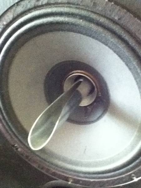

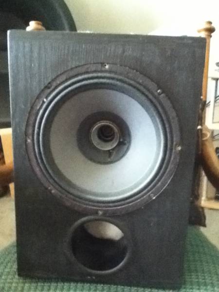

Anybody removed the dust cap on the CX-10 and heard the difference ? Maybe even measured it ?
I heard that difference is insignificant (both measured and subjective). No need to remove dust cap.
I removed the dust caps on my Beta10cx a while back for an experiment for an omni directional speaker. Since I already had the K tubes, I stuck them in to see how it would work.
Personally, I don't think it's worth the trouble. The existing horn works fine, even better according to the measurements, although I didn't measure them off axis.
Here are the pics of the Adire HE10.1 with dust cap removed, with the K tube inserted, and the response curves.

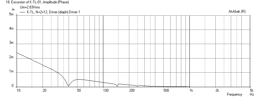

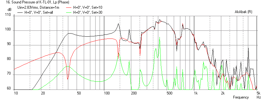

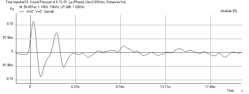

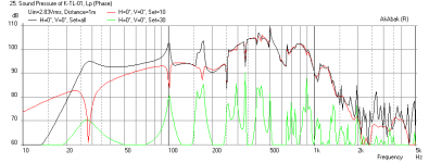

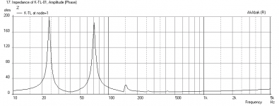

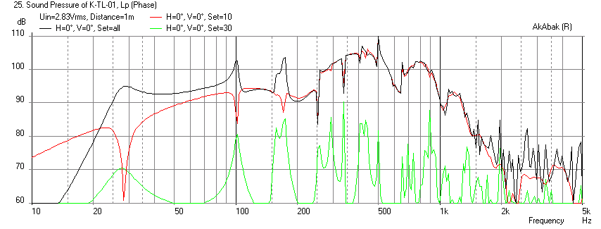

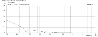

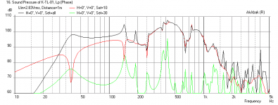

TSG 12844 Coax in Karlsonator
Freddi,
I have been meaning to run this for you. This is a very nice driver - wow some efficiency and mosnter Bl value there. It does well in a standard Karlsonator - but may have a bit too much in 300 to 500 Hz peakiness. This of course can work in a tall stretched out Karlsonator to get deeper bass extension if you want it. The last plot shows a Karlsonator stretched in the vertical and depth by 18/12 and stretched in the width by 13/12 with an additional vent factor of 1.7x. It reaches down to 25 to 30 Hz.

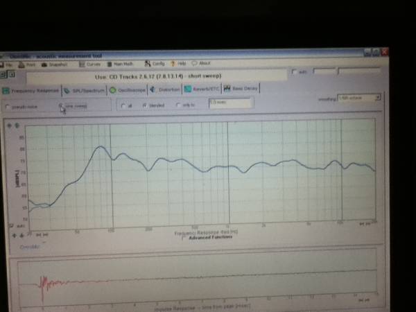

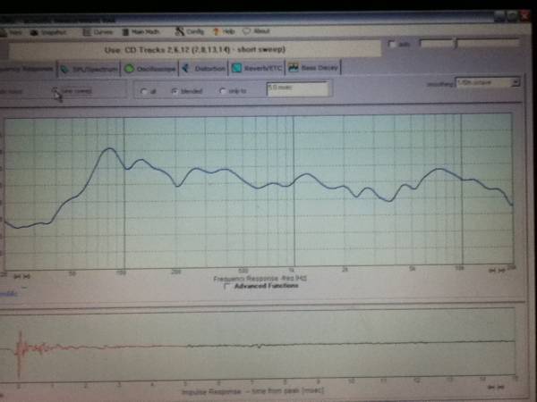

Does the D220Ti sound substantially better than the ASD1001 ? I use the ASD1001 and it sounds nice but I felt it might be slightly less bright than I am used to hearing in a regular 2 way system. The crossover is also an Eminence unit designed for the CX-10 . There is an attenuator for the tweeter . But I wonder if the ( apparent !) reduction in extension is level related or due to bandwidth differences.
I guess I will have to measure the response before trying to tweak anything.
The final design would probably will be in an open baffle with supporting sealed sub. It would be an active 3 way system with stereo sub.
