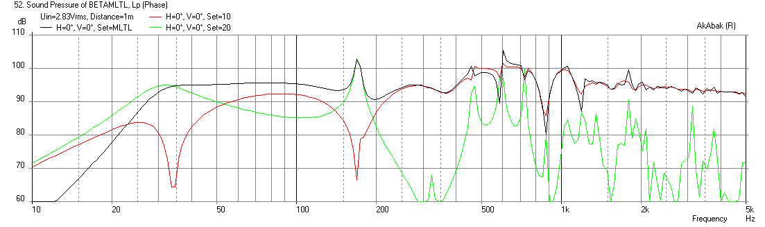

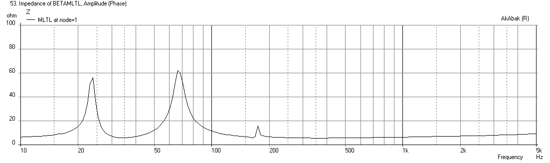

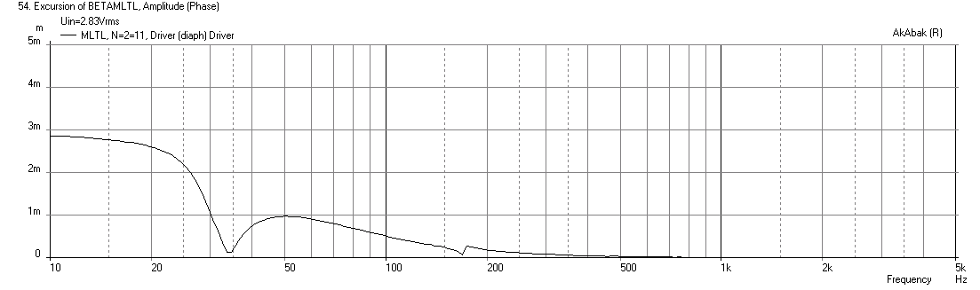

Beta 10CX in a 45 in tall MLTL tower
Here is a sim of a Beta 10Cx in an optimized MLTL. The design is: 45 in tall, 12 in wide, 11 in deep, 4 in dia x 5.25 in long vent at 6 in from bottom, driver 11 in from top, stuffing in upper 2/3rds of TL.
First plot is frequency response at 1 m, with speaker placed against a wall. Second plot is impedance, and third is cone displacement.
This design seems like it has some nice deep bass. The HF will be handled by the CD and horn (not simulated).
