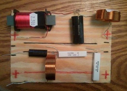

I've had these big guys in my living room for several months, really enjoying them. Finally have committed to cleaning them up with some veneer. Before I do that I wanted to take some more measurements and see if anyone can suggest tweaks or things to try.
I'm a little confused by the dip in the impedance plot @1khz.
These are using the Osprey II network graciously shared from Michael Chua. only deviation from his design was to split it into dual binding posts so I can troubleshoot any issues I experienced as this is my first non subwoofer based project.
They are a lot of fun to listen to, only oddity I did experience was image separation with hi-hats and other HF info, where the vocals were distinctly coming from the center image, but the HF information was clearly coming from the left and the right simultaneous and not blending in the center. Toeing in the speakers helped a bit but its still present on some tracks.

can it be so that the tracks are panned like that? otherwise there must be some frequency deviations between your two speakers, have you measured both, preferable gated measurements? are they in good match?
how does your setup sound when playing mono tracks?
about the impedance dip, it looks a bit strange, do you have a compensation circuit in the crossover? can you show a graph that beginns at 0ohm
