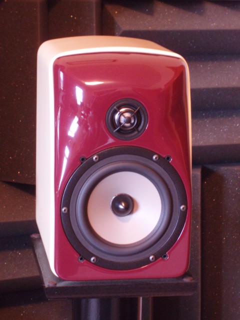

Diffraction can be minimized, even in a nice looking cab by rounding edges and placing drivers carefully. Your design could have a 'cap' on top, either a piece of solid hardwood that matches your veneer or painted (or stained) a contrasting colour. The cap would be rounded on all edges.
I did not suggest that anyone build a bad sounding speaker. I did (kinda) suggest that the builder put appearance before diffraction. IMO the returns are better.
OK, the original poster agrees with you on appearance being higher on his priority list. It's strange to me because he looks to be designing more for low diffraction, but to each his/her own. Somehow I thought this thread was going in the diffraction audibility/reduction and wether or not to design for it direction. Perhaps I will be granted the same latitude by novec as dfidler. I was just saying that he needs to think about the sound and he shouldn't build some wild, but cool looking design that would cause a lot of diffraction. It could make for a harsh sounding speaker and I doubt that's what he's looking for regardless of his priority list.
My current speakers aren't the best of the heap either way--see graphs. I have cost/time as a high priority. Ahh, compromises. The speakers I use in the 2 channel studio are much better in the diffraction depot and again nicer to listen to no matter the room, treatment or furniture arrangement esp at high volumes. Of course they need to be placed w/i the concept of their design.

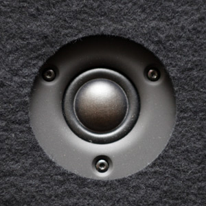

If you look closer at that baffle, you will see that there is felt surrounding the drivers, in particular, the tweeter:
Sorry I couldn't comment before on this - the keyboard on my larftop decided to not do "i" or " ' ", had to swap out the keyboard module...
Afaik the effectiveness of "felt" on the front panel has been considered in depth. Iirc, there was a patent on a front panel treatment that was very thick... I seem to recall that the thinner felt on the front fixed some things and created others...
I also seem to recall that the distance between the threshold of the felt and the driver plays a role... Also I think at least one mfr decided to make radial ^ shapes pointing at the tweeter.

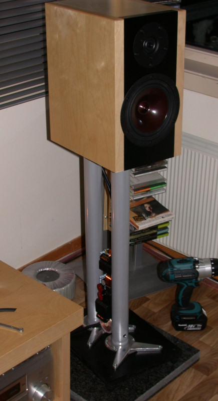

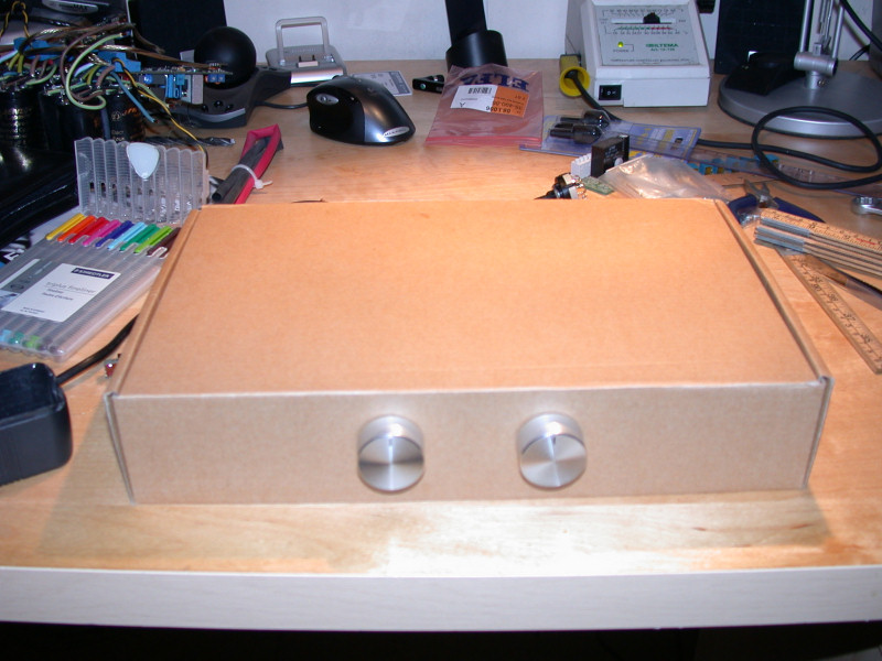

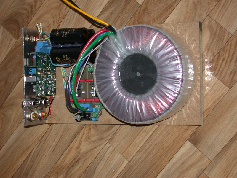

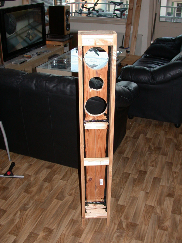

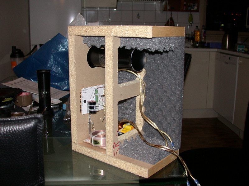

Pics will surely come, but don't hold your breath 😉 I got some pics of my current ghetto setup, however:
1-2: Passive line selector/attenuator with DACT CT2 and a cardboard box
3: Two channel NCD-1 amp with 1300 VA trafo and Jensen 4-pole caps
4-5: Rear speakers with Vifa XT25 and SEAS Excel W15CY001 made out of an old bed. I suddenly had to have rears when Transformers came out 🙂
6-7: dynaBel S2 with Vifa XT25 and XT 18 made from an old desktop from work. I swapped out the so-so internal crossover for one with foil coils and MCap RXF + Supreme. They'll be redone in the same design as the fronts when hell freezes over, as will the center with one XT25 and two W15CY001.

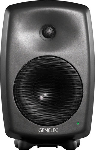

I would show this as an example of a really low diffraction enclosure, certainly for the tweeter. It has large radii on the edges and slopes back to sides substantially less than 90 degrees back. It has more than enough surface area on the front of the cabinets for the tweeter and its wavelengths. You can see in the raw driver curves that the on-cabinet response is really, really smooth.
If you don't mind a little more directivity, then the Genelec models have it right also.
