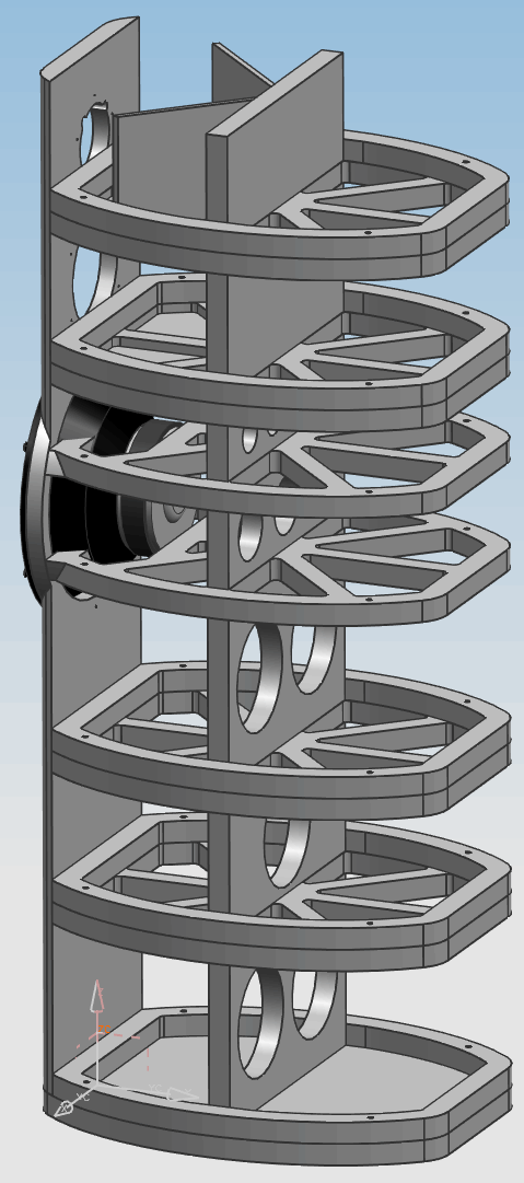

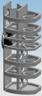

I'm attaching a render of the internal workings. The lower braces are self explanatory. The middle ones have an added crossmember for bracing the woofer magnet. The two upper ones have partial floors and walls to create separate enclosures for mid and tweeter (I'm using a Vifa XT25 without rear chamber).
In a translam like you are proposing, i strongly suspect that each brace is only effective for the slice it is built into. Make the braces separately and run them vertically so that they brace all the pieces.
dave

planet10: The slices will be firmly glued together, so the braces should work for the whole structure. I saw a stupendously expensive speaker being made this way, but I don't remember what it was at the moment. But it's simple as pie to add some more bracing in between there. Mmmm, pie...
Magico. I've seen too many of these kinds of boxes split in a slice to believe that that bracing scheme is effective as possible -- it certainly isn't in a conventionally built box.
dave
Point taken. I've added sideways braces, but I gotta admit it might be just as well to skip the whole slice braces and go for a matrix like bracing with thinner plates. Then it should be good enough to cut out the sides as separate arcs, too. Would work wonders for material waste.

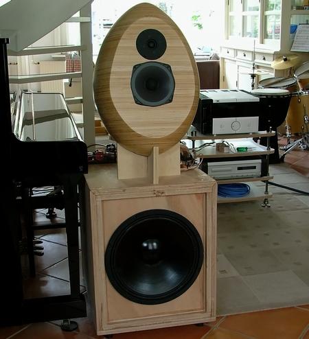

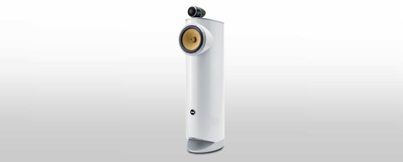

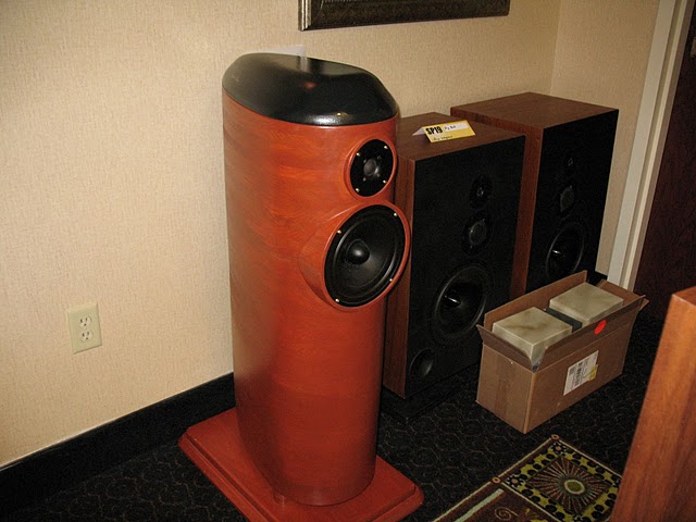

I attached a few pictures for discussion. B&W Diamond series uses a physical shape similar to your first drawing. Picture 2 shows a DIY with similar shape. Hansen speakers in picture 3 attempt to manage both time alignment and edge diffraction.

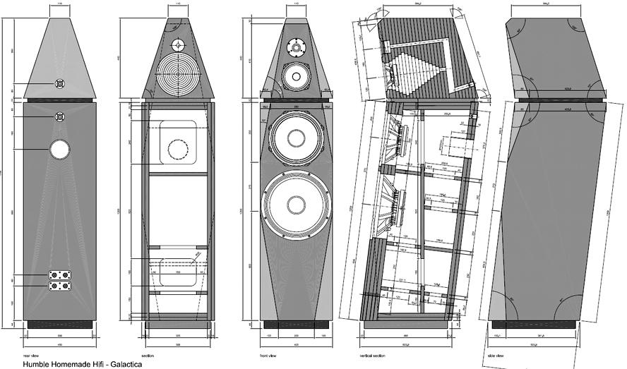

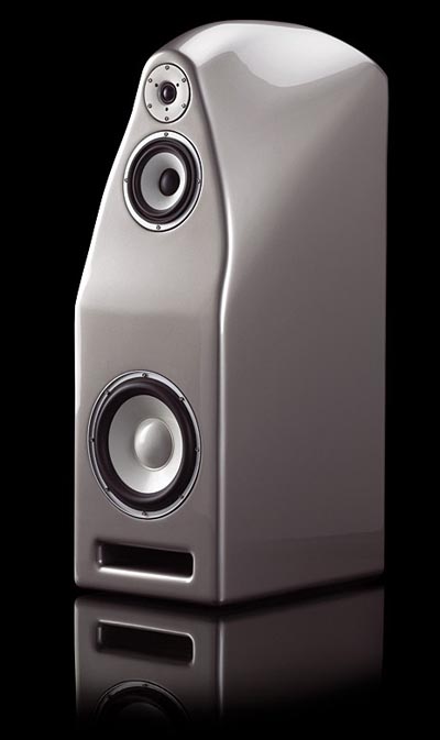

I attached a few more pictures for discussion. Humble Home HiFi developed the Galactica which uses the truncated pyramid to reduce diffraction, and later built the mezzo glactica with a sliced pear shape as a simpler 3-way. The truncated pyramid seems popular as it simulates well in EDGE just as expected from Olson's book.

Some of those cabinet examples, even though they are very exotic and expensive shapes, would be very bad for diffraction related frequency response.
The truncated pear shape, for example, puts a hard ridge around the tweeter in very nearly a concentric circle. This guarantees a strong time coherent reflection for big response nulls. Same with the first group of 3, two of them have raised lips encircling the tweeter.
B&W has popularized the "salt shaker on top" tweeter mounting. Has anybody measured one? Not good, due to cabinet top reflections and totally circular mounting bezel.
These are typical of high end audio today: Designed by the marketing department to look exotic, performance is secondary.
