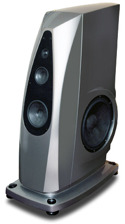

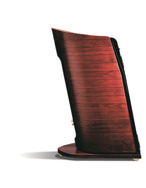

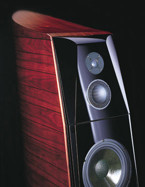

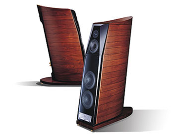

Hi novec,
The USHER BE-20 or BE-10 may give you additional ideas for your DIY.
-truncated pyramid for diffraction control
-slanted baffle for time alighment
-rounded sides-rear for diffraction and resonance control
www.usheraudio.com/news/TAS-BE-20_eprint.pdf

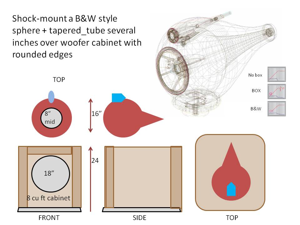

Without hi-jacking novec's quest, but staying on the cabinet diffraction topic.

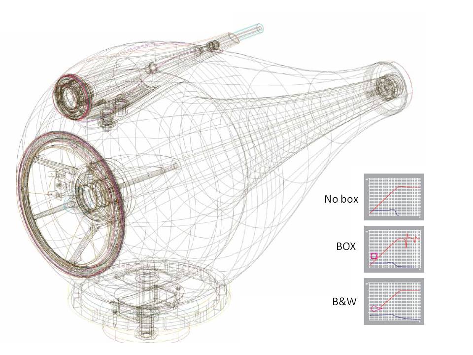

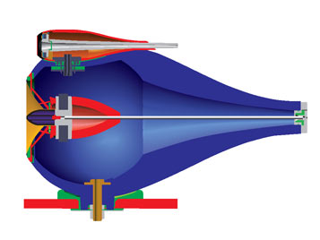

I've been waiting for the AESpeakers Lambda 8M midbass and thinking about Olson's sphere diffraction models along with B&W's whitepapers on sphere + tapered tube for the Nautilus. A small dome like the SB29RDCN or RAAL 70 ribbon would get mounted on top.
Would shock mounting a sphere + tapered tube above a bass cabinet with rounded edges pass critical review in this diffraction discussion?
I think as individual enclosures they are probably very good. Olson's figures certainly showed the sphere to be very smooth in response (but a little low in baffle effect).
I would worry a little about the tweeter bounce off of the mid enclosure and the mid bounce off of the bass cabinet though.
Maybe some effective damping on the particular reflecting surfaces would fix that.

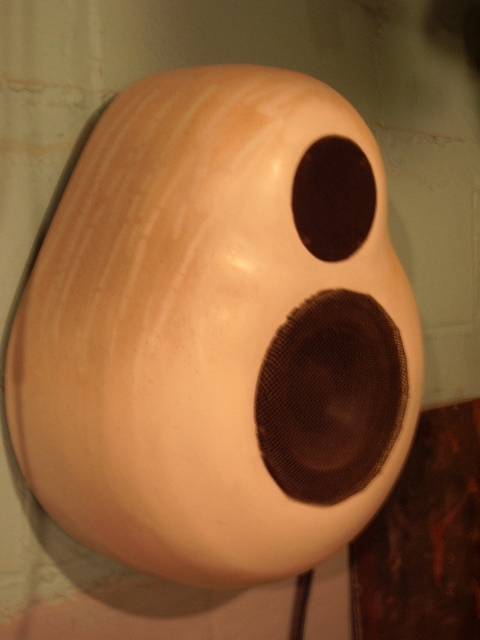

This is an enclosure with minimal edge diffraction. It was made by stacking layers of plywood and particle board, then sanding, sanding, and more sanding. Drivers are nothing too fancy, which is a shame, because the cabinets took a LOT of work and the speakers sound excellent in spite of average driver quality. Even mounted against the wall, they produce a very three dimensional soundstage.

I am curious to see where novec goes with his design...

Madisonears, do you have any way of testing those speakers?
They look interesting!

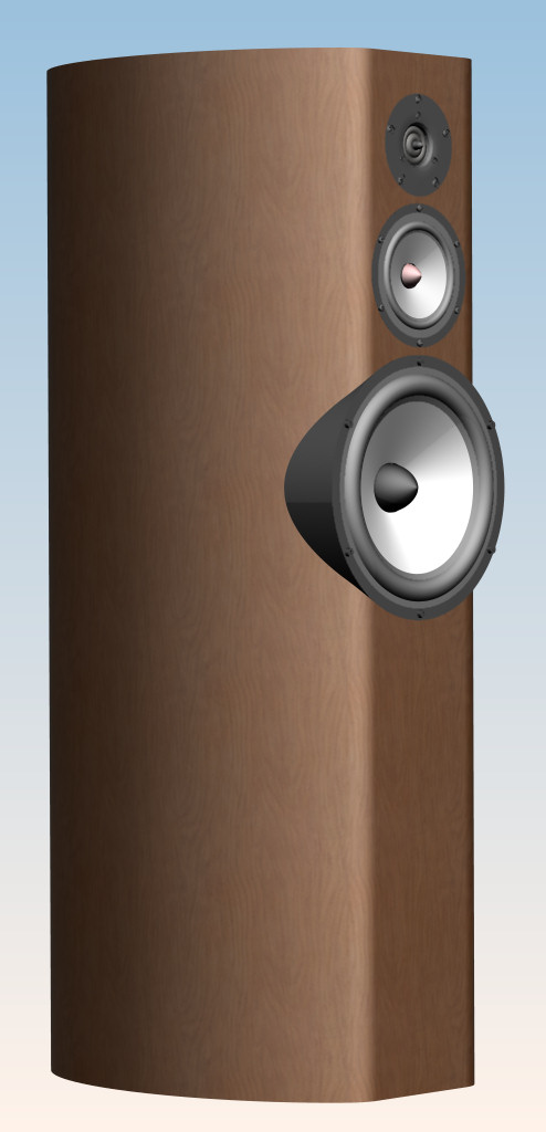

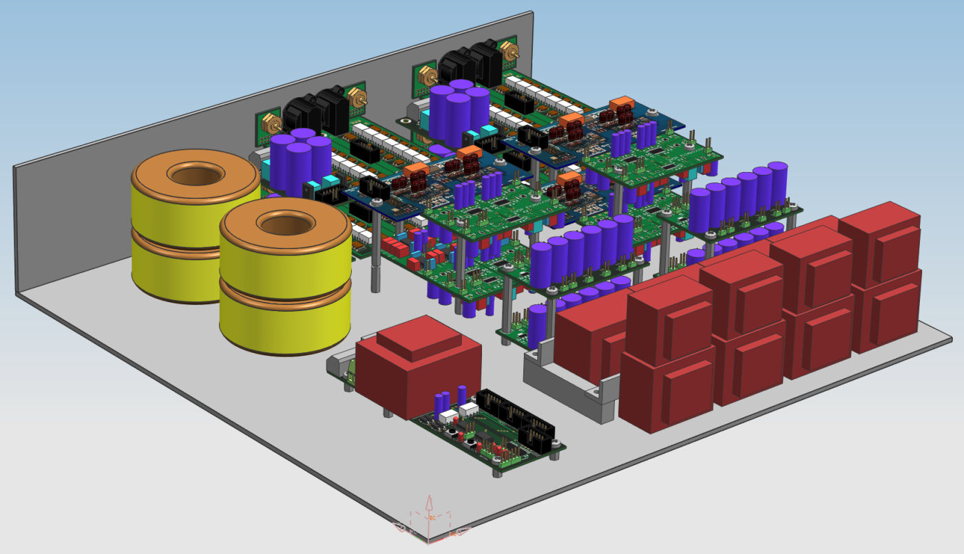

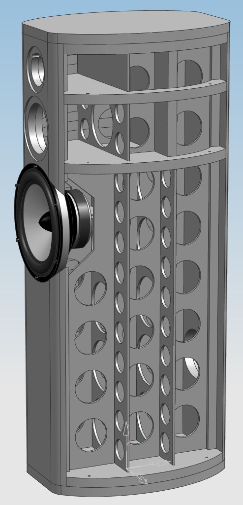

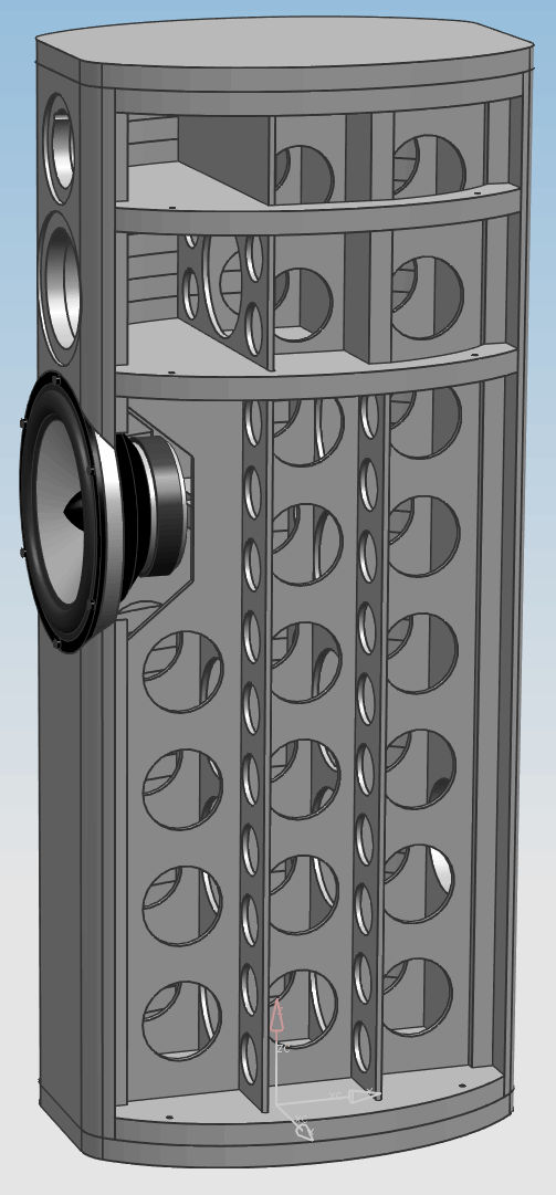

Anyhoo, I decided to go for the separate wall approach with separate bracing. It'll be quite a bit more work putting it together, and with more variables to screw up, but cutting down from five to two MDF boards makes up for some of that. And with ~31 mm side walls, double 22 mm front and back and big mess of a brace matrix it should be stiff enough.
Bad news is that this'll take a while. I'm still waiting on some parts for CNC converting my mini mill, which I need to make the full size CNC mill to cut these babies. Nobody can say I don't keep occupied!
Oh, and then there's the 10 channel DAC...

Hi novec,
Do you plan to use a digital Xover for time alignment as well as the Xover slope construction?
The pictured Altair and Usher designs physically curve the front baffle for time alignment plus controlled edge diffraction. Both have recieved very good reviews. Your CNC might allow you to build a similar curved baffle to simplify your Xover, and allow for a future single amp passive Xover.
Yes, I'll do everything in the digital filters. I've been contemplating whether to incorporate time alignment physically in case I ever want to use them with a standard system, but figured it's not worth it. If I go from digital to passive filters that'll be the least of my worries...

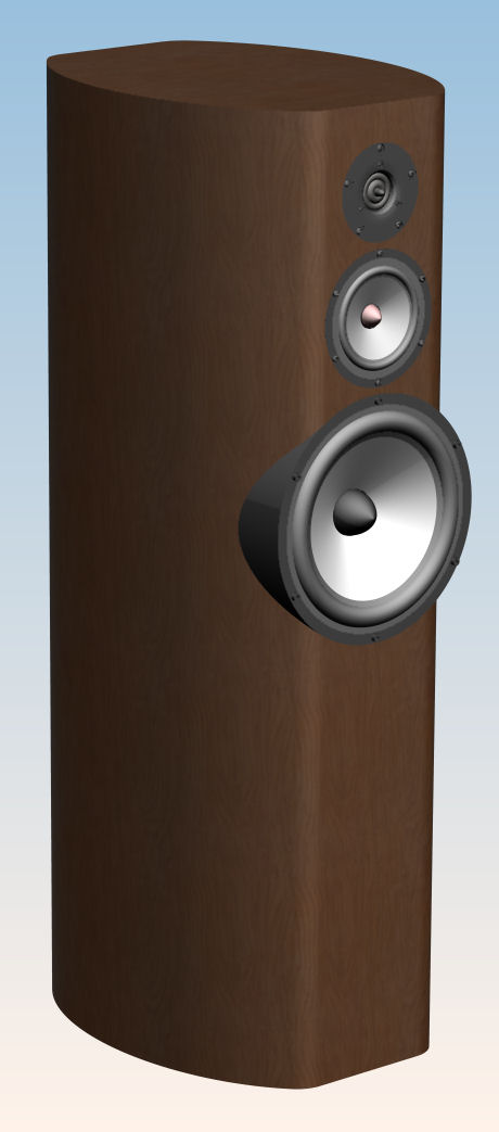

BTW, this was my original design. After waiting a year or so I got bored and started fresh 🙂

And just to prove my point (or mock myself) I'm attaching some "prettier" renderings 😉

Back to the speaker design in question....
Your top edge is still square and is going to diffract for all three of your drivers. Whether that will be a remarkable problem, I don't know.
