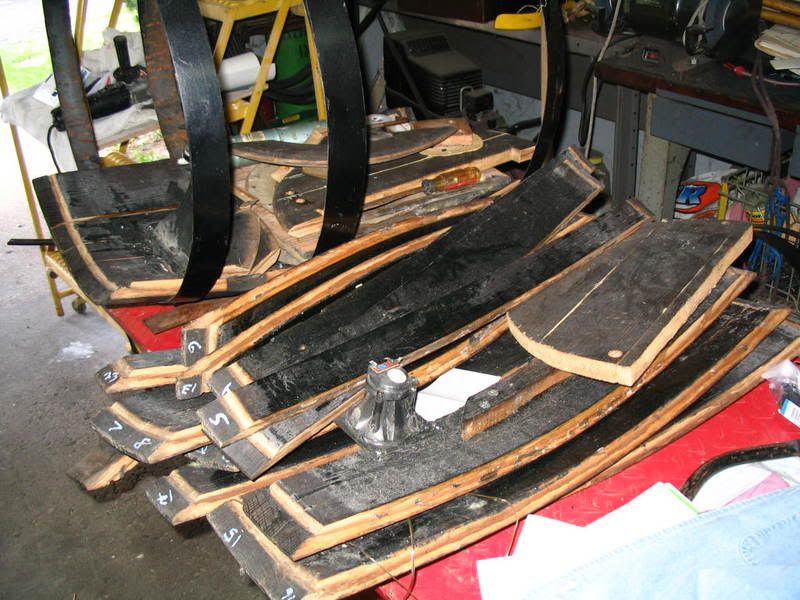

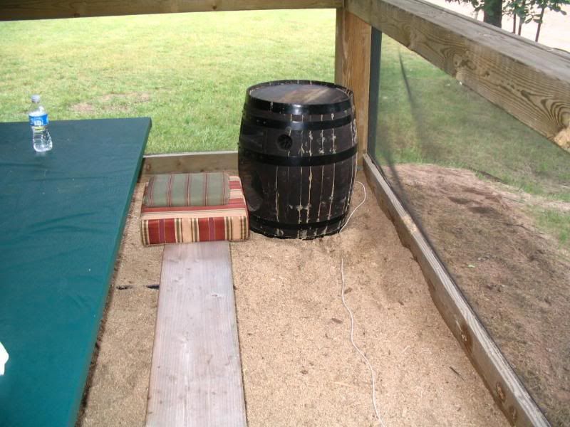

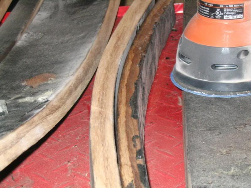

I have these in the screened in porch at our cottage. I still have to sand down the second barrel. They are genuine Jack Danials barrels.

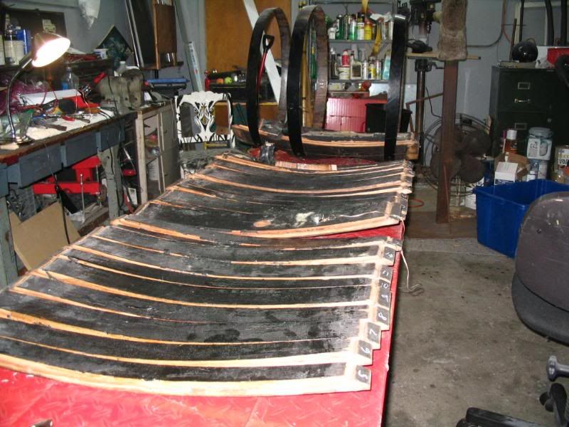

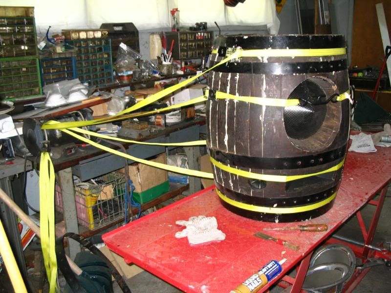

The woofs are behind the cone made of mesh in the woof holes. The woofs are Dayton 12", the horns are Magnivox, and the tweets are pro Peizos. I bought they from a guy that built them 30 years ago. All the drivers were shot and all the slats (stays) were loose. I had to take them all apart and used Liquid Nail to reassemble.
I plan on sanding down the other one this summer. They have a simple single order crossover that I designed.
So they're actually inset into the enclosure; interesting and really neat. I've often wondered what doing that would do to the sound. Would doing this create any diffraction artifacts?
Do the long wavelengths of the low-end make it so that it doesn't matter or will that sharp edge at the end of the channel be a prime example of edge diffusion? (I suspect the latter).
That inset is a worst-case diffraction scenario- still REALLY cool looks though! You could put a bevel around the woofer cutout to make it a very ideal setup.

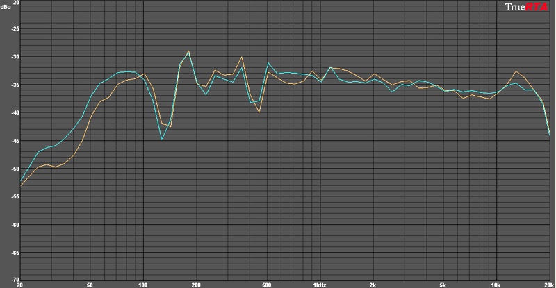

Here is a typical floor bounce measurement. For testing the two speakers were about 3 feet off the floor and 3 feet 10 inches from the mic. At a normal listening distance the cancelation frequency would go higher (floor bounce path and direct path get closer in length) and room modes would start to obscure the dips.
Note a third harmonic at around 400Hz.
