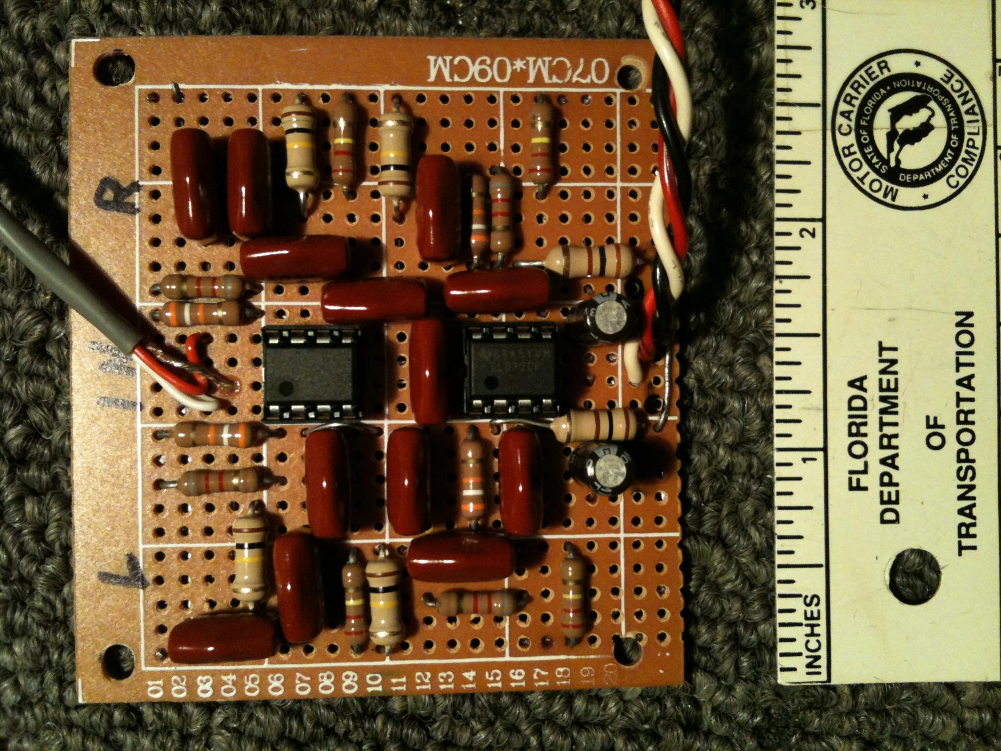

Speaking about Phono Preamps...... and Veroboard... I just finished making the Project 99 - Sallen-Key Subsonic Filter by Rob Elliot to add onto a Harman Kardon 330A receiver. I wanted it to be as compact as possible, to mount on the reverse side of the phono preamp mounting panel.
I've made and installed these filters on several things so far with excellent results. It effectively removes any audio below 20 Hertz, which is unneeded anyway - turntable rumble, record warp issues, and bass speaker feedback issues. You can't even notice any audible difference in the audio, and it helps eliminate that power-robbing subsonics in the amplifier.

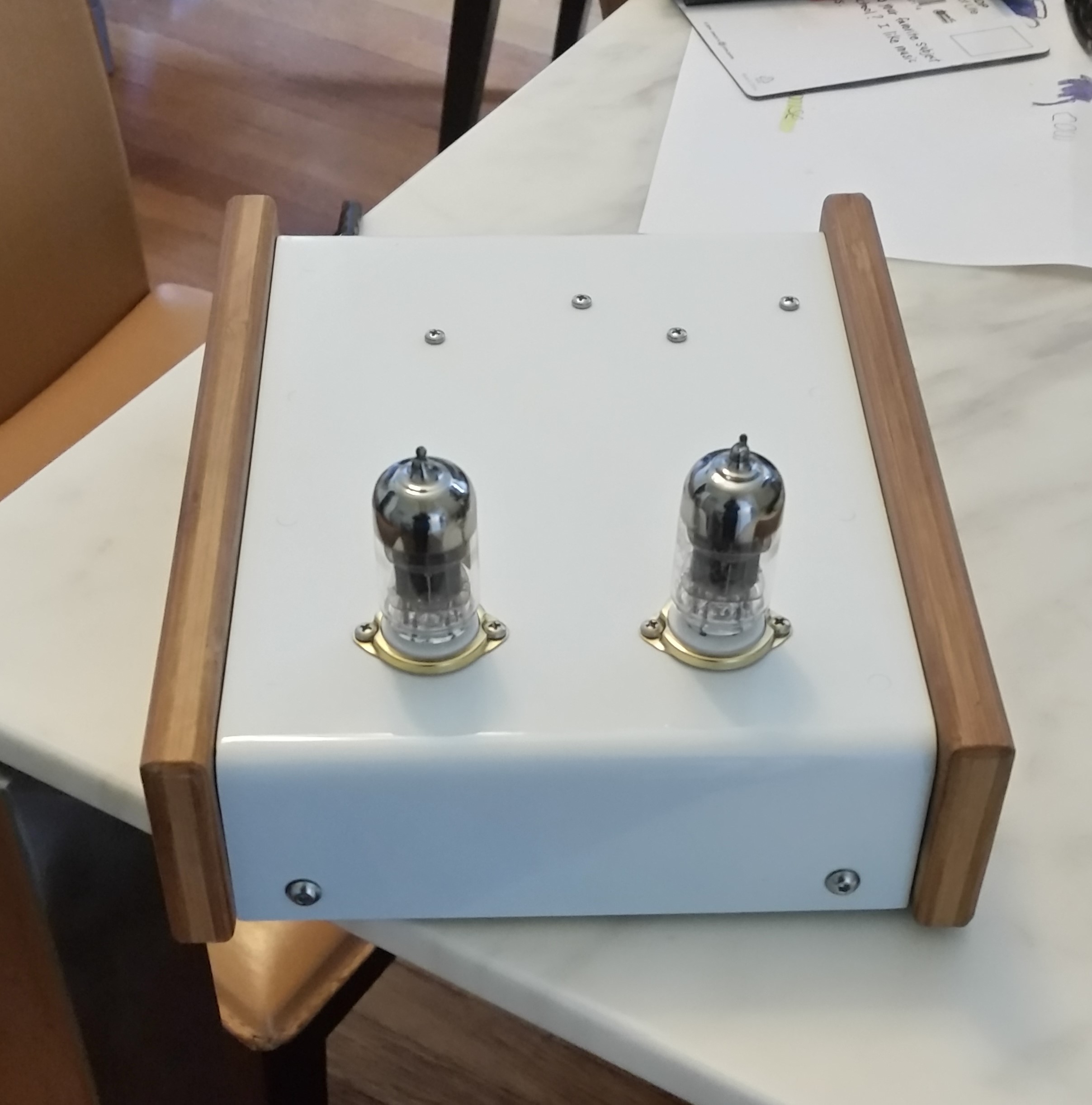

So I finally finished building this phono preamp.
It sounds great.
I'm using a switching power source as a temp power supply. I mentioned it earlier. I'm getting a buzz that sounds like a bee. I believe it's coming from the power supply, so this power supply will only be temporary.
I will build the one recommended on this thread for this phono stage.
This is my first build from scratch, and I'm very happy with the results.

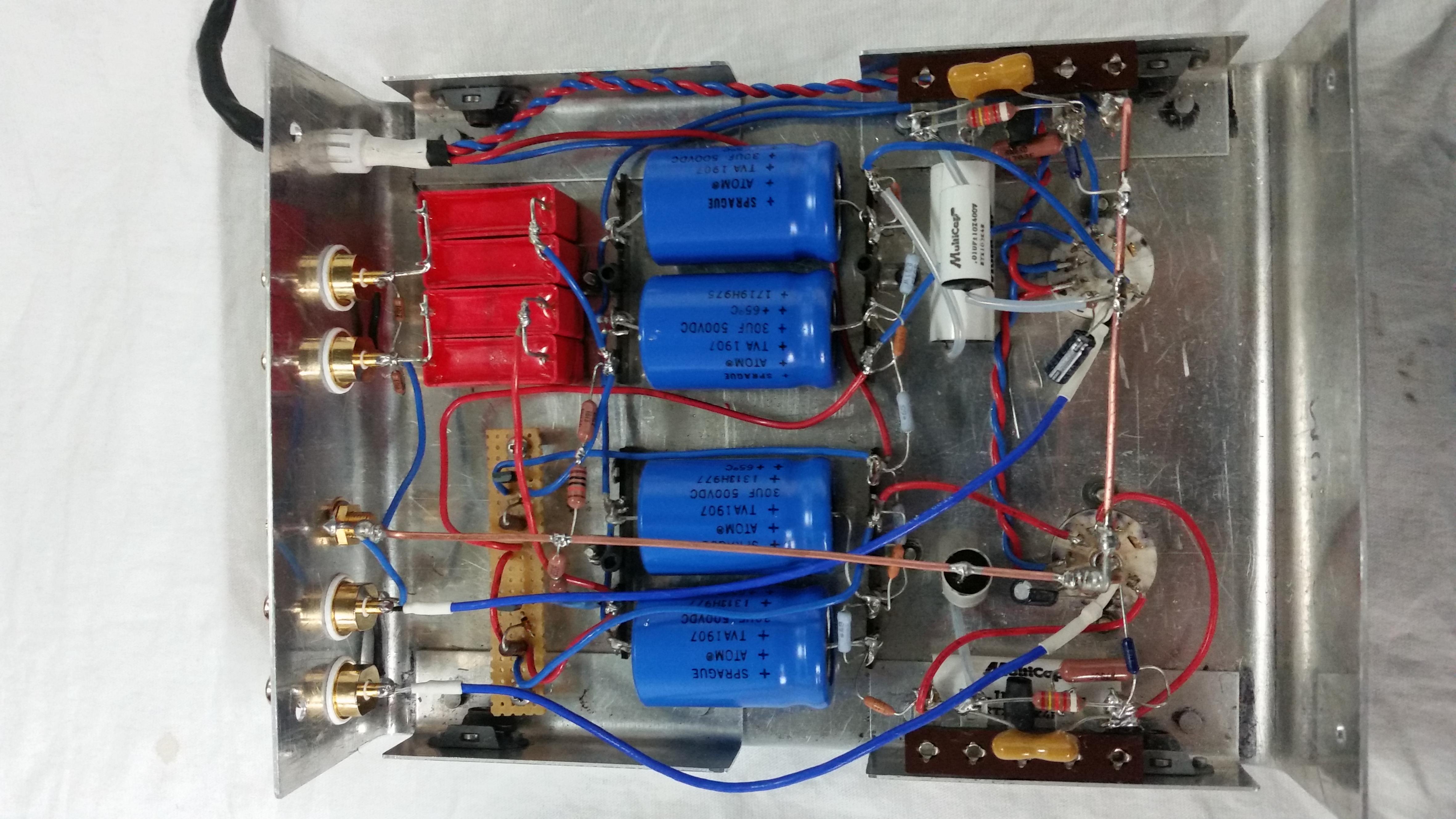

So I've met up with Greg now. His 12V supply was too small and wouldn't start. I had a 6A version which started into the load. There was still motorboating. I added a 2k/100uF RC filter to the supply which solved the issue when using both SMPS, one for heaters, and the other for B+. When he got it all home and tried just the single supply, it was motorboating again.
The circuit is drawing 30mA @ 250V. This seems high to me (my 8 tube phono only needs 50mA). Maybe Eli can comment? I've never built a hybrid. It would also motorboat without the tubes, just the MOSFETs, before I added the RC filter.
Hopefully Greg and I can meet again soon. I didn't even open the phono amp. I modified the external power supply. But a 2k resistor that I added is dropping ~60V. Thanks for the info, Eli. I guess we'll have to open it up and do some useful measurements... Any reason you didn't design this using a depletion MOSFET like DN2540?

I get 300v before the 10k resistor and 250 after.
kylej1050
the smps power supplies are external. Just mounted on some wood for now. I followed the schematic that was posted earlier on this thread. I used 30uf decoupling caps in the unit.
The added RC filter is external to the amp, the amp has whatever it was designed with inside it though.
Now that we know the circuit is running property current wise, we can ad a zener string to regulate to 250V instead of relying on the adjustable SMPS. I highly doubt it would motorboat with the type I showed you that is fixed but adjusted with a jumper, either. Especially that you got the +- supply rather than the + only, and you aren't loading the - side.
