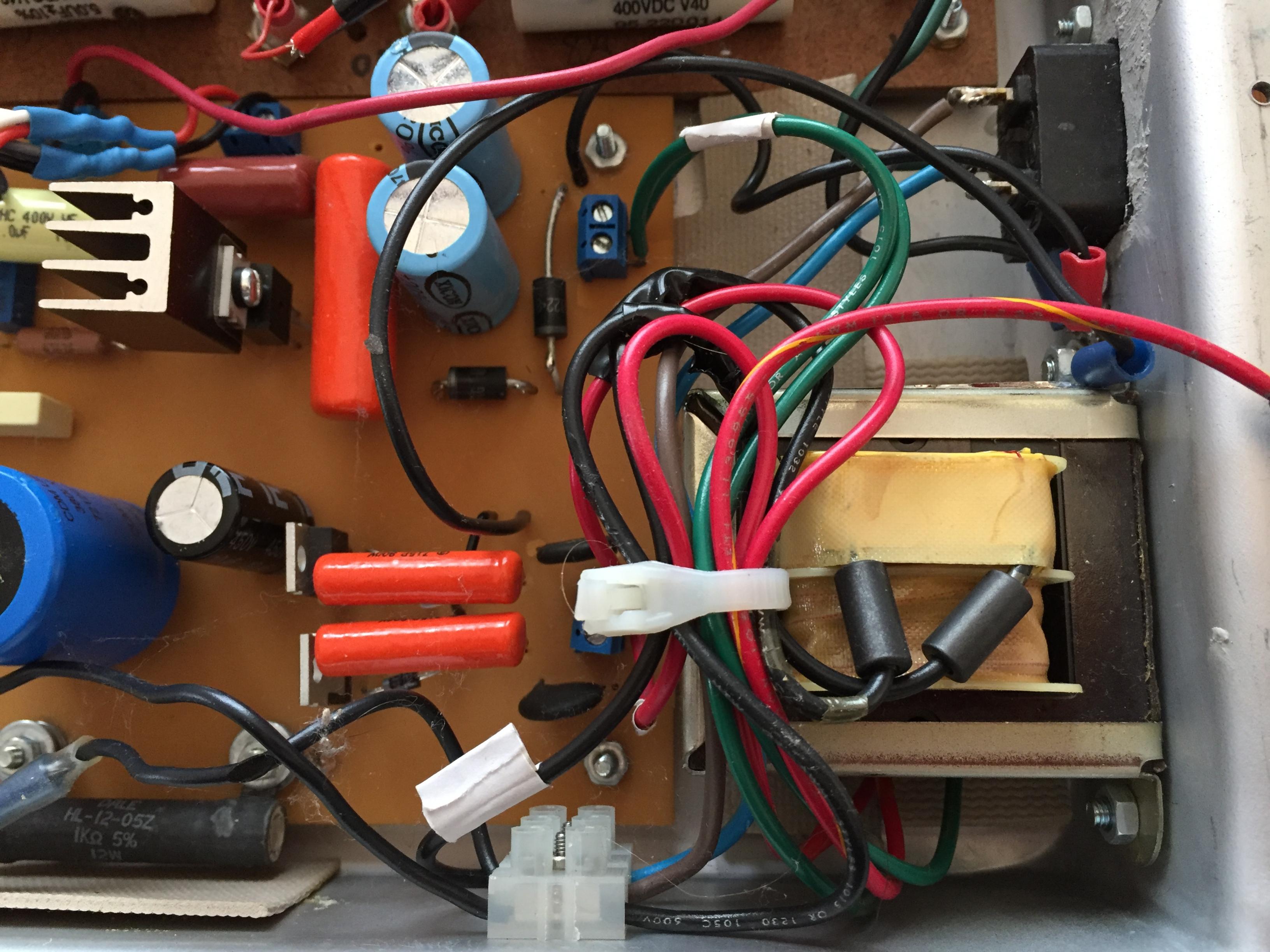

Hi, Wavebourn,
I grounded the power supply directly at the rectifier. No hum or buzz. Any other point created a hum or buzz. In the attached photo, see the black wire originating from board just under the horizontal orange drop capacitors and going up and over to the chassis lug on the far right.

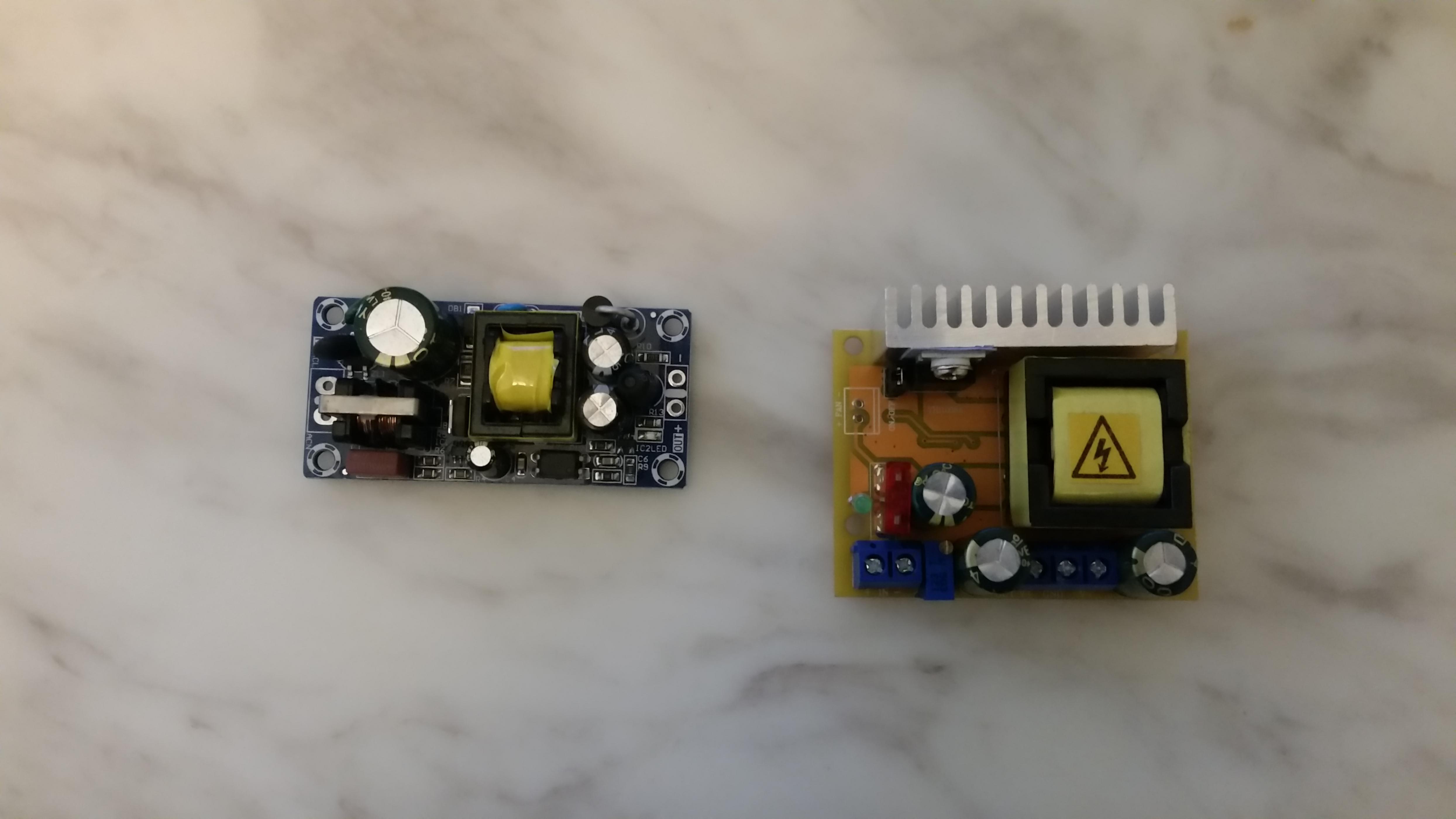

What are your thoughts on using a switching power supply. i have a ac-dc converter and a dc to dc booster. I can use these to get the B+ voltage to run the phono preamp. I was going to try this out and see how it works. If it works well I'd keep it if not i can build a tradition power supply. Eli do you have a better resolution image of that schematic for the power supply?

You should draw the ground from electrolytic filter capacitors, instead of from the rectifier, to avoid pulses charging them to be applied to the signal. It may not be a problem in your particular design with very short trace between rectifier and the cap, but people following such schematics make the same error again and again.
Sorry Wavebourn, schematics are explicitly NOT meant to convey wiring or layout information. Look it up in your favourite reference book if you don't believe me.
Why are you sorry?
My favorite reference book is a school book about electricity and Ohm law, with problems to solve about series and parallel connections of resistors, assuming that ground wires also have resistances, and currents that flow through them cause voltage drops. 😀
Yes, schematics are schematical and do not have to show layouts, but it is a very common mistake when people treat them literally. Especially, when they insist that the layout as drawn on the schematic is the best, results in less hum and buzzing.
I get no profit from stressing common errors; contrary, I would benefit if my competitors make such mistakes routinely. So, why you should be sorry then? 😀

I will give it a go. I have a felling it will be temporary. The switching power supply coverts 120vac to 12vdc I was hoping to use that output for the heaters on The 12ax7 tubes.
