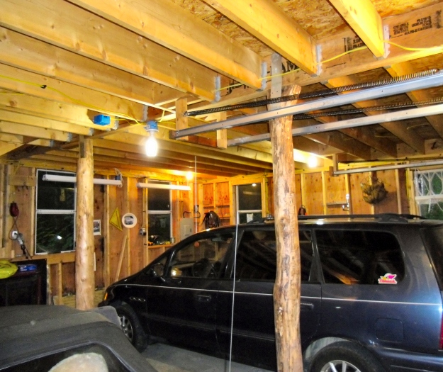

While I do believe in using an 8-inch tree-trunk where a 3-inch post would do the job, I would not use a 24-inch trunk. (I have a couple laying around.) If nothing else it takes-up good space for no great advantage.
