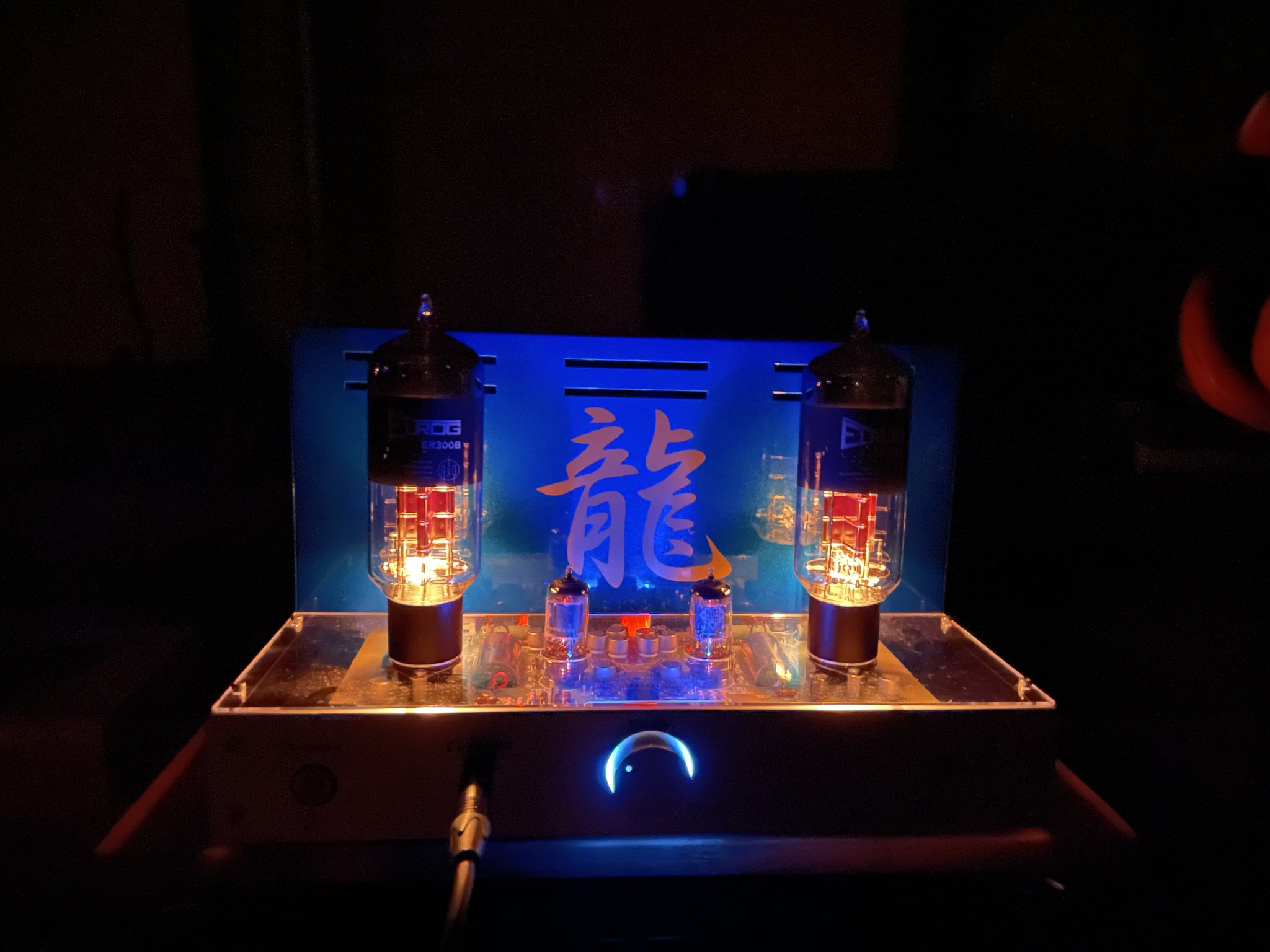

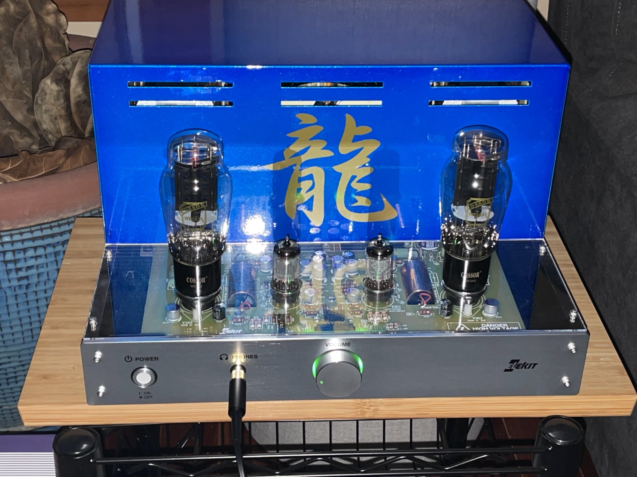

I like the paint job and I agree with you about the clear cover versus the steel cover. I like looking at the PCB, the big AN caps and other components all softly lit up by the back-glow from the 2A3/300B LEDs and the LEDs of the power control modules. I had my transformer cover powder-coated a bit brighter blue by our local hot rod shop, It came out pretty nice.
(The Elrog 300Bs with their bright filaments really light up the amp, visually and sonically)
But seeing the light show from yours with the volume knob removed has gotten me thinking -- maybe I can find a clear knob to use. I really like the colorful display. The green in particular made me think of the Incredible Hulk.
Great job and thanks for sharing.

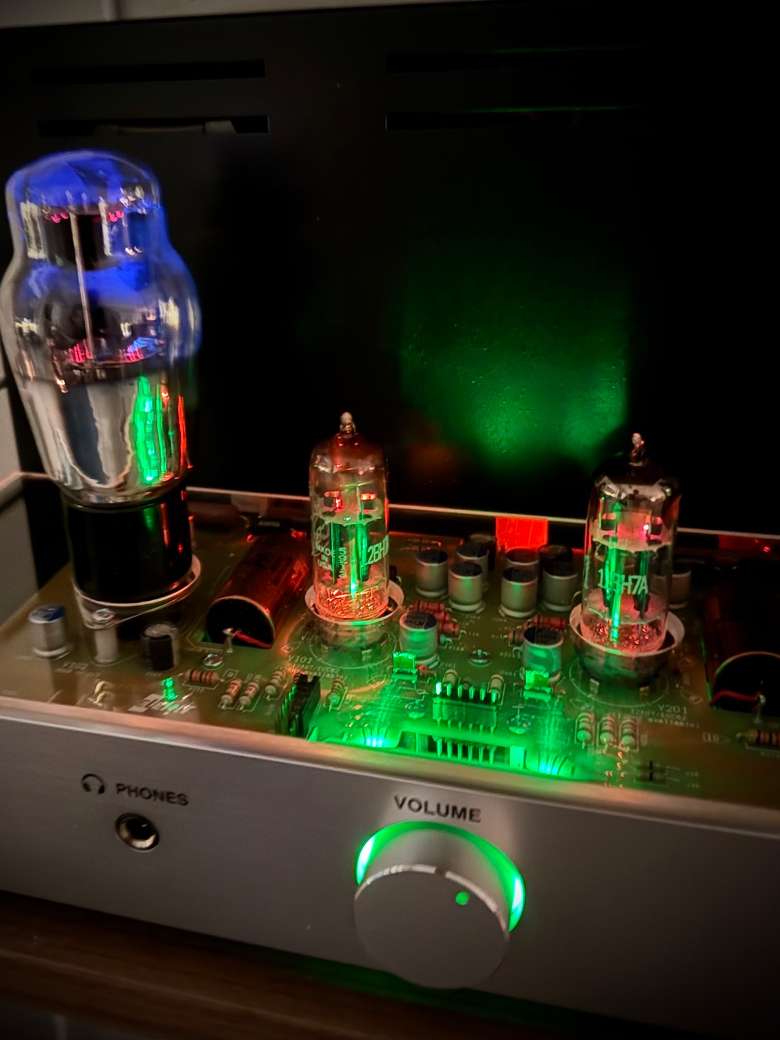

I fitted a clear lid but my vanity wish for amber instead of green lights as tube indicator. Is that possible to change?
Sure, as long as whatever color LEDs you want are the same ratings at the green ones currently installed you could swap. They are turned on and off by the voltage control modules that sense whether you have 2A3s or 300Bs installed.
