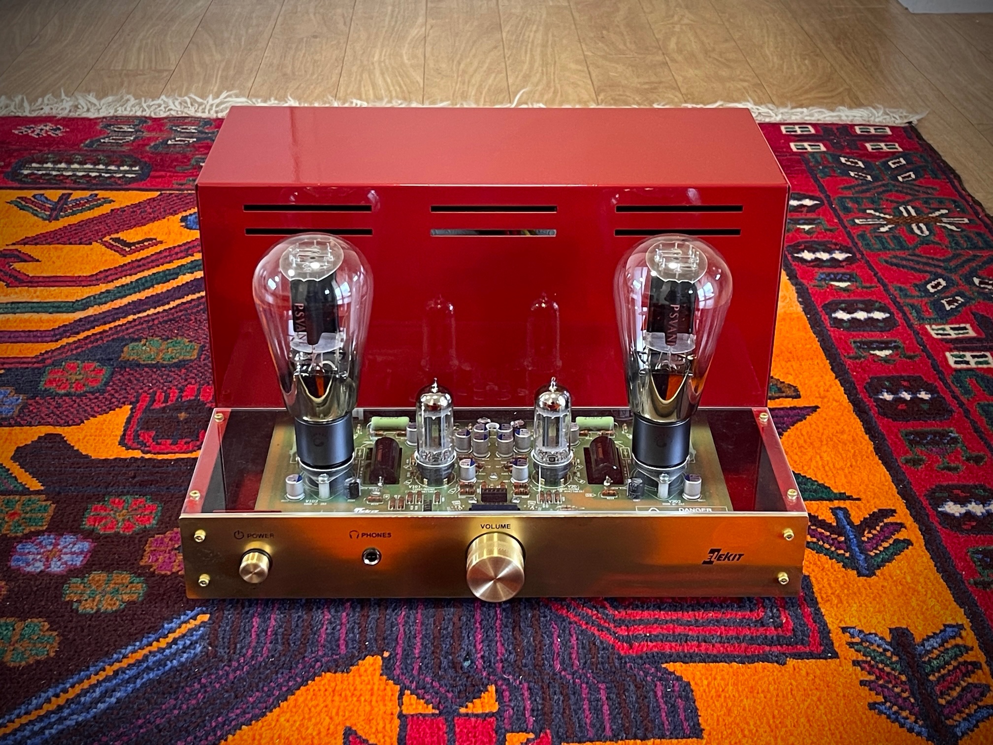

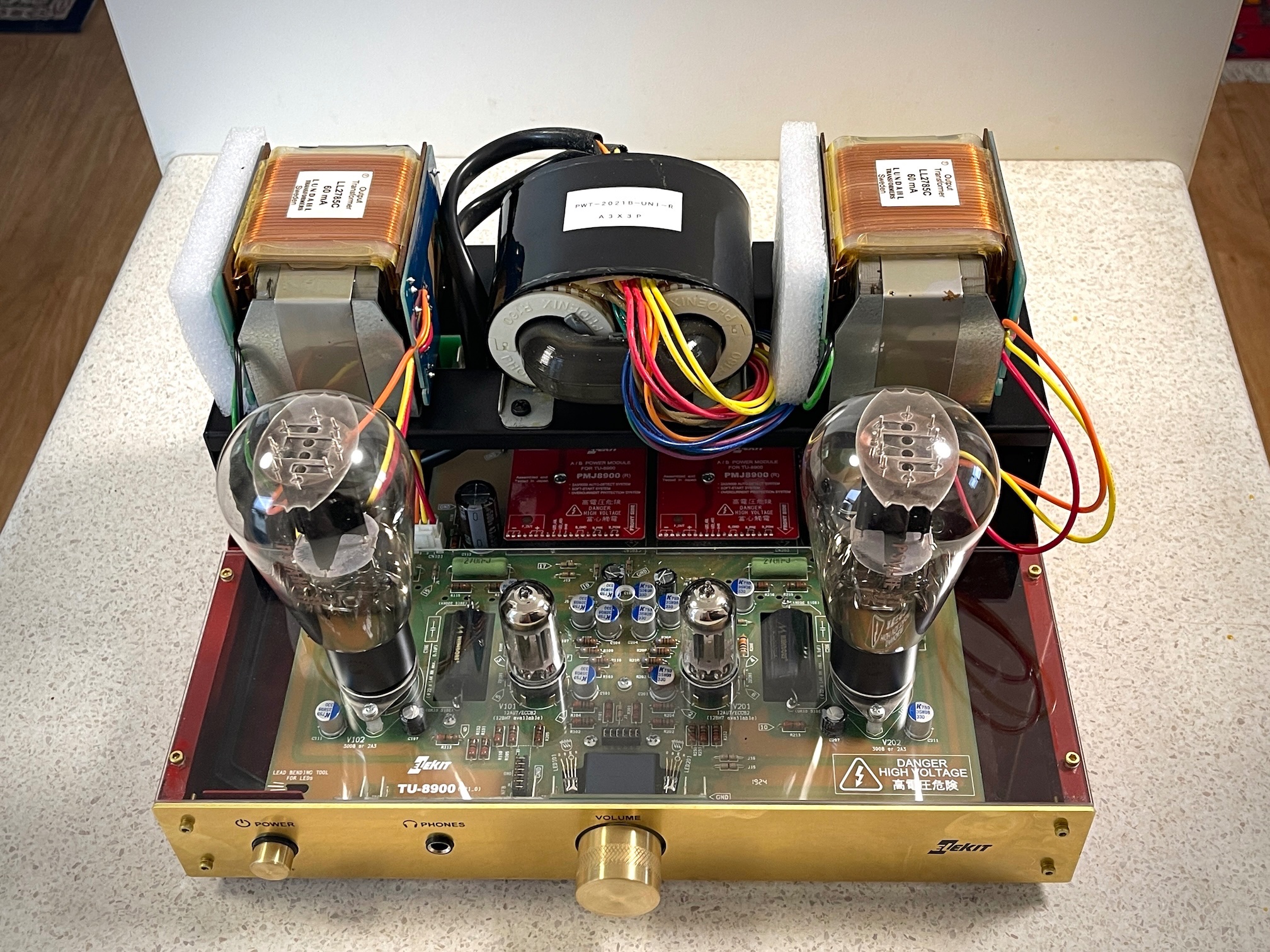

Another Elekit TU-8900 sang its first song today.

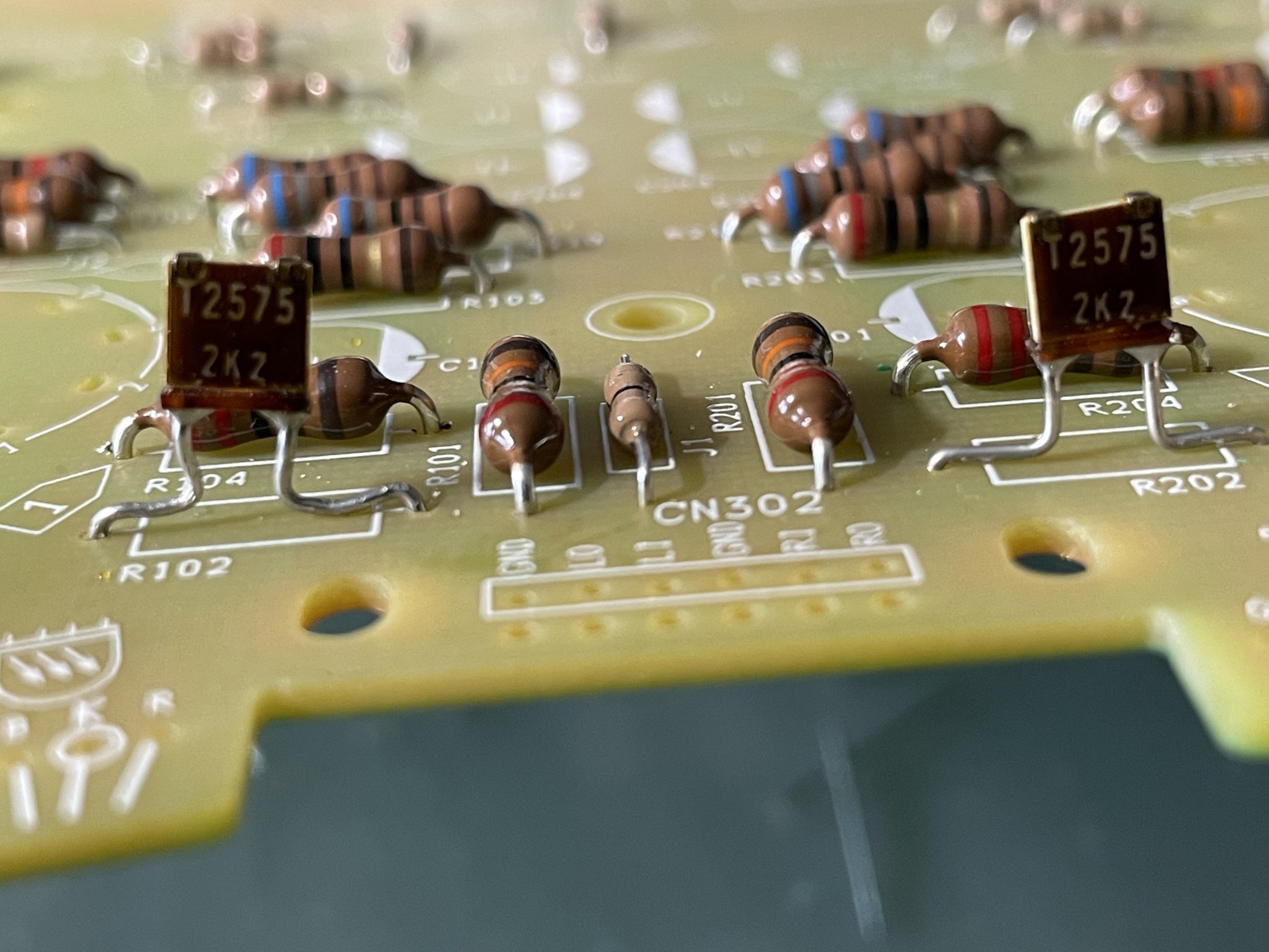

I'm in Australia, so I bought my kit through the Australian agent, Secret Chord Analogue. Their version of the TU-8900 comes with Lundahl amorphous transformers and Mundorf capacitors, and I added Audio Note tantalum resistors and an Alps potentiometer. When I ordered it, Secret Chord didn't have any Lundahl transformers in stock, so I had time to assemble it, paint the cabinet, make some brass knobs on my lathe, get a brass front plate printed, and buy a set of valves. It's running Psvane Acme 2A3s and Electro-Harmonix gold 12BH7s.
The transformers arrived this afternoon, so I immediately soldered them to their circuit boards and finished the installation. In the future I'll look at upgrading the capacitors to Vcap or Audio Note, but I figured that if I'd paid for the Mundorfs I'd try them first. I'd like to thank Victor too - even though I'm not a customer, he answered a query I had about the Alps potentiometer. (For anyone else who wants to fit an Alps, you don't need a different circuit board. Also, the Alps part number is helpfully printed on the board!)

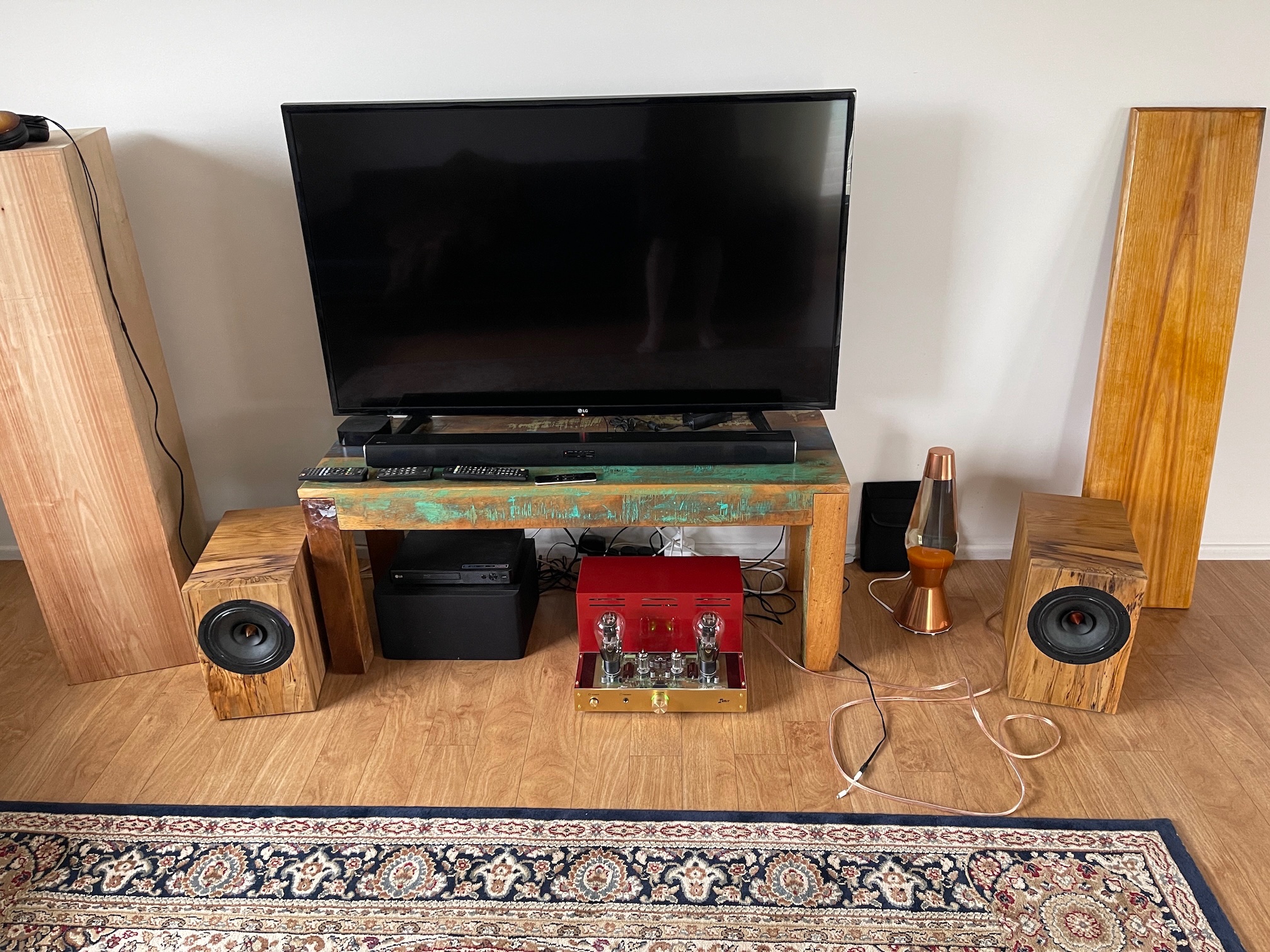

As for speakers, I'm building a pair of Singularity enclosures for Dayton 8" full range speaker drivers, but the drivers aren't due in Australia until mid July, so in the meantime I hooked the 8900 up to my smaller desktop speakers.
And the first song? The Velvet Underground's Oh! Sweet Nuthin'.
The first and unfinished Singularity speaker is on the left. It's not small, or light.

The brass looks good! How are you liking the acme 2a3’s? Have you had a chance to compare them to any other 2A3?
Thanks! I haven’t tried any other 2A3s, and my Acmes only have a couple of hours on them. My first impression was that the music was clear, without any background noise. Even with smaller speakers, I got a clear sense that the music was around me, instead of just in front. I wasn’t expecting much on a first play, and was really pleased.
When the larger Dayton full range drivers turn up, I’m hoping for the same experience. And one day I’ll get some 300Bs and see what all the fuss is about. But those 2A3s sound sweet.
