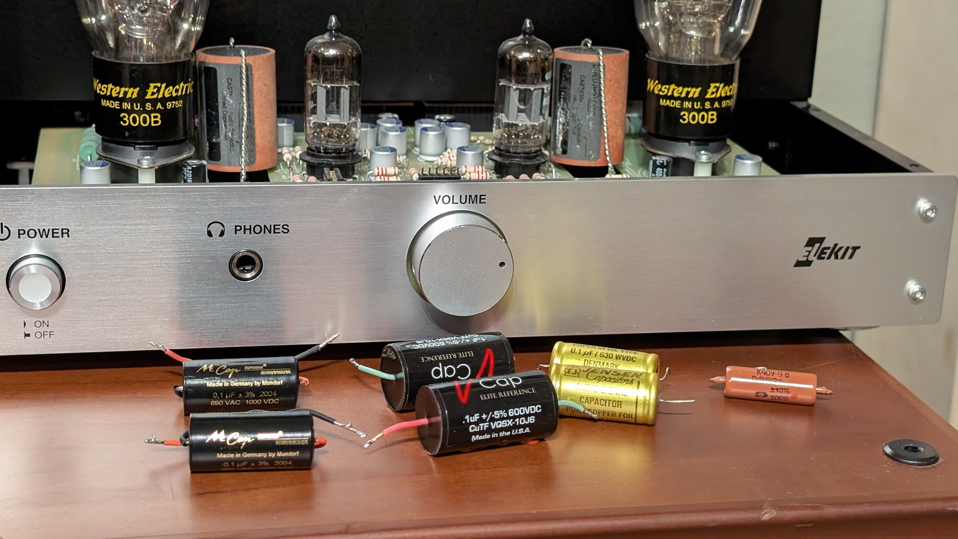

Now I hopefully have done allmost all soldering. Waiting for the upgraded TDK pot and trying to decide if I should upgrade CuTF to V-cap or Audio Note Silver. Both where recommended by Victor (and boy what a super quick reply!) Is there anyone who have tried both and what is the difference? I might wait and save up some money for the AN if there is a significant improvement vs V-vap. Anyway Inprepared by soldering the original high enough to easily be cut away. Thanks for that idea forum member!

I have tried a couple of caps there and ended up with Duelund Cu/Sn instead of VCap. But old age means that I don't remember exactly the reason. Should've written these things down... Anyway, I do have a few interesting ones, as well as a Jupiter Copper 0.1uF and AN Copper 0.1uF installed in other amps/dacs that can be borrowed. But unfortunately don't have any AN Silver. If someone sends me a pair of AN Silver I can do a big comparison. 😉 That'd be fun!
I will not recommend to install the cap same as this photo. It is not safe.
The about photo has a 1997 version of 300B... I suggest you to use a current production WE300B to test with VCAP CuTF.
I only recommend VCAP CuTF or Audio Nore Silver for TU-8900. The version reviewed by Herb is based on AN silver caps and 46 pcs of AN Resistors.

1997 production is the worse version and very short life in production.

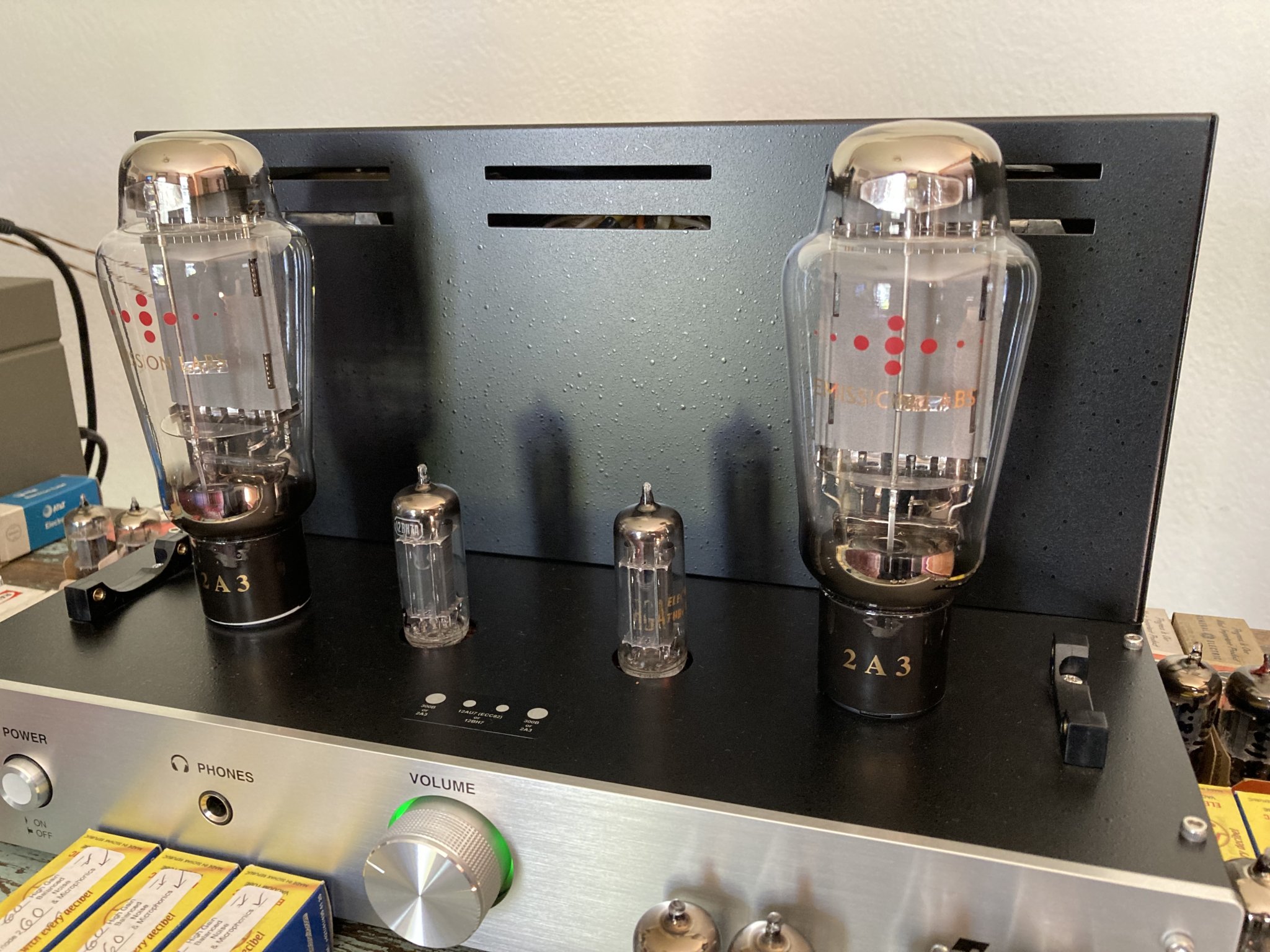

I think you would be hard pressed to find an audible difference between most 2A3 tubes, but the 5 year warranty on those EmissionLabs are tempting. I'm currently using the LInlai Global Elite 2A3 and they are quite nice. Much more accurate and natural than the Cossor 300B I tried.Nobody tried those?
I’m really happy with the Cossor 2a3 but I’m thinking about selling the Cossor 300B to get the EmissionLab 2a3. Even if the 300b looks so so nice 😆. I really prefer the 2a3!
I suspect Victor meant to say the way the caps are installed is not safe. Pretty sure I concur with that.I will not recommend to install the cap same as this photo. It is not safe.

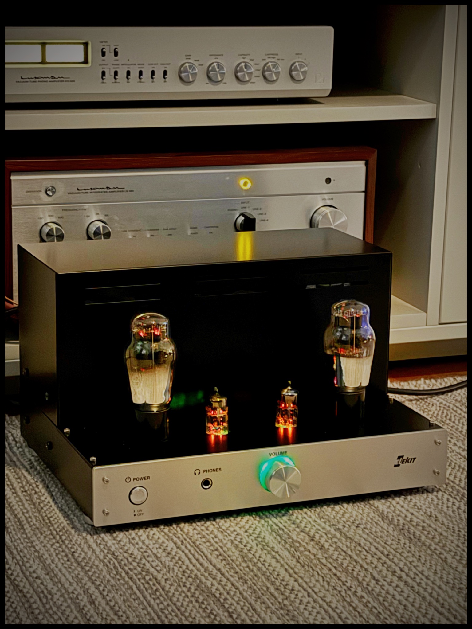

First test of my just built Elekit 8900. Initial relief that everything works as expected is soon replaced by a strong astonishment over its sound! It’s incredible. My Luxman LX380 is used as a preamp with the Elekit. The music is transparent (audio lingo that previously sounded, well, mostly like talk…). Bas is much stronger so I had to adjust my Avantgarde by lowering the bas. After changing bas level it’s quick and airy with a firm bas. Lundahl transformers, vintage RTF ECC82, NOS Sylvania spring top 2A3 from 1945.
Amp was set up with feedback and after a quick listening session I think I’ll leave there to start wjtj

I think someone mentioned EML mesh plate 2a3. I am using the standard solid plate 2a3. They work well and have a powerful sound. I really like the EML tubes. Their 300b is also great.
Very nice. I share your feelings about the EML tubes. I'm currently running a pair of EML mesh-plate globes in my Sunvalley SV-S1645D amp and also have a pair of EML solid plate 45s for the Sunvalley.
EML 300Bs in the Ele-kit are extremely nice and I do like mine, though my personal preference by a small bit is for new production Western Electric 300Bs. Either one is a great choice and likely comes down to speakers or headphones being used at the moment. I haven't tried the EML 2A3s yet but now you have me curious!
