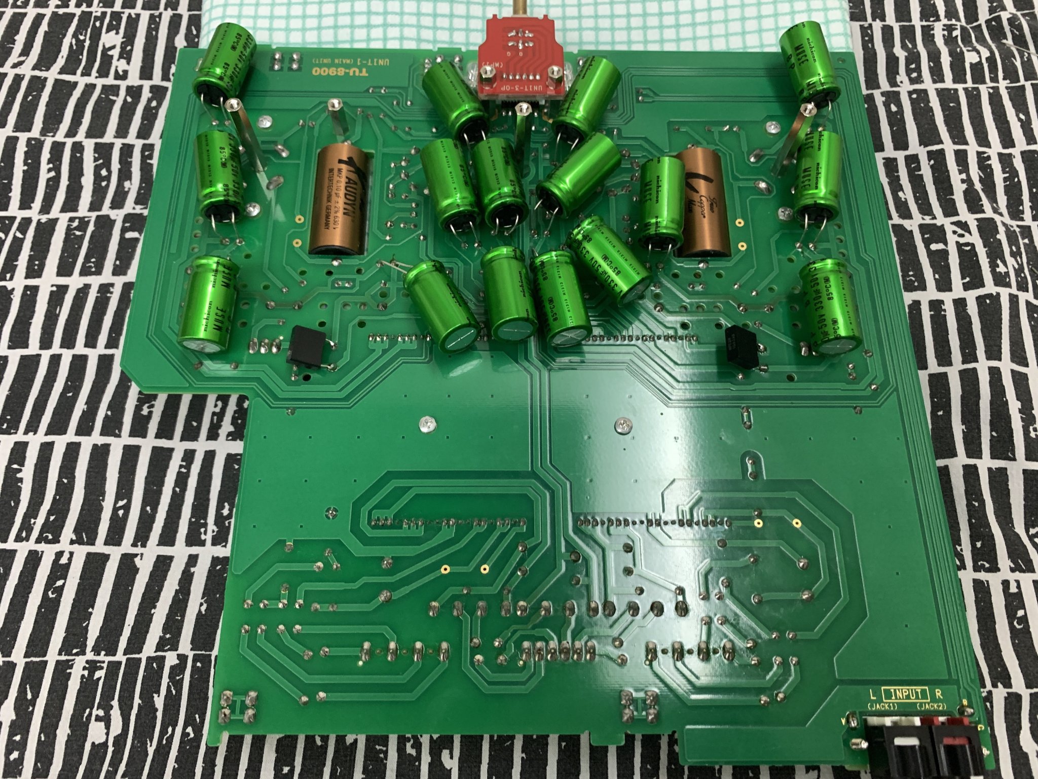

You could ditch the stock potentiometer and use an external Autoformer Volume Control, which brings about a nice improvement, although this would be an expensive route. Supposedly, the Alps RK50 (again expensive and also huge) is a nice improvement over the affordable pots.
Some of the cost effective mods are;
- You could replace the stock resistors with better resistors. Even the Amtrans AMRG was an upgrade
You could replace the jumper resistors with good copper or good silver wires
- Bypassing the power supply caps C112 and C212 with film caps also resulted in a slight improvement
Do the following mod at your own risk:
On the affordable side, the biggest improvement for me and my friends came about, when we replaced those cathode bypass caps. The stock ones are polymer aluminum caps from Kemet. We replaced those with electrolytics. I went with Nichicon ES in all positions. Whereas, my friend went with a mix of ES and KZ, which is probably what I’d do if I had to do it again. The only issue with this mod is, these caps are quite a bit larger than the stock caps. So these have to be mounted on the underside of the PCB and they cover up most of the PCB. So if you want to do any mods or soldering in the future, it becomes almost impossible, unless you remove those caps and reinstall them.
A more safer route would be to replace those Kemets with Panasonic OS-CONs, which are still polymer anluminum and low ESR caps, just like the stock Kemets. However, these Panasonic OS-CONs have a reputation for sounding good among the polymer aluminum category, so might be worth checking out.
This is what it looks like. The orientation of the caps are not random. Due to space constraints and lead lengths, I had to simulate and I arrived at this. In the pic, you can also see the power supply cap bypassed with a film cap.

I am wondering what’s wrong with Kemet polymer caps? They are long lasting and very low ESR and I have been using them in other projects as well with very good result. Its small size makes it easy to use.
I don't think there is anything wrong with the polymer caps. They are very reliable and long lasting. That said I think it would be an interesting experiment to swap out those caps but ultimately (me personally) I'd probably just prefer to save my money/ time and buy more and different coupling caps. I've been running some cheap Amtrans caps since I built mine and will be upgrading to Jupiter copper caps this week hopefully.

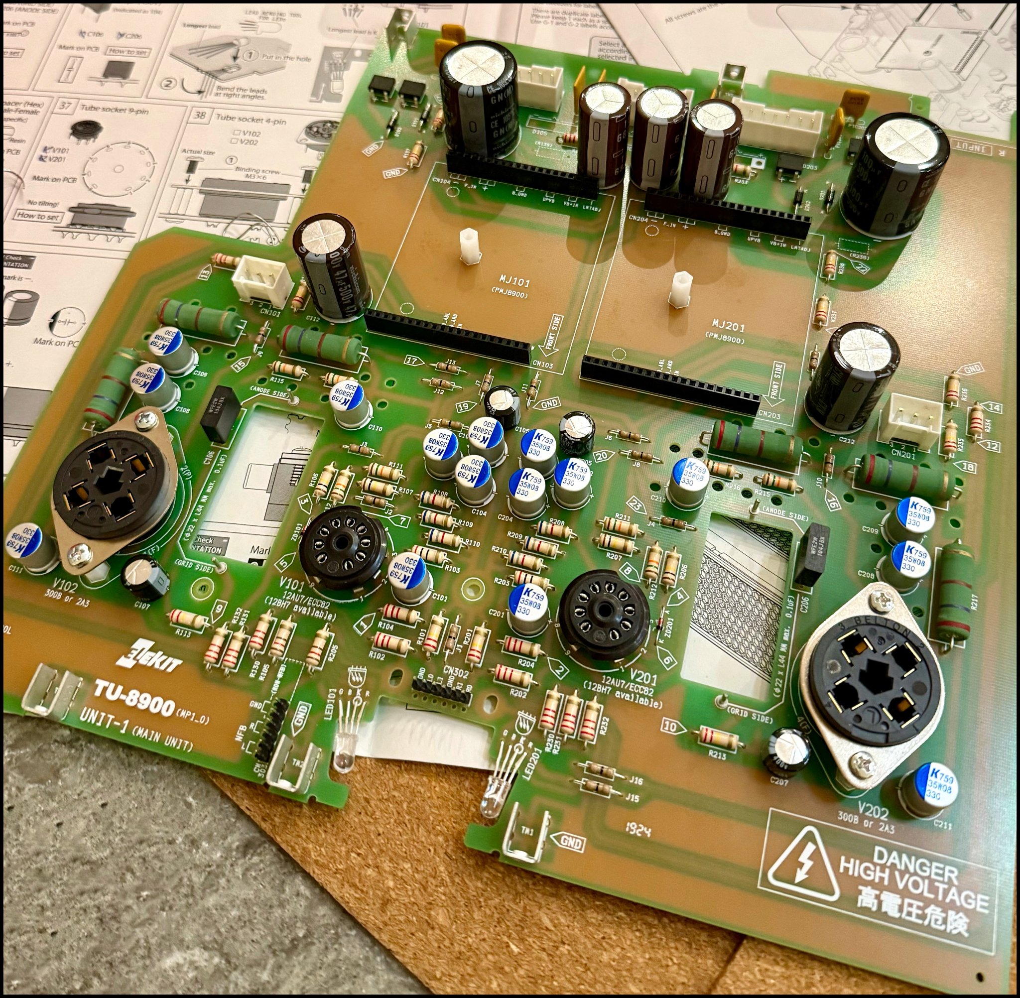

Now I hopefully have done allmost all soldering. Waiting for the upgraded TDK pot and trying to decide if I should upgrade CuTF to V-cap or Audio Note Silver. Both where recommended by Victor (and boy what a super quick reply!) Is there anyone who have tried both and what is the difference? I might wait and save up some money for the AN if there is a significant improvement vs V-vap. Anyway Inprepared by soldering the original high enough to easily be cut away. Thanks for that idea forum member!
Victor: what’s your thoughts about this? I thought I might ask here instead of by mail since I expect interest from several builders.

Both coupling caps are excellent choice.
It is more about your budget. Stereophile classified TU-8900 as Class A components is based on AN silver caps and Tantalum resistors in signal path upgrade.
I offer ALPS R27 volume pot as the standard of TU-8900. I stopped to use TKD in TU-8900.
