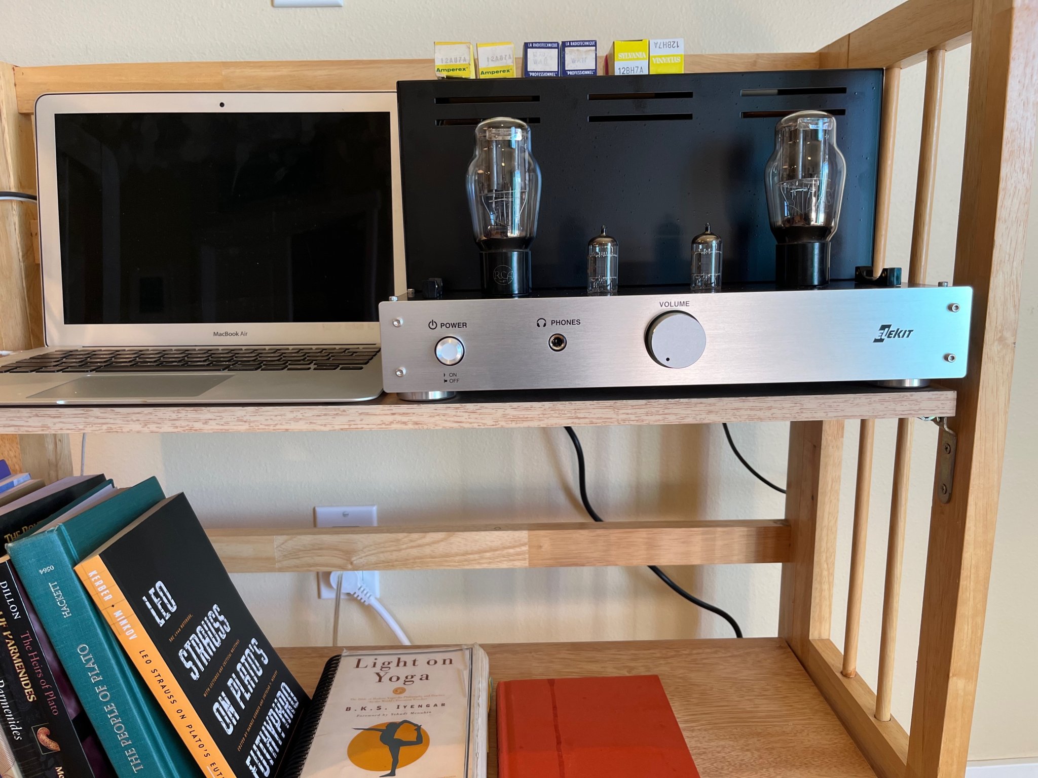

Just completed the Tu-8550 pre-amp with 4X Mundorf supremes. It’s a great companion to the tu-8900 . It neither enhances nor detracts from the tu-8900 sound. This is the best sounding Elekit combo I've heard thus far. Amazing sound!
I built this the first week on an extended time away from home without brining any audio equipment, only half of my soldering tools. Built stock, but intend to upgrade to CuTF caps in a few days. Original caps were installed high enough to allow easy cutting of leads.

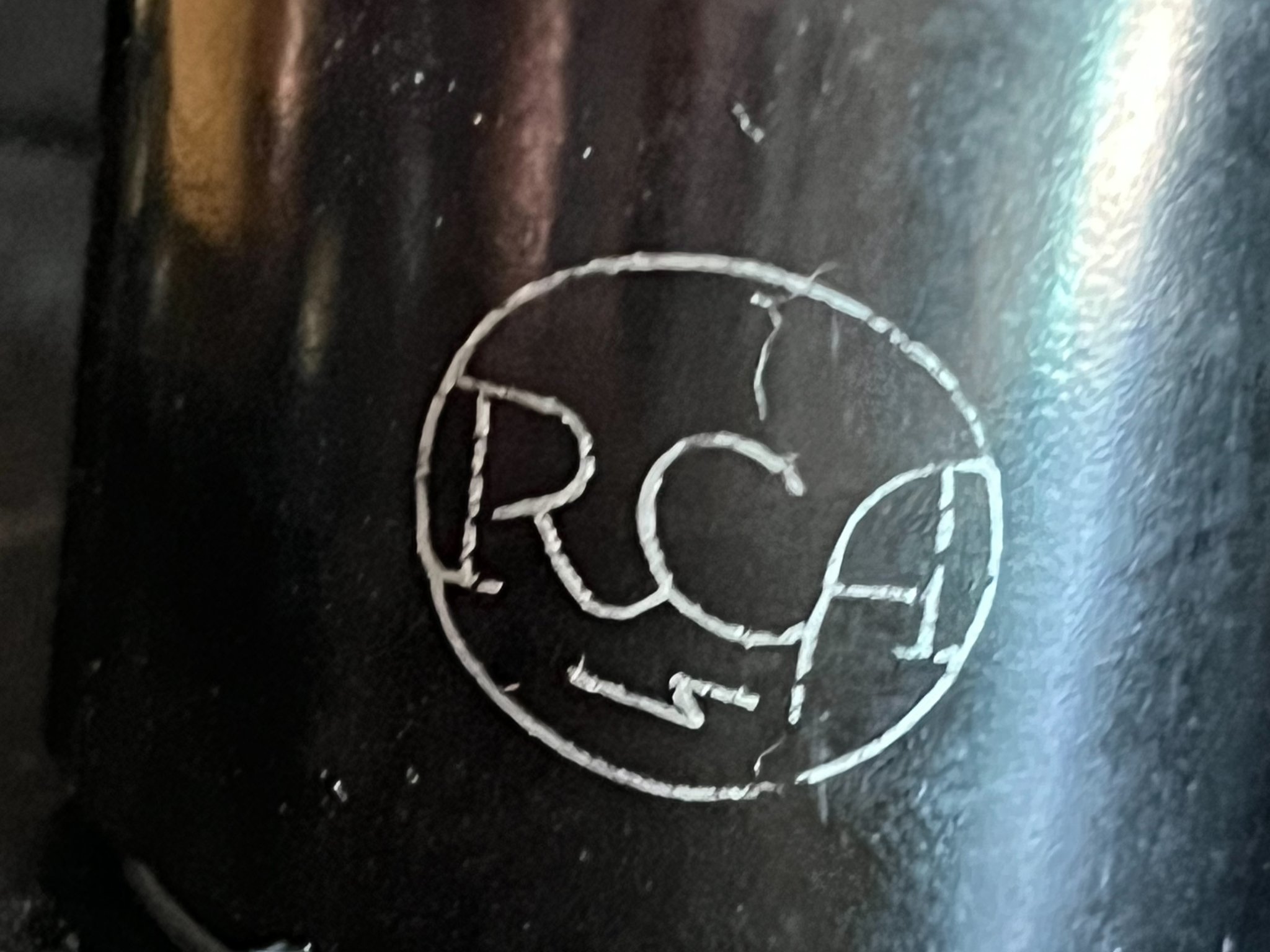

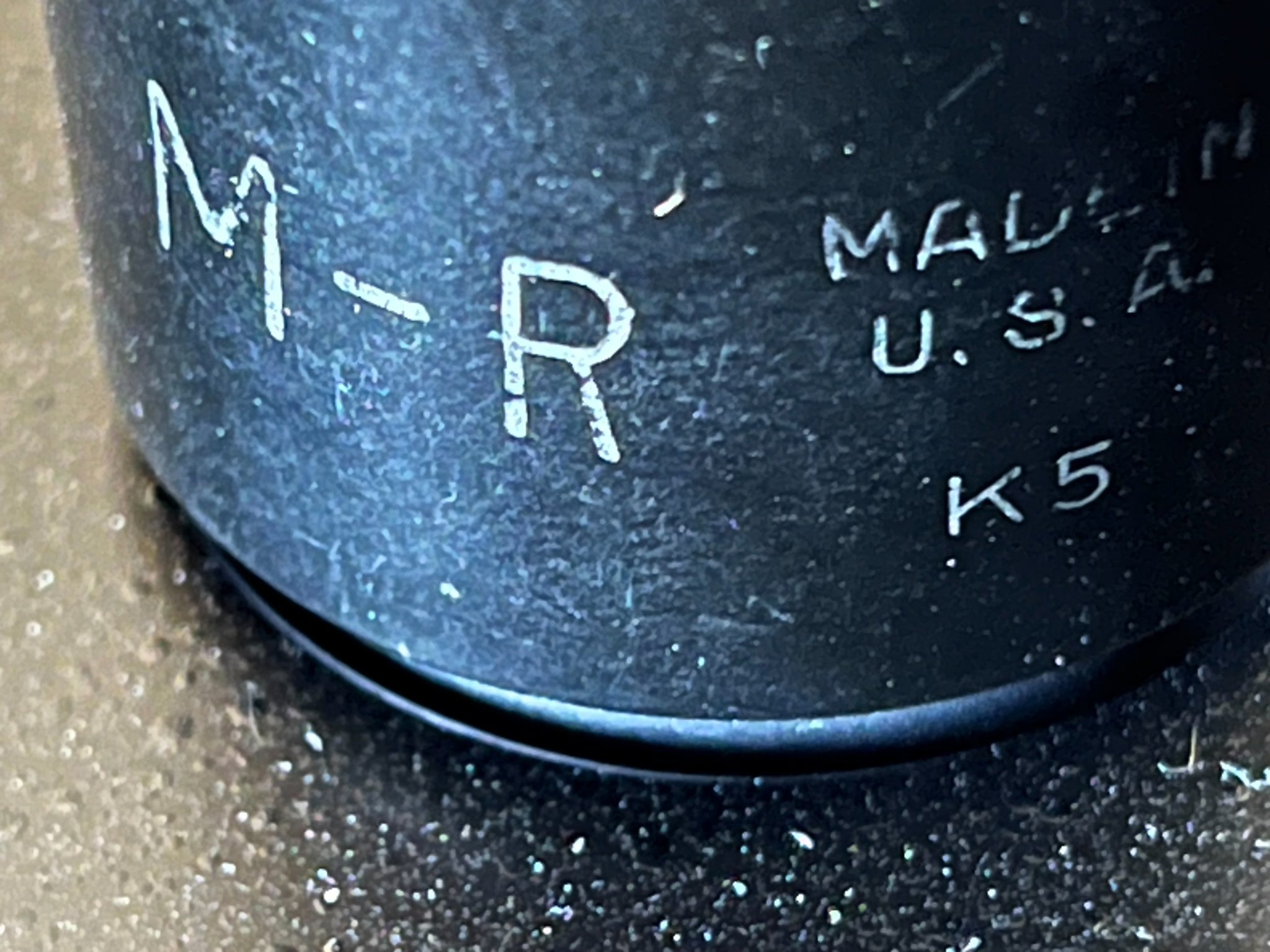

I inherited about 1,000 tubes in 2020. The RCA pair of 2A3's are what caught my eye. I paid to have them tested and they tested as "new" (see last photo and question, one of hundreds of my uncle's projects - same pair?... will never know other than the had more than one of those chassis in his crawl space)
If anyone can interpret the code of this base for date I would appreciate it. I've found that is was 1943 production by some being sold but research is inconclusive. I always thought they were grey plate, but seller with same code had black plate listed. In the right light I would call them black, but doubt it.
Really enjoying the sound. Way more volume than I can get away with living in a condo... maybe not right now, it's happy hour and have it at 2:30.
Using without NFB.

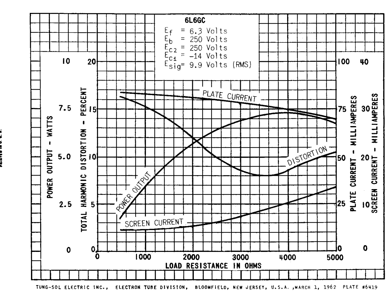

I don't know whether this is the right plot to look at, but assuming it is, the power output would go down a little bit for the same grid modulation.
Datasheet for 6l6GC at https://frank.pocnet.net/sheets/127/6/6L6GC.pdf .
I just noticed the Hashimoto table shows two primary impedance options (taps/windings, I assume) for this transformer, one with 2.5kOhm and the other with 3.5kOhm. So, just pick the 3.5kOhm one.
Edit: Oops, just realizing I confused the 8900 and the 8200. The plot above is for 6L6GC tubes, as in the 8200.
I think you answered your own question with the graph you posted. You could get more power safely through a transformer with lower load resistance and higher current capability, but power out is also dependent on your output tube plate characteristics and its safe power dissipation rating.

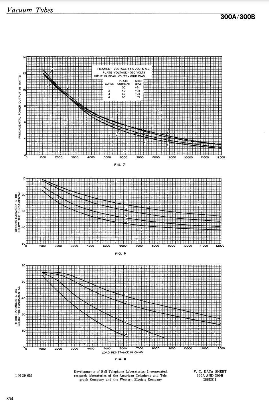

It's too late to edit my 6L6GC post above, but here is the datasheet link for the 300B from the Western Electric website: https://static1.squarespace.com/sta...45504889f6da688b7c8ecd/1598378059729/300B.pdf
From the last page it looks like as you vary the load from 2.5kOhm to 3.5kOhm you reduce power and distortions, but there doesn't seem to be anything drastic happening. There is no distortion minimum, like for the 6L6GC near 3.6kOhm.
