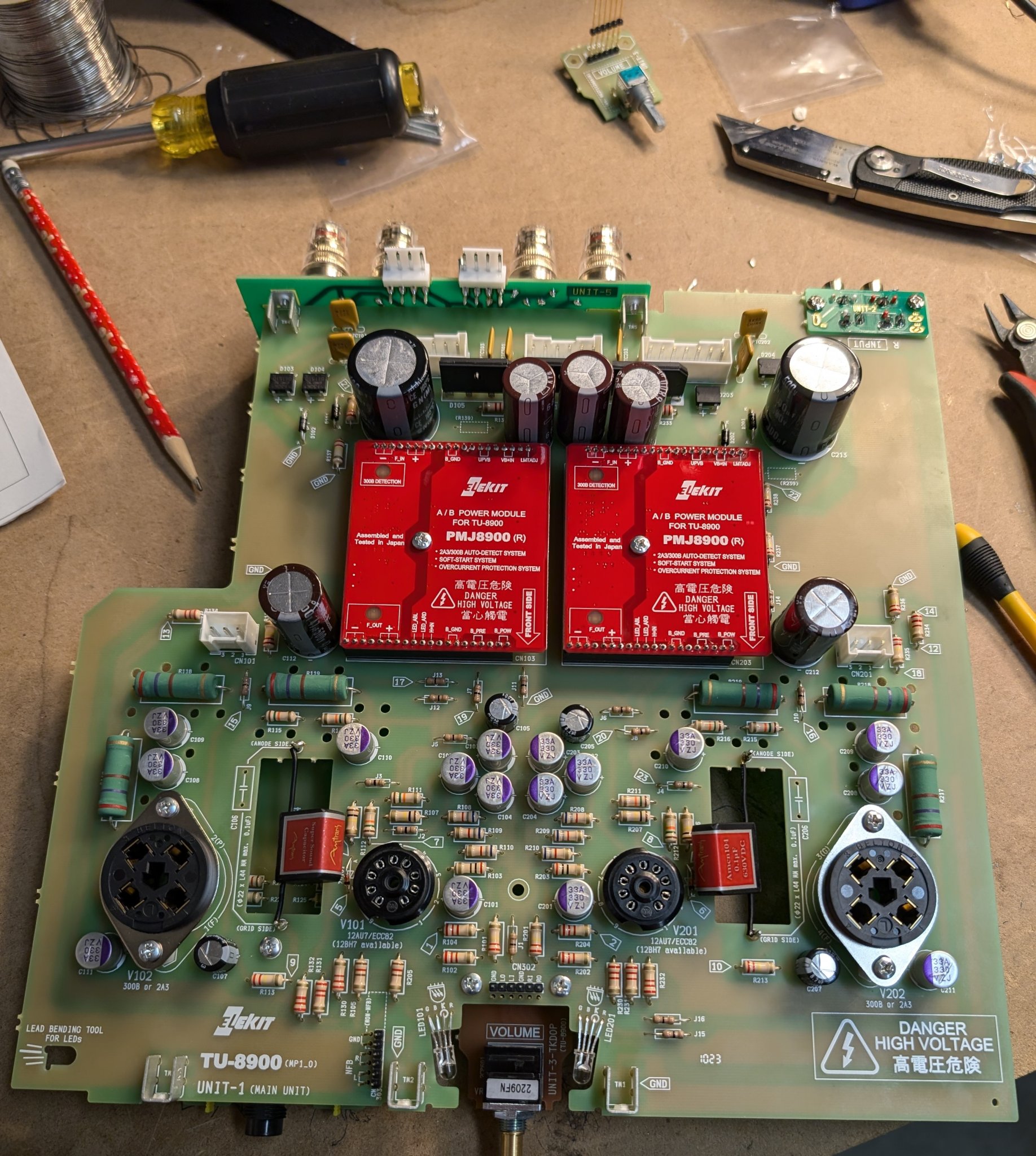

Can anyone speak to how the auto-detection between the 300b and 2A3 works?

Great thanks! I was trying to wrap my head around how that was being accomplished in the case where you have a 300B with a 2.5v filament like the EML mesh plates 300B.
That's too bad. I know it can't be posted here but is the schematic detailed enough to show the internal workings of the detection module or does it show up as a block diagram?
Definitely not a deal breaker but those EML mesh plates sure are nice tubes.
Block diagram. The two modules are pre-assembled in Japan.

After some help from Victor, diagnosing a non-playing channel, I had a working amplifier Wednesday. Assembly was straightforward enough; I just missed a solder bridge on the headphone board.

Finished the PCB assembly today after slowly working through it this week. Spent about two hours finishing it today.
Very relaxing and meditative process for me. These kits are so well thought out and designed.
Hopefully will finish tomorrow and can give it a listen.
Nothing gets by Victor!You are missing to solder D,E,F of Unit #2.
