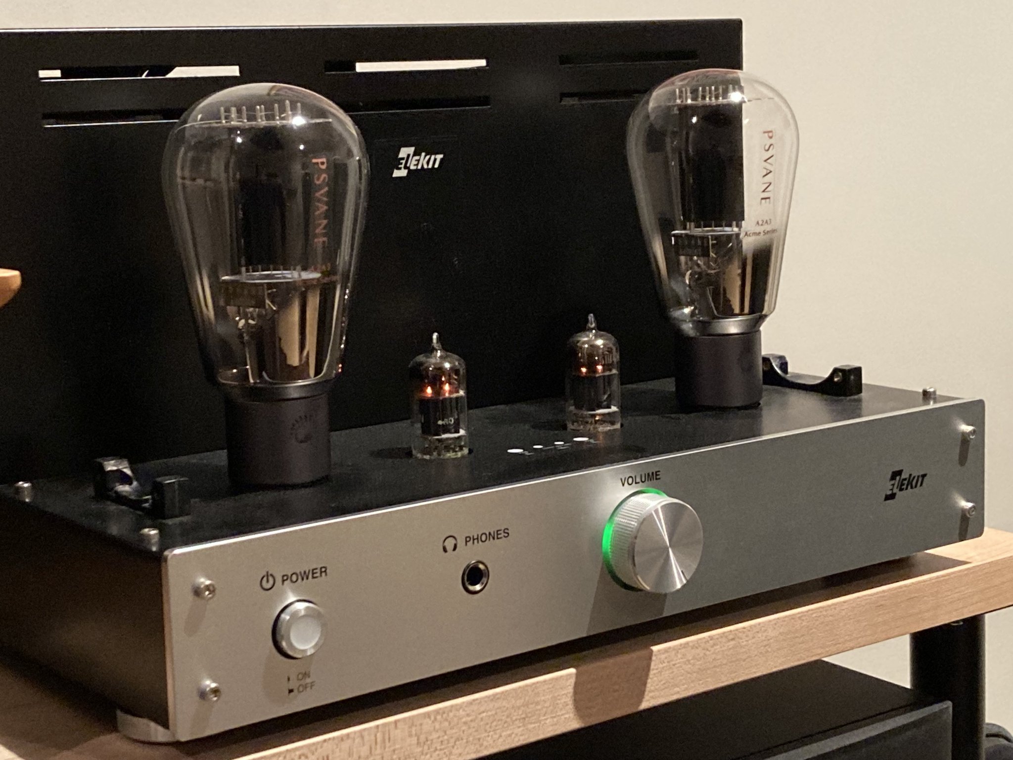

I’ve had my 8900 for 3 months now and am loving it. After running Gold Lion 300Bs for most of that, I bought some Psvane Acme 2A3 a couple of weeks ago and loving the sound even more. I can’t bring myself to swap the 300Bs back in yet for a proper comparison.
So subbing 12BH7 in for ECC82 is not a problem for TU8900? How about TU8600?I installed a pair of NOS Telefunken ECC82 smooth plates in place of the Sylvania 12BH7s

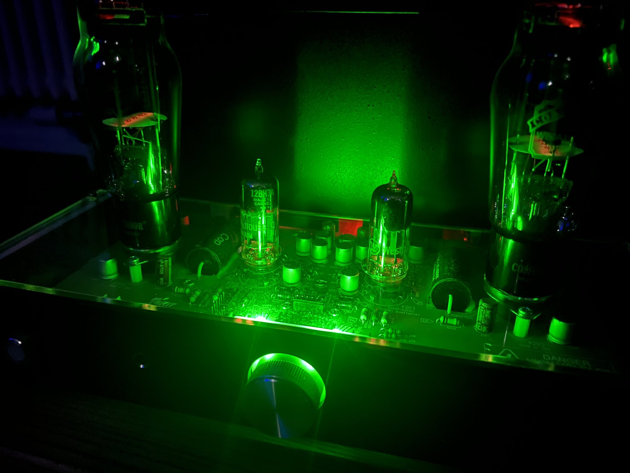

Some of my daughter’s washi tape 😊Very cool! I like that look.
What did you use? Is that a tape of some sort?

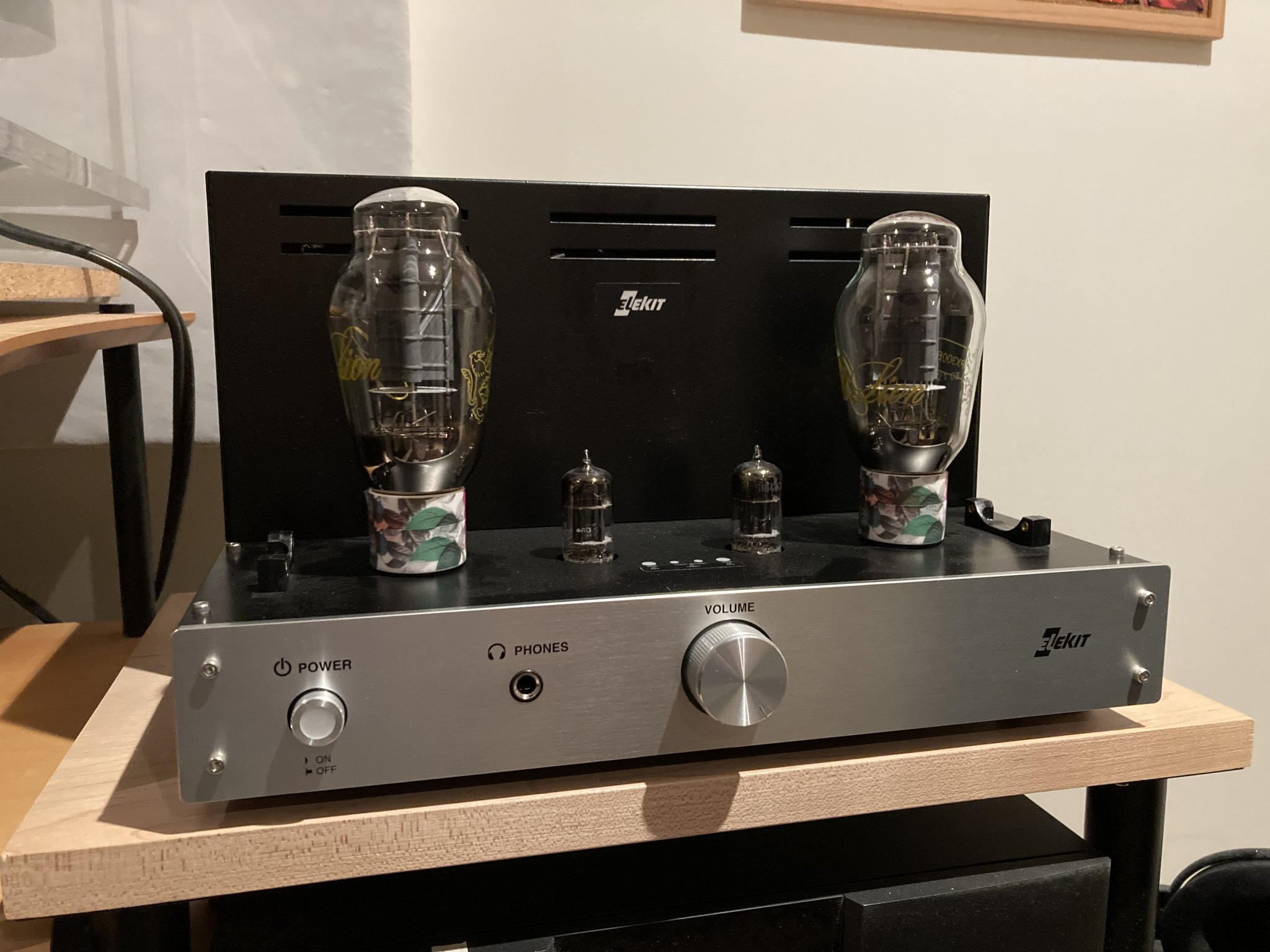

Small update on tubes. I own both 300b and 2a3 and have to say, after months of listening to both that I prefer the 2a3.
They only lack a bit with basses, the 300b do just a slightly better job at it but you lose on ‘intimacy?’ (something difficult to explain). The 2a3 are more velvety if I can say that. Love that.
Btw, currently running my 8900 with Westinghouse 12bh7 tubes which are my preference so far (tried Sylvania (nice!), RCA (didn’t like them), GE (not bad))
edit: added a picture and thanks Victor for the transparent plate, didn’t want it first but it is really nice 🤩
