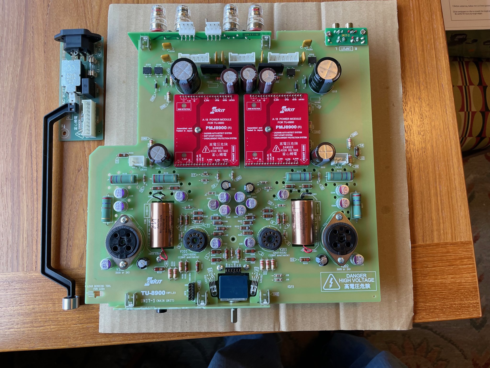

While spring is happening and outside chores still have to get done, I'm managing to find some time to progress with my TU-8900 build. Today I finished up the last of the resistor soldering on the main board, so now the caps and hardware will be next. The Ele-kit is starting to look like an amplifier!□ 3.3Ω(ORN‐ORN‐GLD‐GLD) 2pcs Takman 2 R129 /R229
□ 8.2Ω(GRY‐RED‐GLD‐GLD) 2pcs Takman 2 R128/ 228
□ 20Ω(RED‐BLK‐BLK‐GLD) 4pcs 4 R103, R127 R203, R227
□ 47Ω(YEL‐VIO‐BLK‐GLD) 2pcs 2 R126 R226
□ 120Ω(BRN‐RED‐BRN‐GLD) 1 2pcs 12 R105, R120, R121, R122, R124, R125 R205, R220, R221, R222,R224,R225
□ 2.2kΩ(RED‐RED‐RED‐GLD) 6pcs 6 R102 R104, R134 R202, R204,R234
□ 6.8kΩ(BLU‐GRY‐RED‐GLD)* 6pcs 6 R110, R109, R108 R210,R209,R208
□ 15kΩ(BRN‐GRN‐ORN‐GLD) 8pcs 8 R112, R111, R116, R115 R212, R211, R216, R215
□ 100kΩ(BRN‐BLK‐YEL‐GLD) 4pcs 4 R107, R106 R207, R206
□ 220kΩ(RED‐RED‐YEL‐GLD) 4pcs 4 R101, R113 R201, R213
Steve Z
A little more work, just transformers and mechanical stuff (getting the board in the box, etc) and I'll be complete:
