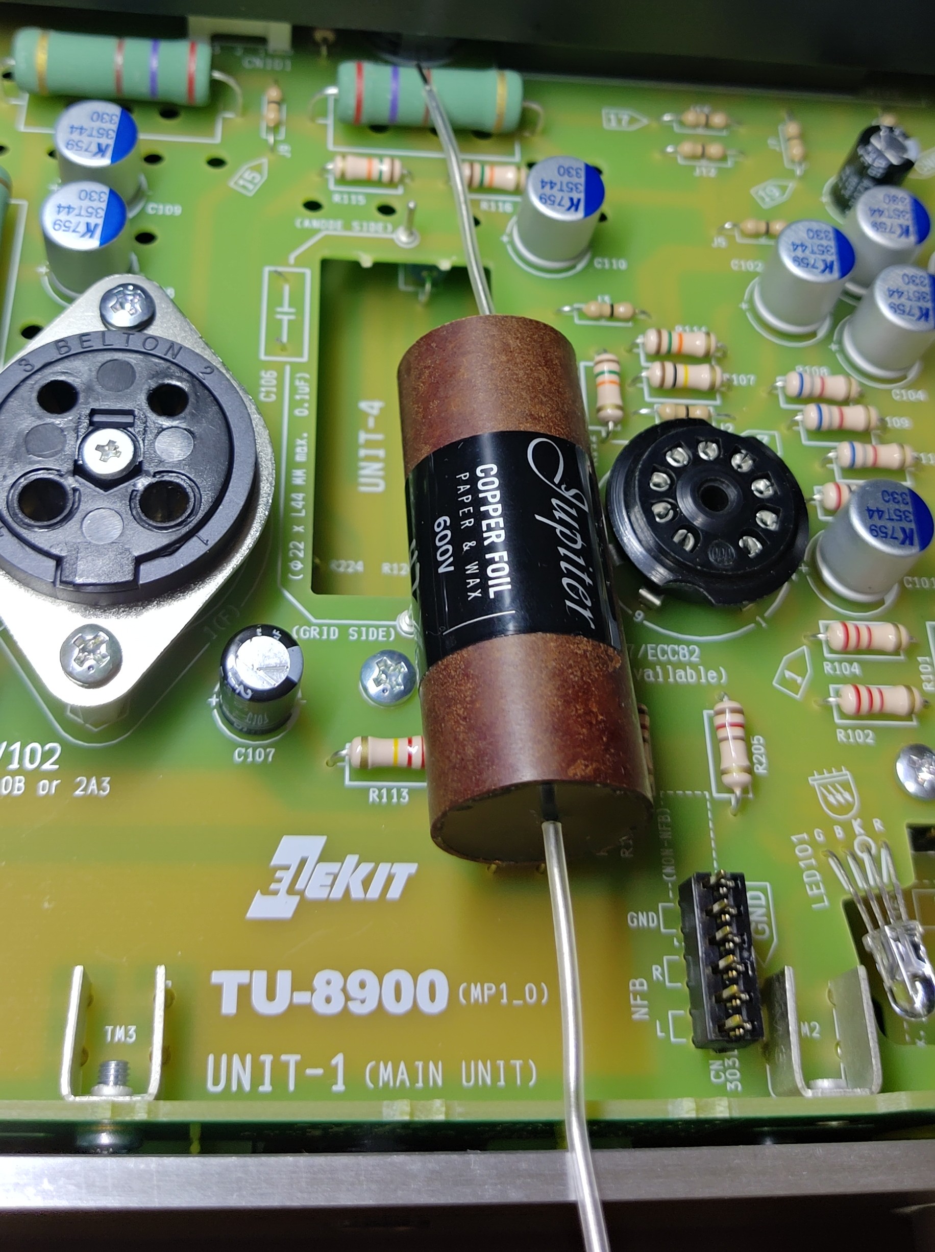

With the help of Peter from Audio Note, I will offer Audio Note Copper, Silver couping caps, and resistors fror TU-8900.
Bought this TU-8900.
Very easy to build, spend like 6-8hours (slow mode).
Plug 2A3 and 300B, both working nicely.
Worth every penny... Even with standard kit, sound very nice...
Thanks.
Thanks.
you just remove the pin and install the cap directly into the pcb
https://flic.kr/p/2mMp9b4
It works well with Audio Note Copper and Silver 0.1 600V, VCAP CuTF 0.1 and ODAM
