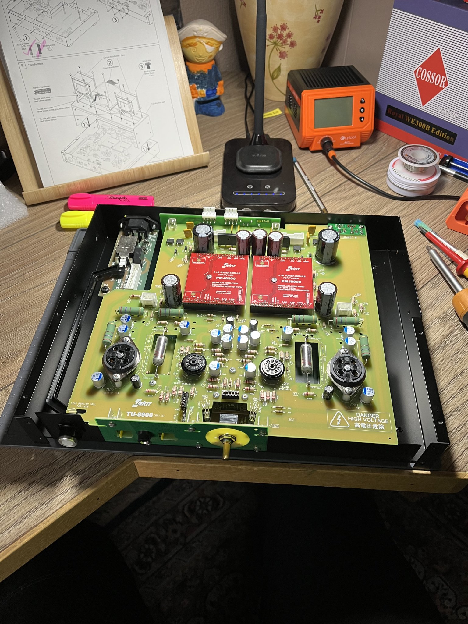

Hi, I finished building my 8900 last week and wow it really is good, it’s had about 10 hours use and it seems to be getting better every time I switch it on.
Unfortunately I have just switched it on and the fuse has blown so I took the cover off checked the connections and replaced the fuse , switched it back on and the fuse blew agai, so annoying as it’s been perfect.
Any ideas what it could be and where to start looking.
All help will be much appreciated
Thanks Scott.
I have a pair of cosser we300b that I bought from you last week, a pair of rca 12bh7a and a pair of rca cleartop 12au7a.
the first fuse blew with the 12bh7a so I changed to 12au7a and it blew again.
I do have some more 12au7a that I have in my dac but I will have to wait until tomorrow to try as I have some more fuses coming tomorrow.
