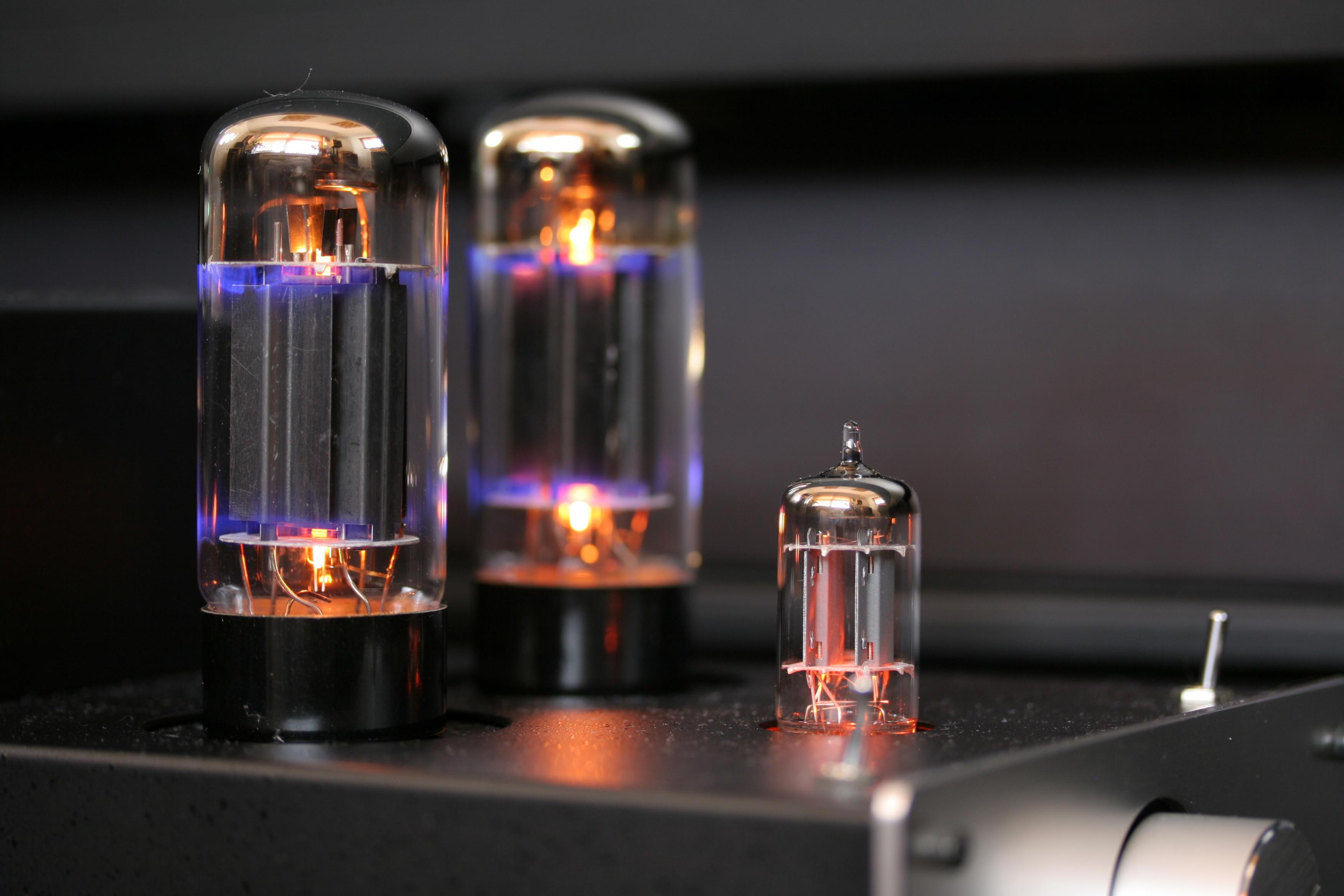

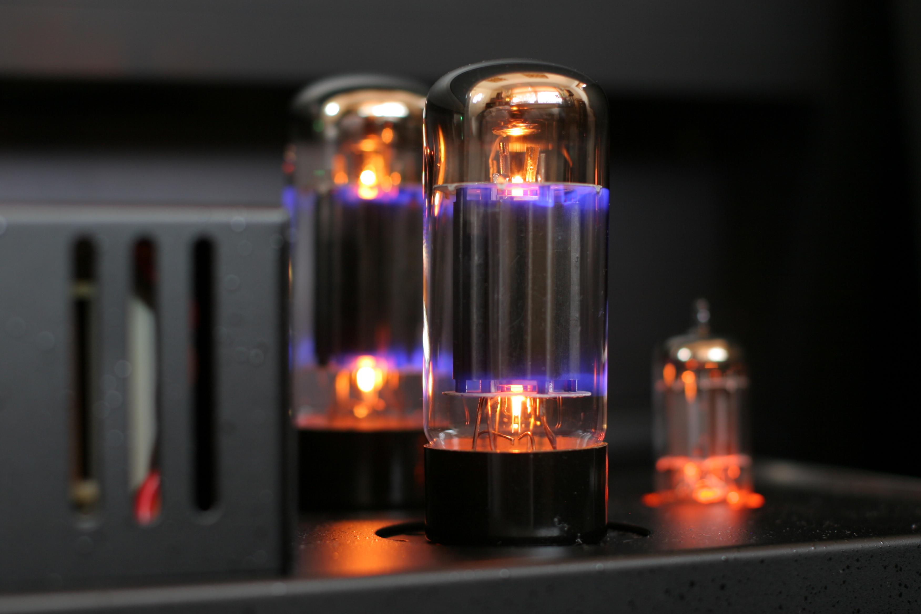

I finished my build a week ago and now have a few hours play time on it. The stock tubes sounded real nice but I couldn't resist trying something a little different. I run across a few Telefunken smooth and ribbed long plate 12AX7s and settled on the smooth plate. The 6l6 blackplates are US made Groove Tubes and actually sounded pretty good so I decided to keep them in for awhile. Lovely blue glow coming off those tubes. Thinking of changing the orange LEDs on the driver tube to blue ones.

Here's mine;
I switched the amber LED's to blue.
Driving a pair of Tang Band W8-1772 in DIY vented boxes.
Tryed KT-88, but ran too hot. Went back to stock EH. Then tried Sovtec 12AX7LPS and that sounded good. Nice and smooth. The last roll I did was Genalex Gold Lion 12AX7 (long plate) and the new Tung Sol 7581.
I am staying with this. The 7581 is a true pentode with nice curves. The sound is smooth, detailed and punchy. The gold lion sounds a hair better than the Sovtec, but that could just be me trying to justify the extra $30 - 🙂
