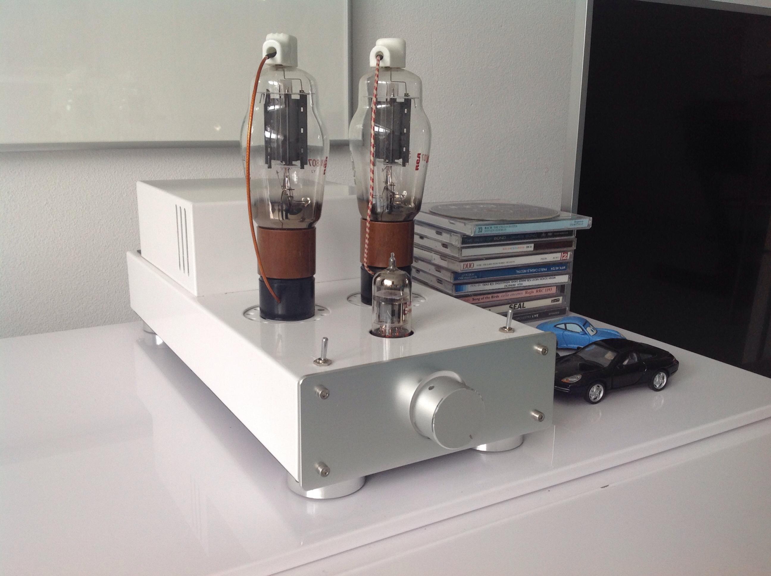

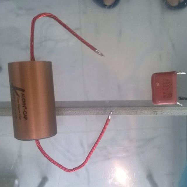

Although everyone seems busy with the successor of this little amp, I tought I'd share my latest upgrade. While thinking about a nice coupling-C, I ended up using the Intertechnik Audyn True Copper. Just two of these, leaving out the first pair of coupling caps (c1 & c2).
The difference is simply amazing! So much more detail and space. Now I know that the old plastic caps really sound plastic... Highly recommended!
Next will be the power cap. And I know that the Mundorf is the save way, but I'm thinking of the Audionote Standard capacitor. Might even fit under the pcb...

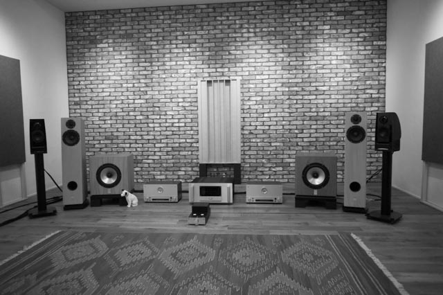

i recently had the opportunity to test my build in a audiophiles sound room, comparing it to a pair of marantz 2's the 879 held it own (within limitations 8 watts vs 34) and a few other things)) witnessed by Stig & Jon the "Lyra Guys" of course passing it through a vintage Lyra Connoisseur 4-2L SE pre amp and phono stage was not wasted. lets put it this way i was not embarrassed, even a little impressed it held up so well.

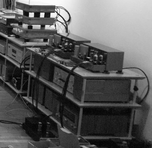

see pix little beast on the floor next the marantz 2 (with Phillips el34's xf1's and without tubes infront of the speakers.

Yesterday finally the second converter arrived. But they have sent me one lokking different from the first one...🙁
At least it works...😀 Bit smoother already than the stock tubes. And quite heavier on mid bass. Which is good, as this amp is used for a 8" fr to play from 150hz up. The bass is taken care for by two OB Eminence Alpha's 15". The transition from woofers to FR is a lot better now!

"Btw Viktor, people are asking me if the transformers are up to the task with the 807's. Wouldn't it run too hot?"
I have not encountered any issue to use RCA 807 with TU-879S.
