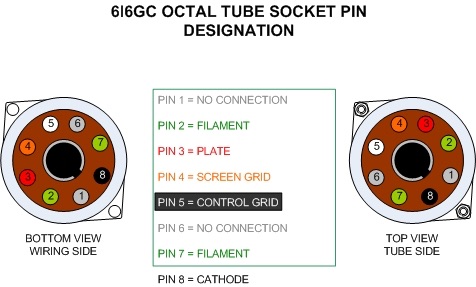

By 'resistors that are used to span some traces', I guess you mean the jumpers j2 and j3?
And for the value for the resistor to connect pin 4 and pin 3, 100 ohm would do?

Yes, looking back at my notes, they were jumpers. I installed resistors in their places.
Yes, 100 ohm should do. Double check my memory on the pin outs - I think 3 is anode and 4 is screen grid, but double check it.
