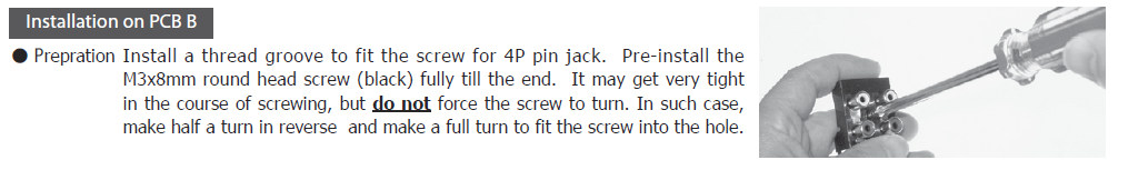

How do I get this unscrewed?
Attaching a pic of my current dilemma. I put this project on the back bench 3 months back when I realized I would never get the screw to properly insert into the RCA block without undue force. Vicktor told me to use "the right amount of pressure", but I was skeptical from the start as I knew the screw was already losing its groove while threading it in. Actually I was quiet fearful this would happen, so waited a few months for a brainwave to strike me about whether to use the m3x8mm screw or another size (then forgot about it for a few months).
So I went ahead yesterday deciding to complete it, now I am stuck with the results you see in the pic. Alas ...its totally jammed, the grooves are now worn out, and the Philips screw driver is of no use. the needle nose pliers is of no help. How do I get this unscrewed?
I need to attach this to the back plate of the chassis to complete the assembly, which means unscrewing it and screwing it back via the through hole of the chassis.

Ok, my friend reminded me that I have a dremel lying unused in my cupboard - one of those expensive fancy toys I dont know how to use really 😱
Cutting a groove into the screw head for use with a regular flat blade screw driver however was easier and quicker than it takes to read a page on the internet.
I removed it!! 😀 Now I will finish the project in a couple of hours.

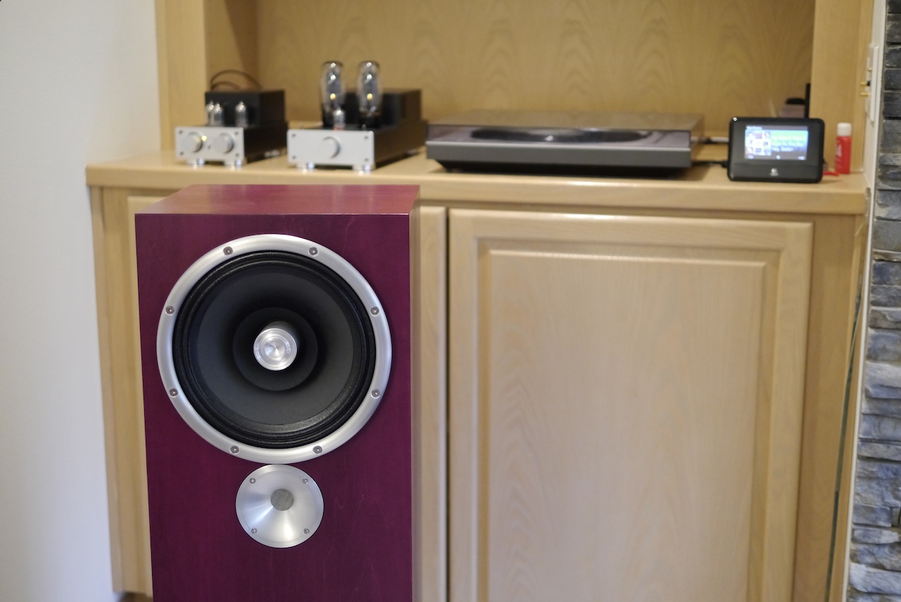

Hi Everyone! I just thought I'd share a couple of photos of my Elekit setup. I initially built the TU-879 amplifier and was thrilled with it. Victor later sold me some Vitamin Q caps and an upgraded potentiometer for it. This amp is well broken in by now as it gets around 5 hours a day of play time.
Since the TU-879 was so easy and so much fun to build with such a great sound, I decided to order a TU-875 preamp as well. At first, I intended to use this with a different system, since it never really occurred to me to place a preamp in front of an integrated amp like the TU-879. I had always thought it best to keep the signal path as simple as possible.
But the addition of the turntable to the system necessitated a phono preamp and I wanted to spend some time listening to the TU-875's onboard phono pre, so I put it in the chain ahead of the TU-879 amplifier. I was very surprised to find that I much preferred the sound of the TU-875/TU-879 combination to the sound of the TU-879 by itself. We just love it. This system produces a detailed sound that somehow does not fatigue you. With the Zu Omen speakers, the 9 watt TU-879 offers more than enough power.
If you have thought about building a TU-879 amp, don't hesitate. It has to be one of the greatest hi fi bargains out there right now, and you also get the pride of having built it yourself. And if you're game, adding the TU-875 preamp gives you a very good phono stage and also, to my ears, a rich and detailed presentation.
I spent quite a lot of time rolling tubes on the TU-879 and finally arrived at my favorites: Current production Tung Sol 6L6G and Tung Sol 12AX7. I am still using the stock Electro Harmonix 12AU7s in the preamp, but they seem to be quite good. I may try some Tung Sols in there as well.
