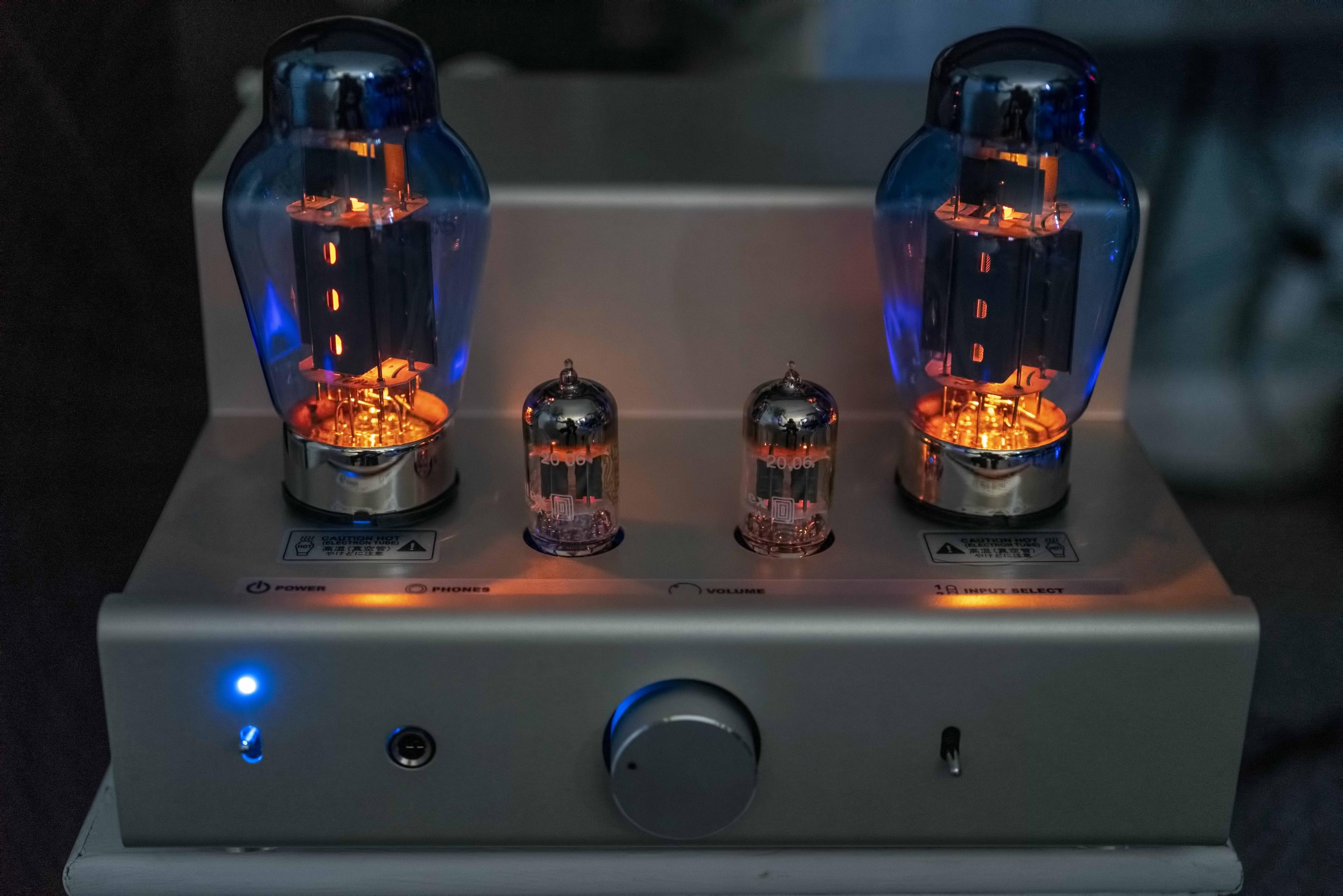

Hello All,
I finally finished building my TU-8200R kit with no issues and it sounded really good to my ears even with only few hours burn in with the stock JJ's tubes this amp have no problem driving a cheap bookshelf Pioneer SP-BS21-LR 6 ohms 87db sensitivity speakers. Next is to upgrade the coupling caps and will try different power tubes like KT88-ST is there anyone out here know about this brand Sophia Electric I read good thing about there tubes on some other websites. See linky Sophia Electric Coke-bottle KT88-ST Tubes (long life version). Any advice on other power tubes that is good for this kit? Your comments is greatly appreciated.
When I'm listening for 15 mins the enclosure gets a little bit hot around the tubes. I measured it with Laser Infrared Thermometer Temperature Gun and the temp register closed to 160F. I'm concerned that the components inside like the FET transistors will be able to handle this heat and is this normal? and also is this will have changes in sound when its get this hot? Your comments is greatly appreciated.
I checked the voltage on A1266 11,12 (1.13v) within ref. specs and 13,14 (-25v) 1 volt higher. On 23,24 (284v) 4 volts higher than the reference voltage. the rest of reference voltage are all in specs per manual. However I swapped JJ's 6L6GC to KT88's power tubes I'm not sure if thats the cause of my heat issue around the enclosure.

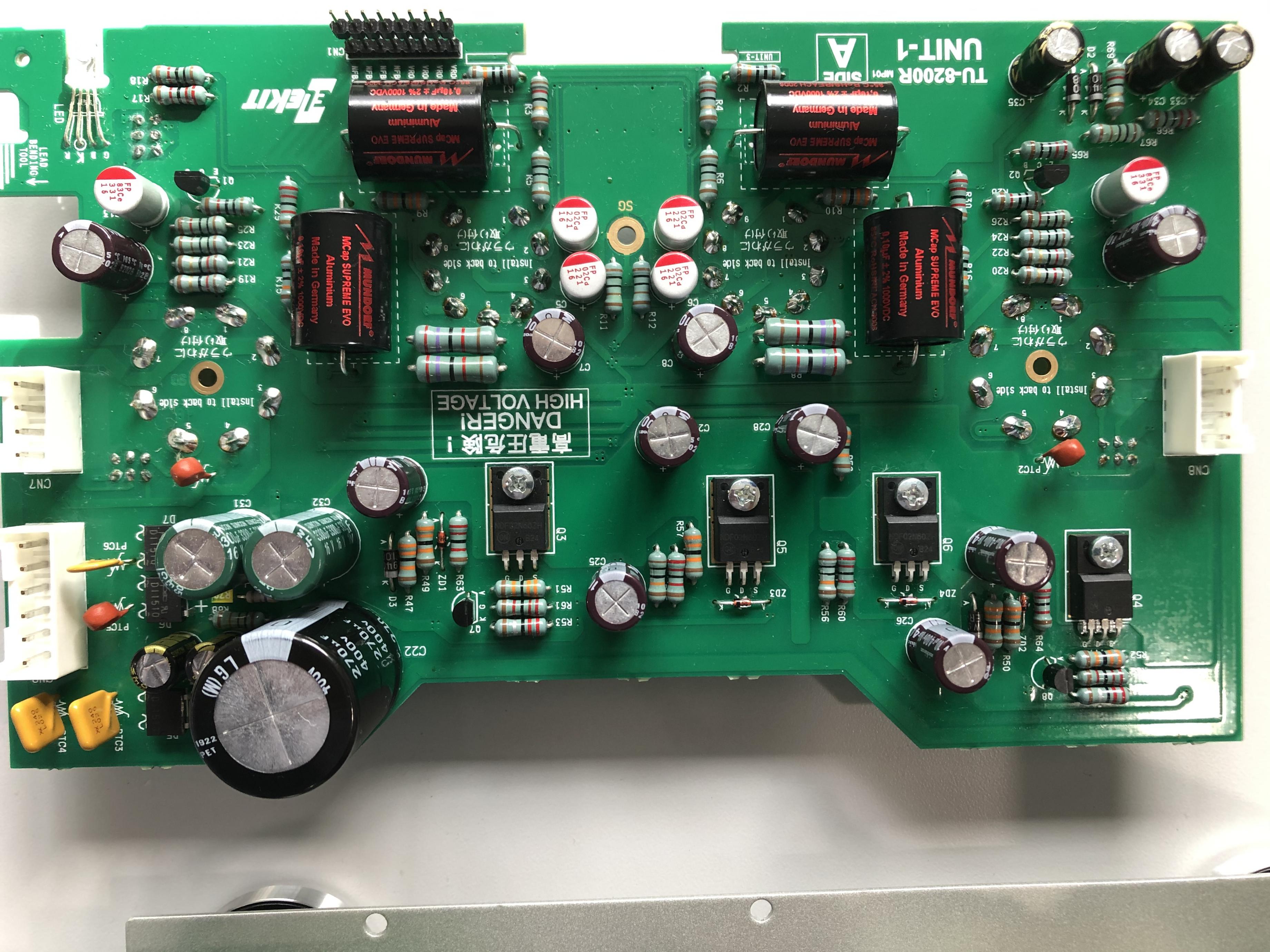

Just wanna show photos of my completed Elekit TU-8200R kit build and my listening experienced. I swapped power tubes to Sophia Electric Coke-bottle KT88-ST and driver tubes Genalex-Gold Lion B749/ECC82/12AU7 also upgraded resistors to Takman 1% metal film and coupling capacitors with Mundorf MCap Supreme EVO Aluminum and I must say the KT88 tubes is far superior way much better in my opinion and sounds really good than the stock JJ’s that comes on this kit. Listening to new album “Wallflower” by Diana Krall and old album “Orgy In Rhythm” by Art Blakey recorded 1956, Paul Desmond “Bridge Over Troubled Water” recorded 1968 the sound is rich and detailed, superb imaging realistic bass, piano and alto saxophone smoothed good instruments separation the vocal is so clear is just like the singer is singing in front of you large soundstage very clean no noise/hum driving the Triangle Borea BR3 speakers 8 ohms 90db sensitivity and this amp can deliver powerful output rated 8 watts. The source of music are analog out of BlueSound Node 2i streamer with Parasound Zpre3 preamp also tested listening it with EVGA Nu Audio Soundcard analog out with upgraded Burson V5iD hybrid OPamp, the sound of TIDAL MQA Masters lossless audio is superb on all variety of music. Next project is to build a matching Elekit TU-8500 Tube Preamplifier 🙂

Hi Jerry,
nice job and pictures. I like the blue tubes very much. Small advice from my friend electrical engineer is to clean the residues of the flux with isopropyl alcohol and a brush. He says it can etch or damage the joints or leads eventually.
Best regards, Milan
