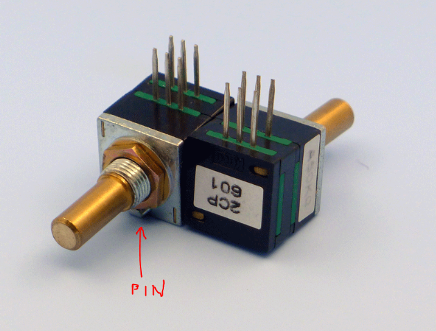

TKD 2CP-601
Hi, I am trying to install the TKD 2CP-601 pot into my new TU-8200R instead of the original ALPS. I just want to inform you, that the TKD 2CP-601 is 16 mm big and the original one is 9 mm big. The distance between the first and second line of the pins is 5 mm for TKD and the module 2 expects 3 mm distance.
The only way for me how to install the TKD is to cut out the piece of PCB from the module 2. I have to warp the TKD pins to fit them to the board. The cutted board needs to be soldered to the module 2 with some wires. The TKD will be attached to the device only thanks the module 3. But I need to drill a small hole in the module 3 for the pin on the front side of the TKD. I need to consider also the fact that the cutted board will need to be moved little bit down and back 5 mm and there is the spacer.
The second option I am thinking about is to fasten the TKD to the module 3 only and join the pins of the pot directly to the module 2 with wires, without using the cutted piece. But I am not sure if I can do it correctly as there are 8 holes and the pot has 6 pins. Can someone advice me how to do it correctly?
Has anyone some advice for me please?
The last notice is about the TKD 2CP-601S. This is mechanical stepped version with 21 steps. I do not like it as a volume control, I prefer the smooth rotation of the knob. Thank you. I wish you all the best. Milan
