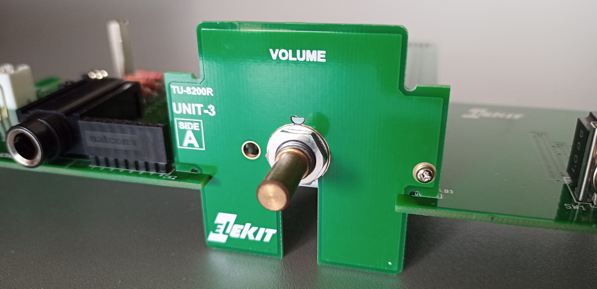

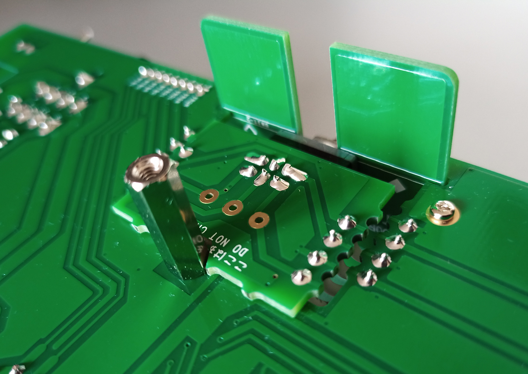

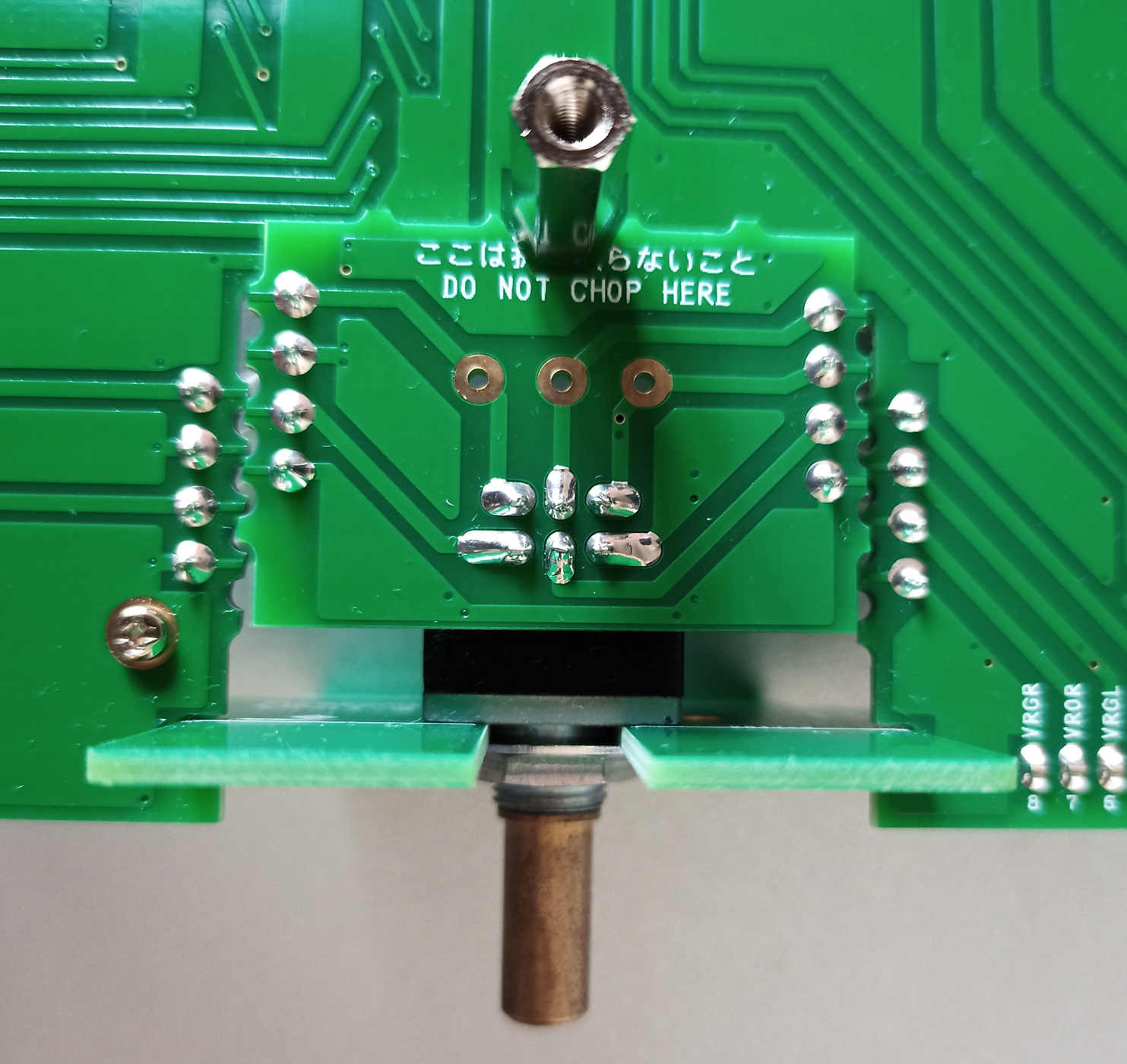

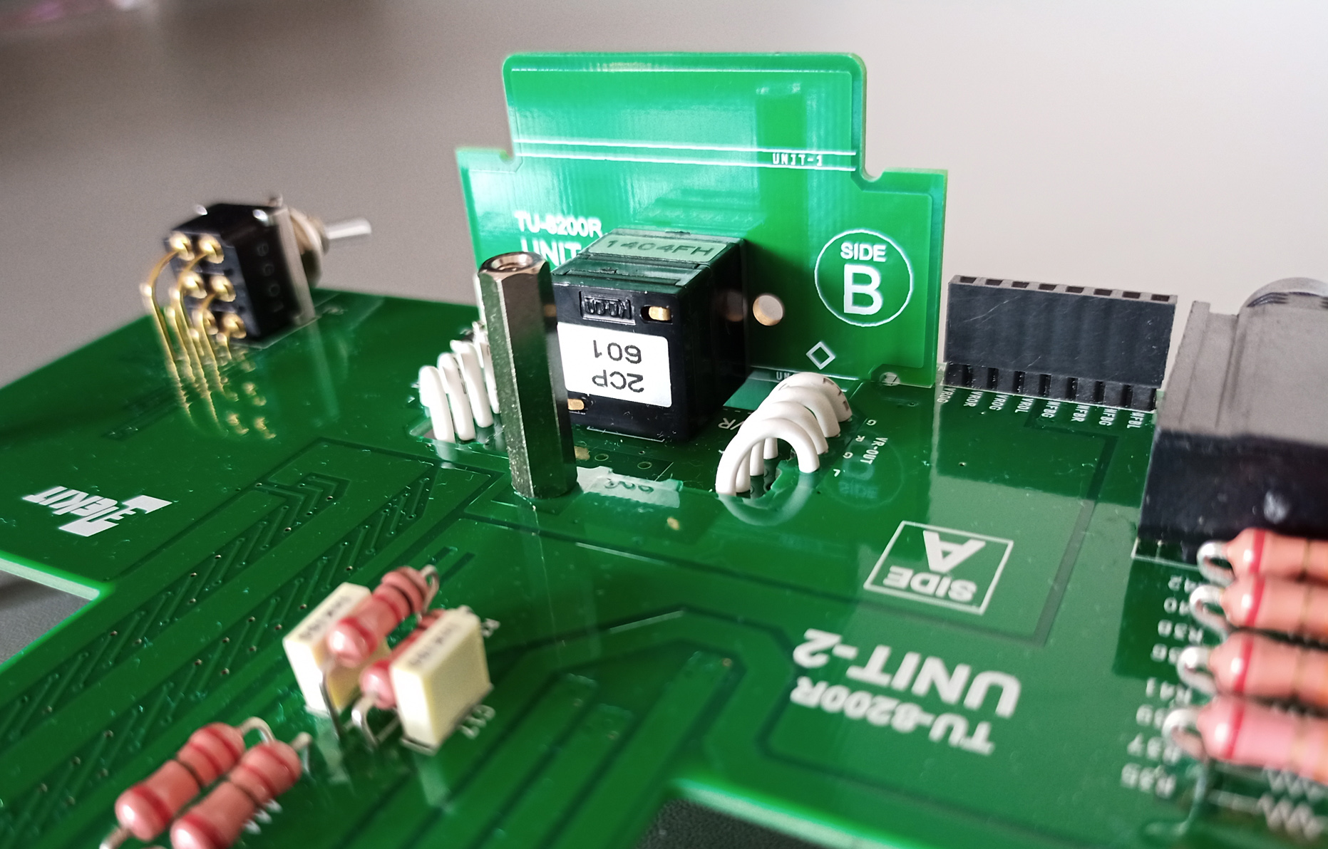

Hi, I am trying to install the TKD 2CP-601 pot into my new TU-8200R instead of the original ALPS.
Good luck with that! I installed one into my TU-8200. It is a lot of hassle.
The only way for me how to install the TKD is to cut out the piece of PCB from the module 2. I have to warp the TKD pins to fit them to the board. The cutted board needs to be soldered to the module 2 with some wires. The TKD will be attached to the device only thanks the module 3
Exactly
But I need to drill a small hole in the module 3 for the pin on the front side of the TKD. I need to consider also the fact that the cutted board will need to be moved little bit down and back 5 mm and there is the spacer
That is because that fixing pin is on the other side compared to the Alps models. I used a custom spacer so I did not need to drill a hole in the PCB.
Has anyone some advice for me please?
My advice is - forget it. My sample was way out of balance at lower volumes. Other than that, I heard negligible sonic differences between this one and the small Alps stock pot. I really can't understand why this TKD became so popular.
I have replaced it with an Alps RK27, which is bigger, but much easier to install.

Dear Ferenc,
Thank you very much for your comments. It was appreciated. I considered all cons and prons and decided to install the TKD 601 after I paid so much money for it. And I think I managed it. Hopefuly it will work after I turn the amplifier on. I am attaching some pictures.

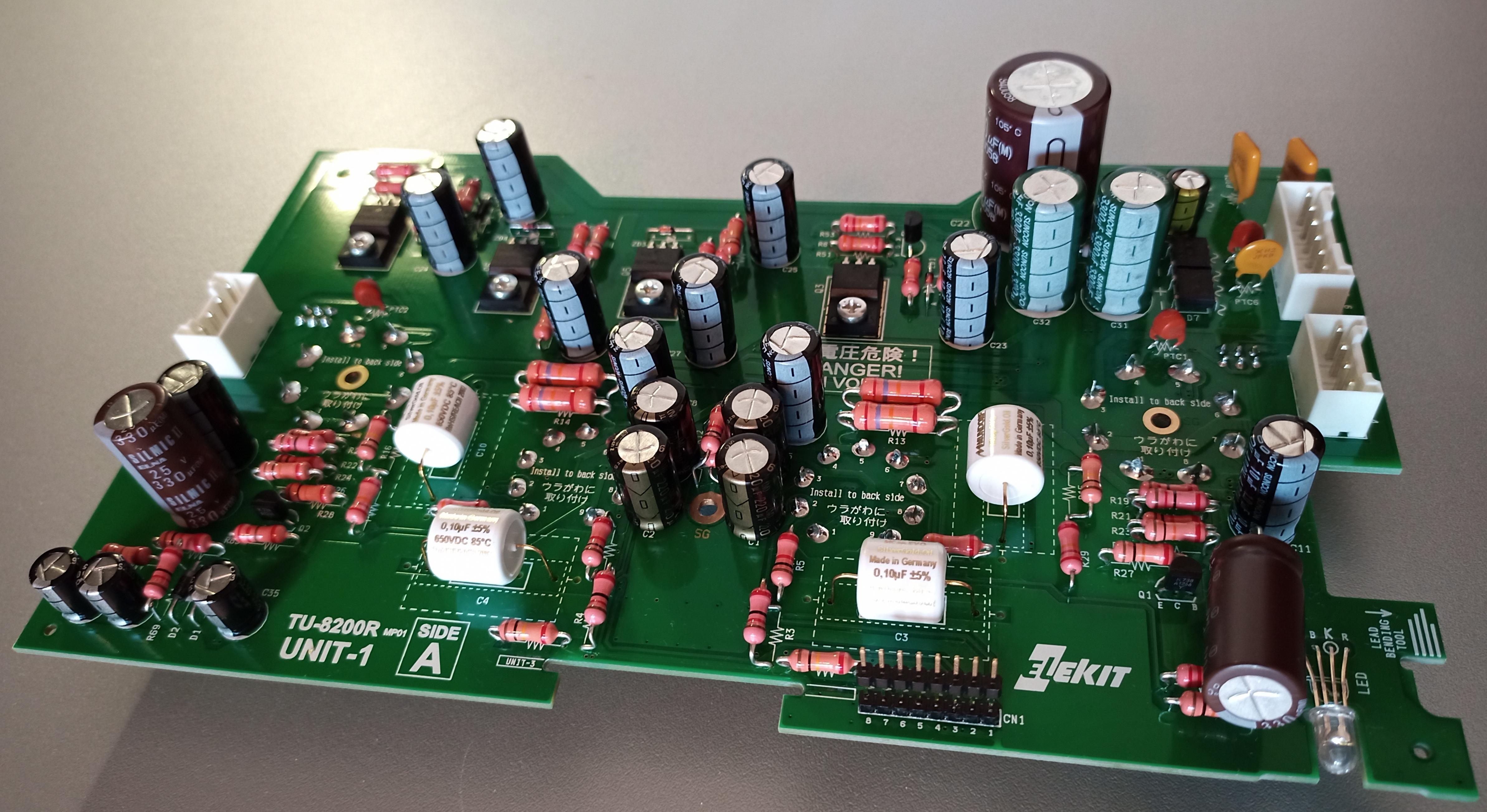

The electrolytic caps 330mf C13,14,33,34,35 that comes with a kit rated 25v can I replace it with 330mf/16v Panasonic polymer OS-CON's as replacement per Ferenc upgrade recommendation? Your comments is greatly appreciated.
All these caps have been upgraded from 220uF to 330uF in the "R" model, which practically covers that I suggested in terms of values. If you look at the reference voltages 11, 12, 17, 18 and 28 then you should measure these DC voltages on the particular caps: C33=6V, C34=5V, C35= 1.2V, C13=C14=0.5V.
Now you know the answer...
I would not bother with C33 and C34. On the other hand, the quality of C13 and C14 are very important as they impact the sound at least as much as C1, C2, C5, C6 cathode bypass caps (those that I no longer use btw). I upgraded C13/14 to 470uF OS-CON's.
Thank you Ferenc for the advice. This is my first vacuum tube build so I'm taking my time going through the kit parts list to make sure I have everything and will do the critical changes that you recommended also the kit comes with JJ's ECC82's and JJ's 6GLC6 and this probably much better than the Chinese 12AU7's is that right? From what I read on your thread that C3,C4,C9,C10 coupling caps is a must to upgrade and it will make a significant improvement to the sound. Is there anyone tried other brand that's much cheaper comparable to the most expensive Mundorf Supreme EVO - SilverGold Film Capacitors 🙂

Hi Jerry,
I have just finished my TU-8200R. I replaced resistors and capacitors based on hificollective recommendation:
(REX50-010) - 2R2 0.5W TAKMAN Carbon Film Resistor x 2
(REX50-250) - 220R 0.5W TAKMAN Carbon Film Resistor x 6
(REX50-490) - 22K 0.5W TAKMAN Carbon Film Resistor x 9
(REX50-450) - 10K 0.5W TAKMAN Carbon Film Resistor x 5
(REX50-570) - 100K 0.5W TAKMAN Carbon Film Resistor x 6
(REX50-630) - 330K 0.5W TAKMAN Carbon Film Resistor x 10
(REX50-100) - 12R 0.5W TAKMAN Carbon Film Resistor x 9
(REX50-330) - 1K 0.5W TAKMAN Carbon Film Resistor x 10
(REX50-500) - 27K 0.5W TAKMAN Carbon Film Resistor x 4
(REX50-030) - 3R3 0.5W TAKMAN Carbon Film Resistor x 8
(ELNAC-115) - 220uF 16V Elna Cerafine Electrolytic Capacitor x 4
(ELNAS-140) - 330uF 25V Elna Silmic II Electrolytic Capacitor x 2 - LIMITED SPACE FIT HORIZONTALLY
EVOSGO-020: 0.1uF 650V Mundorf Mcap EVO Silver Gold Oil Capacitor x 4
If you wish, check their web Elekit TU-8200R 6L6GC / EL34 / 6CA7 / KT88 / 6550 Single Ended Tube Amplifier kit | Hifi Collective

(...)also the kit comes with JJ's ECC82's and JJ's 6GLC6 and this probably much better than the Chinese 12AU7's is that right?
I hope so...
It was certainly not me who wrote that. My experience with these Mundorf Supreme whatever capacitors is that at least in this amp they are just marginally better than the Amtrans AMCO caps that came with the "DX" upgrade kit for the original model. The issue is that cap replacement takes significant time compared to tube rolling and our auditory memory is short. We seldom have 2 units of the same amp.
- Ferenc
the R version includes four cathode BY PASS caps. These 4 caps must be low ESR.
This is why the R version is using OS-CON.
The stock R version (C1, C2, C5 & C6) OS-con is very low in ESR. It does not make sense to replace caps with higher ESR .
Yes, and no one said the opposite here. These caps were included in the "DX" upgrade kit for the original model but are standard in the revised amp.
I read an article on the internet where some guy tested more electrolytic capacitors how they influence the sound. He wrote that the caps with lower ERS did not win the comparison. The top of his chart was occupied by specialized sound capacitors even with higher ESR value. The cap with a very low ESR did not sound well in his test.
I know nothing about electronics but still I hope it was not a mistake to install the caps recommended by guys from Hificollective. To be honest, I am not able to recognize the quality of the sound because I'm deaf like an artillery mare. And I am too lazy to re-install the caps and try to recognize any sound difference.
Do you think the tubes are not working optimally when I used those ELNA Cerafine caps instead of low ESR Panasonics? Thank you.
