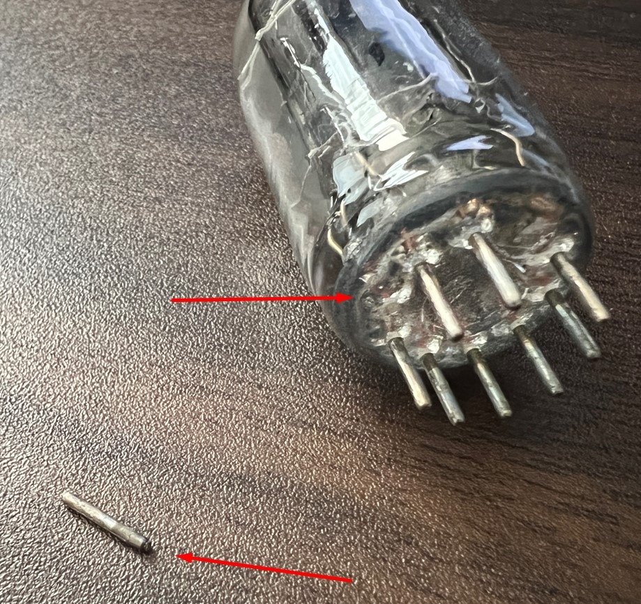

anyway this tube/pin can be repaired? i noticed a huge hum when turning on the amp, and then this tube turned bright orange... when removing it, that one pin was stuck in the socket
ok. just curious - how can you tell the glass is cracked? im not seeing itNope… that’s garbage… the glass is cracked around the pins too
It's those diffracted lines around the pin. Presuming your other 12AU7 is good? just take a look to compare.ok. just curious - how can you tell the glass is cracked? im not seeing it
However, gotta ask... how it it get like this? Kid throw something across the room and hit the tube?
it looks the same to me. i have no idea. is it that rare for something like this to occur?It's those diffracted lines around the pin. Presuming your other 12AU7 is good? just take a look to compare.
its only been put on and removed a handful of times since i purchased. it was sold as 'nos' rca blackplate ... maybe its just old?
I retract what I say about the cracks because I realized it could just be the way the light is refracting in the photos. However I do think that you should replace it.it looks the same to me. i have no idea. is it that rare for something like this to occur?

I considered it too but decided against it… Those are double the heater current… You’d be stressing out the little bridge rectifier and possibly the 0.47 ohm resistor in the H+ supply…Anyone try using 6sn7 tubes with adapters in place of 12au7s?
on the bright side, these are cheap and plentiful parts of you do burn them out but I cannot comment on other collateral damage since that supply also feeds the auto bias reference.
thank you, ill skip the adapters tooI considered it too but decided against it… Those are double the heater current… You’d be stressing out the little bridge rectifier and possibly the 0.47 ohm resistor in the H+ supply…
Just want to confirm that anything other than a 12au7 (0.3A heater) will in likely send the H+ supply into thermal protection.
Tried a 12BH7 (0.6A heater, as it turns out) but went the sound cut out after about 15 minutes, biggest clue was the LED went dim, which uses the H+ supply.
I did the reckless experiment so nobody else has to 🙂
If you had asked how you could use preamp tubes with 0.6A heater current, you would not have had to do potentially harmful experiments.I did the reckless experiment so nobody else has to
