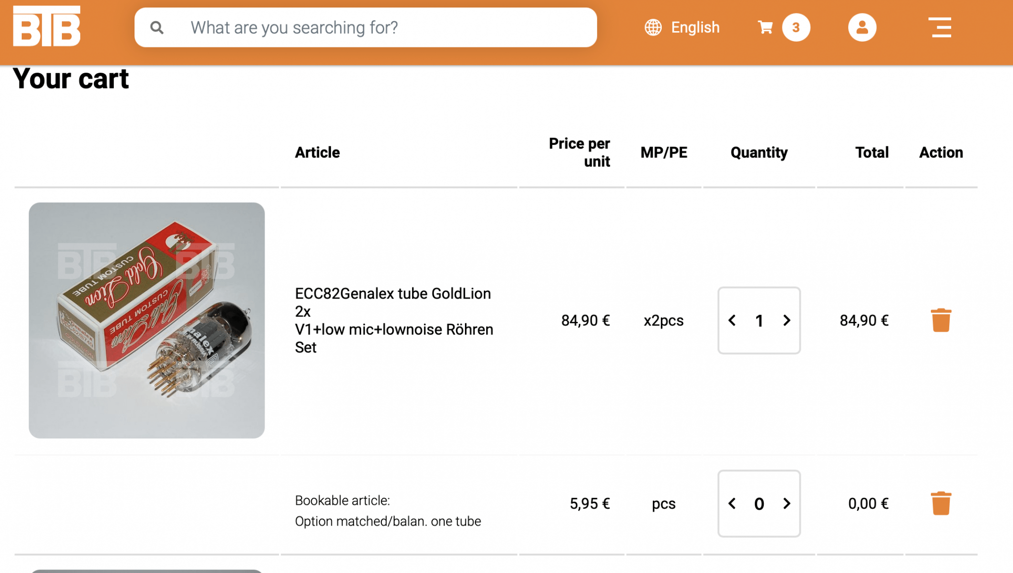

Do I need to buy a matched pair for the 12au7 ?
I read that it is not necessary for the power tubes because of the automatic bias, but haven't been able to find any mention of whether this also applies to the 12au7s as well.
The 12AU7 is a double triode itself, you have 4 triodes in two tubes. What does "matched pair" mean here?
Thanks paczeltf, I did not know that. I ask because at checkout from a shop I noticed the option for getting matched pairs:
I suppose I thought there was one 12AU7 per channel, and that perhaps they had to be sufficiently similar in order for both left and right to sound the same.
Do you mean that this is not a concern and that any two 12AU7 of the same model should be fine?
It is not clear what they mean by "matched/balanced one tube", but I suspect that the two triodes in the same tube are matched. That does not help that much, because the TU-8200 uses one tube for each channel, so what you would really need is that triode1 from the first tube matches triode1 in the second tube, and triode2 in both tubes are also similar. In my experience the differences in these types of tubes are not very big though.
