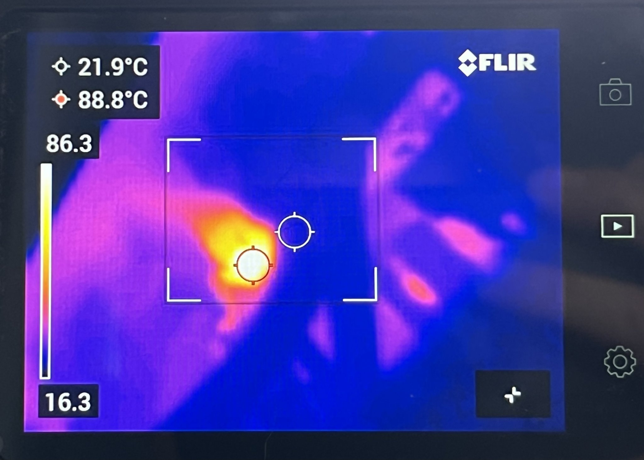

The thing is that many reviews you’re reading may be coming from those who aren’t really experienced with electronics, swapping in power tubes that aren’t rated for the plate dissipate may work initially but may lead to premature tube failure and worse yet, internally shorting which will kill the amp.
Also, be careful with the preamp tubes filament rating, I noticed a “flaw” in the use of the bridge rectifier (D7) in TU8200R where it’s running SUPER hot even with the stock 12AU7, which is as low as filament currents get for dual triode preamp tubes.
I mitigated this by putting a heatsink on D7… i would not mess around with alternate preamp tubes unless you take D7 off board and, using a larger bridge rectifier that’s bolted to the chassis

The heater bridge rectifier was upgraded to a 1.5A model from the original 1.0 A. It should drive ECC82 without problems. I don't remember anyone reporting rectifier failure in a TU-8200. How did you measure its surface temperature?(...)
you can run 4 wires off the board to a off-board bridge rectifier.
I used a FLIR C3X, while not the most accurate, usually measures in the side of cooler, was measuring 88 degrees C with the stock 12AU7, it was partially obscured by wires in the way of the lens too. While not deadly, I wouldn’t call it running comfortably cool… I certainly would not push it with preamp tubes with more than 300ma filament current. In fact, I got smoke using the same BR chip to power a set of 6CG7 filaments in a different unit, which was the impetus for checking the temp on this oneThe heater bridge rectifier was upgraded to a 1.5A model from the original 1.0 A. It should drive ECC82 without problems. I don't remember anyone reporting rectifier failure in a TU-8200. How did you measure its surface temperature?
