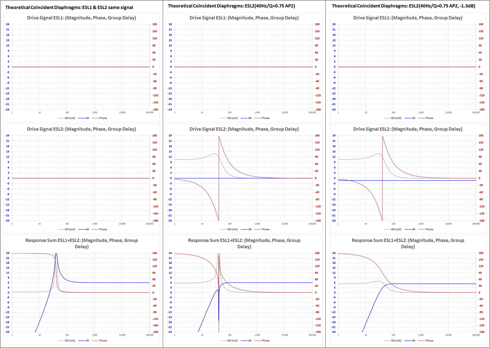

I looked for my measurements but can't seem to locate at the moment. So here are a few modeling plots to think about.
First consider a theoretical situation where the diaphragms of ESL1 and ESL are coincident rather than one spaced behind the other.
- Left Column of plots: If both ESL1 and ESL2 are driven with the same signal you would get the expected 6dB increase and resonance would still have Q=10.
- Middle Column of plots: Insert a 2nd order AP filter @ 40Hz into the ESL2 drive signal and you damp the resonance as desired, but acquire a notch cancellation right at 40Hz.
- Right Column of plots: If you now reduce the ESL2 drive signal by about -1.3dB the notch disappears and you are left with text book LF roll off at the cost of about -0.5dB loss in sensitivity.

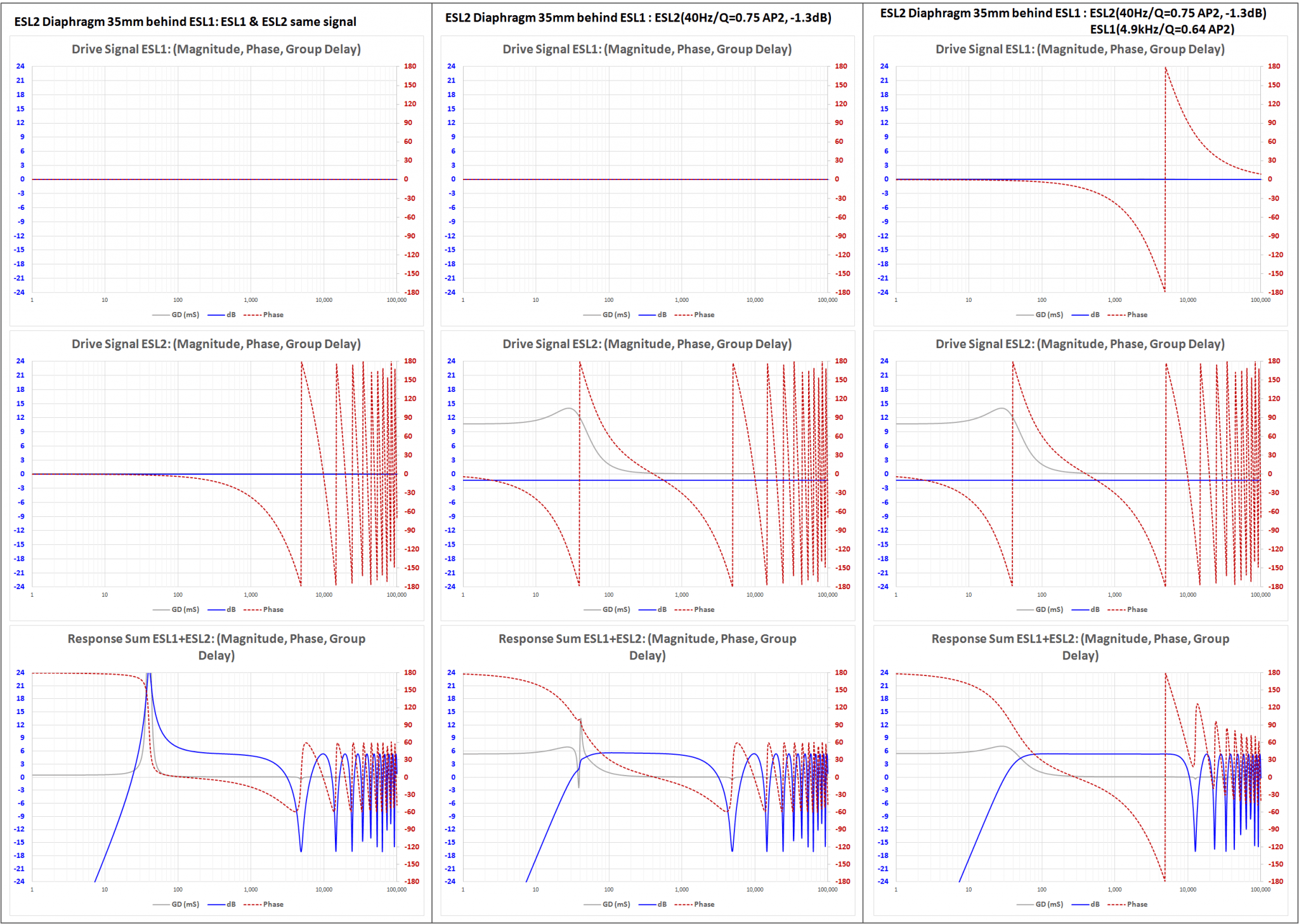

Now consider some Acoustat panels. At best, the diaphragm of ESL2 will be no closer than 35mm behind the diaphragm of ESL1.
- Left Column of plots: If both ESL1 and ESL2 are again driven with the same signal you still get the same LF behavior, but now the time delay of ESL2 results in comb filtering.
- Middle Column of plots: Using the same AP filter and -1.3dB signal reduction as above, LF is nearly text book with a small hitch, but the comb filtering remains
- Right Column of plots: If a 2nd order AP filter @ 4.9kHz is added to the ESL1 drive signal the LF returns to text book and the first notch of the comb filtering is removed.
If stator construction allowed getting the diaphragms closer together, this approach could remove all anomalies in the audio band.
But, I personally don't feel it is worth the extra cost or effort.
