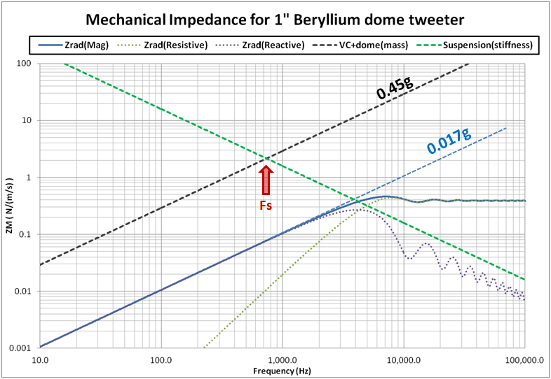

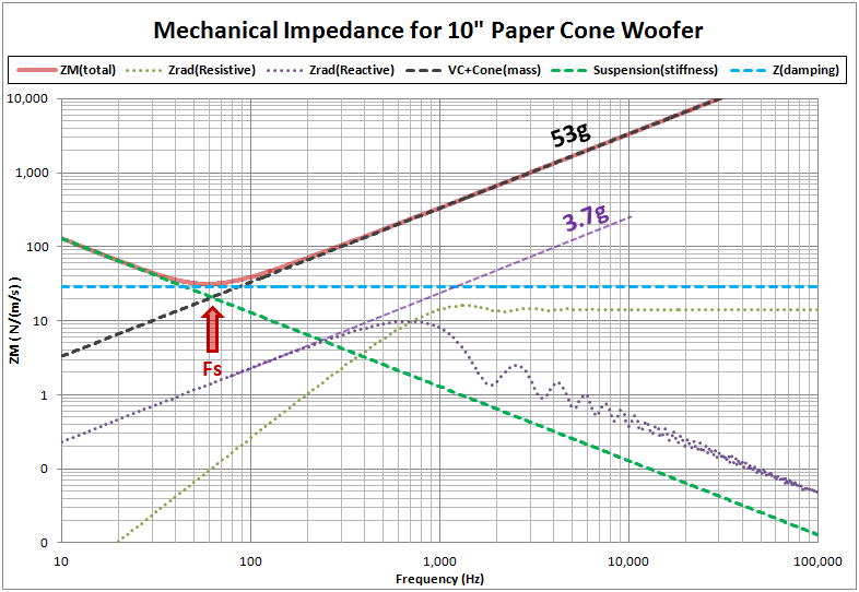

I don’t recall saying this; do you happen to recall the context? Other than in the top octave, the mechanical impedance from the weight of the diaphragm is nowhere near a match to the radiation resistance. Whatever the magic of ESL’s sound, impedance match between the air and the diaphragm is not the explanation.
If the same analysis were done before Rice and Kellogg made their driver, everybody would have said shaking cardboard to make sound would be a waste of time.
I’m not sure if you have read the Rice/Kellogg AIEE paper on their testing and developmental work on a range of transducer types(including ESLs) leading to recommendation for the moving coil loudspeaker. One of the key features they pointed to was the fact that is was mass controlled over nearly its entire useful range. For comparison with the previously posted ESL mechanical impedance plot, here are plots for a typical 10” woofer and 1” tweeter where you can see this feature of mass control is still present today.

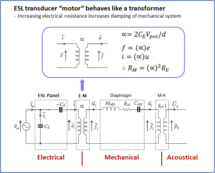

The 2nd term in the Force formula has the transduction coefficient ∝ built into it. Damping isn’t part of the force equation; rather it results from the electrical and mechanical domains communicating with each other thru the transducer motor. An applied voltage results in force on the diaphragm which in turn results in the diaphragm attaining a velocity which produces a motional current. If there is some resistance included in the electrical circuit, the voltage drop across the resistance due to this current counteracts some of the applied voltage resulting in reduction of the force and velocity (ie damping).
If the panel have zero resistance (not in realistic), then the charges are shuttled from one stator to the other thru the transformer secondary or other conductive path indefinitely (AC) and the diaphragm will keep oscillate or vibrate back and forth indefinitely?

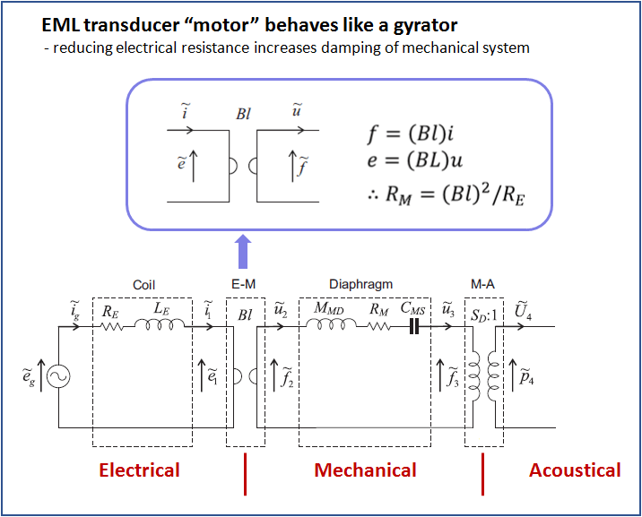

Comparing transduction coefficients, BL = 10 is pretty typical for an EML, and ∝ = 0.002 for an ESL.
The other difference is that the EML motor behaves like a gyrator and an ESL motor like a transformer.
View attachment 1030465 View attachment 1030466

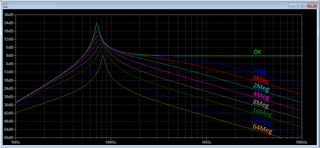

One consequence of this difference is that adding resistance in the electrical domain has opposite effects in the mechanical domain. For EMLs, minimizing electrical resistance provides the most damping of the mechanical system. For ESLs, resistance must be added to the electric circuit to damp the mechanical system. As mentioned previously, it isn’t very effective. As an example, here is a trend for an 400pF ESL panel with increasing resistance added in the electric circuit.
Even with 1Meg of resistance very little increase in damping is seen, and the power response is rolling off at high frequencies due to the first order LP filter formed between the series resistance and the panel capacitance. Note that as you continue to increase resistance the Q actually starts to go back up and the resonance increases to the unpolarized resonance frequency. This is because the resistance is >> impedance of the panel capacitance so you are in effect driving the panel with a current source. The negative compliance -Ce is then cancelled out by the panel capacitance Ce as explained in the Baxandall ESL chapter. It is all rather academic since so much sensitivity is lost with high series resistance that it isn’t practical anyways. If interested, experimental results for this behavior were posted here:

Yes. It's the same as with EML except it's the 'dual'. If there is a large electrical source resistance, the ESL velocity current will generate a voltage. The resultant voltage gradient acts on the charge and opposes its motion.
With EML, cone velocity generates a voltage. This voltage across the electrical coil resistance results in a current which generates a force opposing the velocity.
These give rise to the 2 eqns. for Electrical Damping. One I showed for EML and the other that bolserst showed for ESL

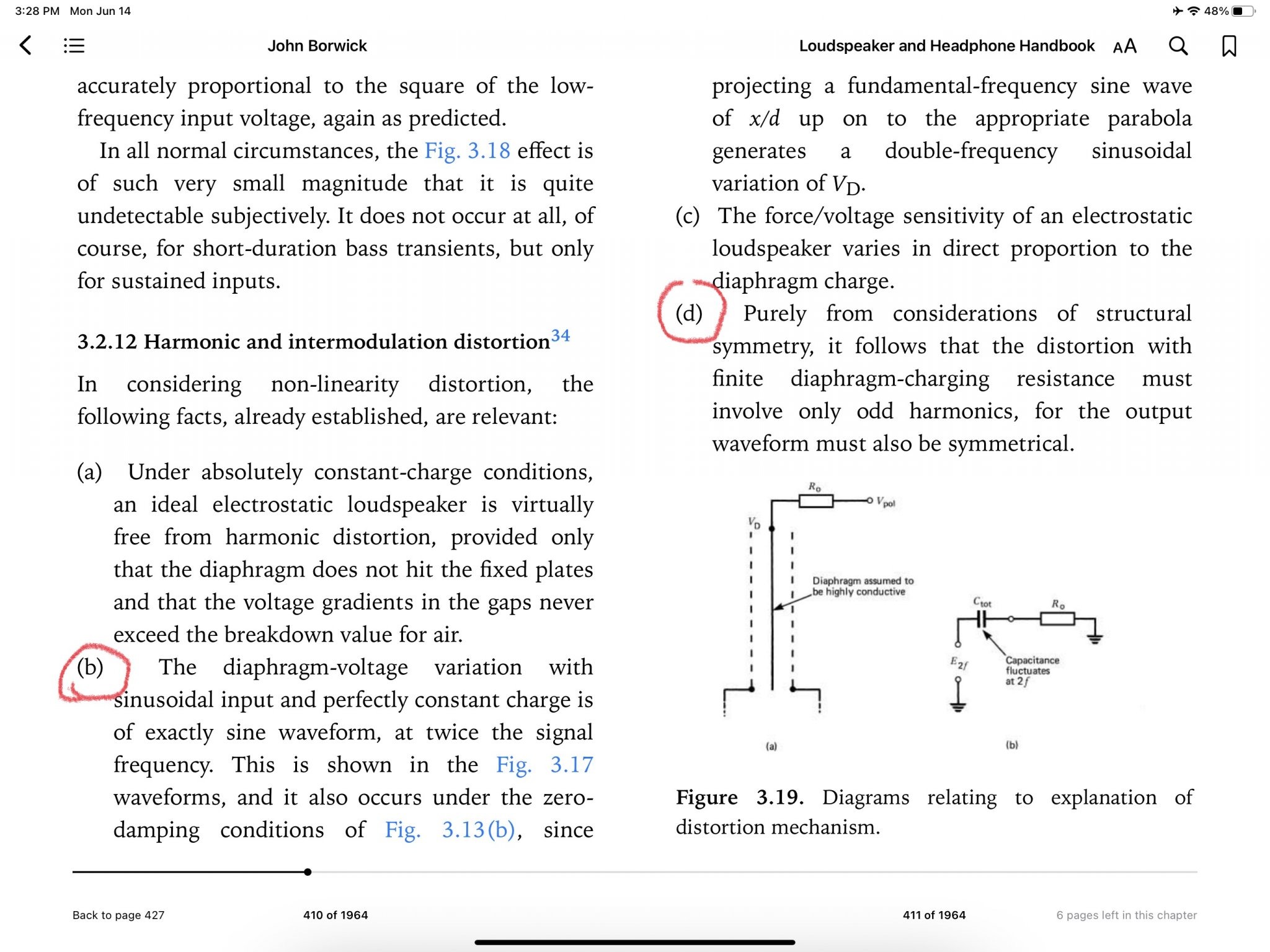

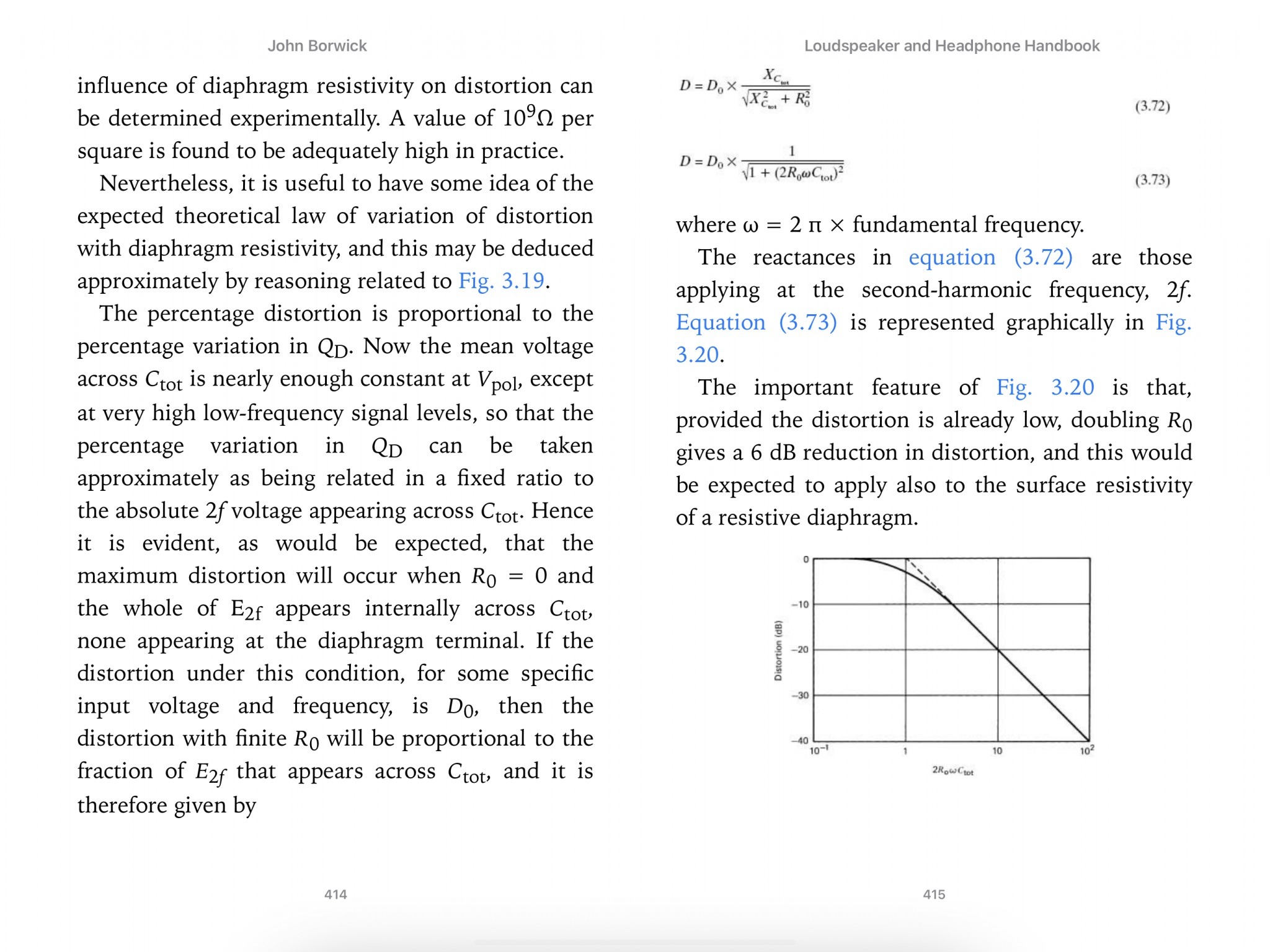

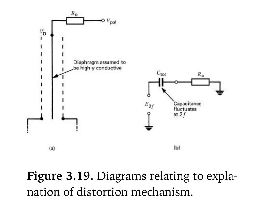

The distortion of EML and its causes have been explained in details by Klippel. On the subject of the ESL distortion (THD): As low as it is, but due to the fact that it's not an electret, but a finite high resistance diaphragm, it can cause some 3rd harmonic distortion. It's explained in the pages I've attached. Have anyone calculated or simulated this minimum theoretical limit of this distortion (Eq 3.73) using realistic capacitance and resistor (Ro) values that is being use by most ESL?

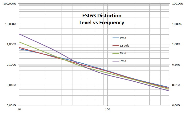

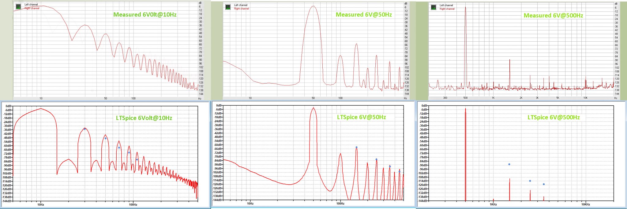

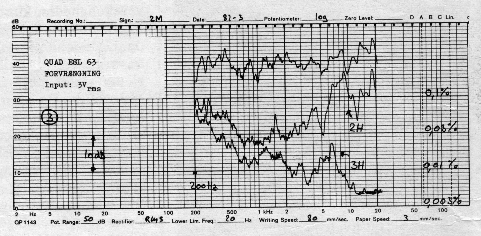

Not sure whether this answers your question, but I have simulated AND measured distortion of an ESL63 at resp 10Hz, 50Hz and 500Hz with a 6V input signal.
In the first image, the top row shows the measured results versus the bottom row the simulated outcome.
With blue dots the measured harmonics are shown in the simulated graphs.
Second image shows measured THD for various input voltages up to 500Hz.
IMO EML´s can only dream of this sort of distortion.
Hans

Do you have the measurements and simulation for above 500Hz?
