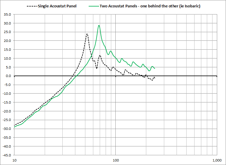

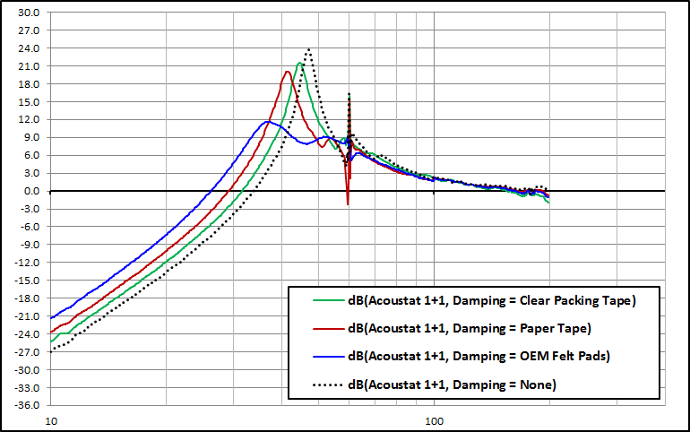

And why did you decide that Acoustat installed felt behind the panel for this purpose? Have you taken measurements with and without felt and found a clear spurious resonance that stands out from the rest?
The Acoustat 1/4" thick felt blocks along the centerline of the panels do a pretty good job of damping the fundamental resonance without causing too much trouble in the midrange.
It is obviously a compromise, but one that served them well. Compare blue line(with felt) vs the dotted line(no felt)...ignore the 60Hz noise spike
More details here: https://www.diyaudio.com/community/threads/acoustat-answer-man-is-here.183168/post-4691380

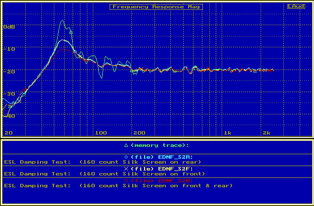

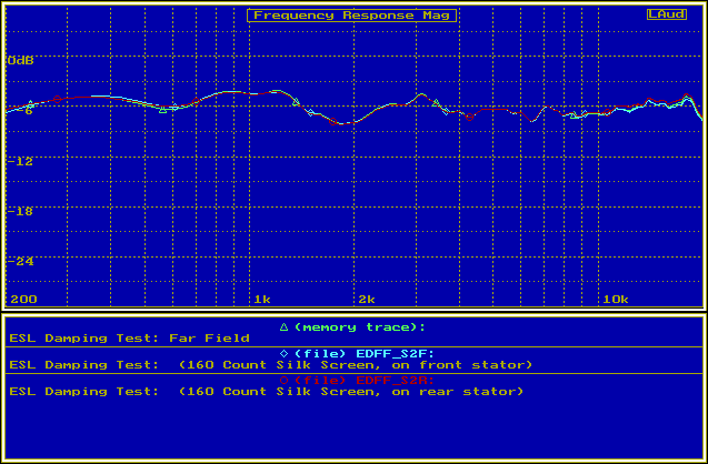

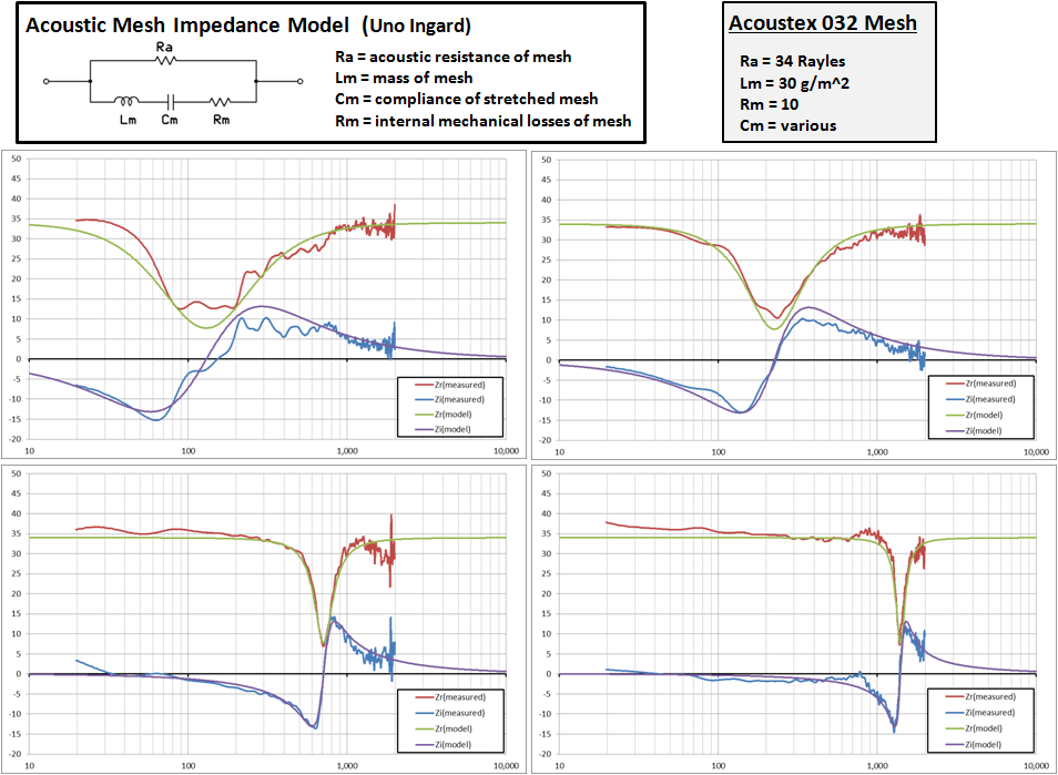

My preferred approach is the use of thin acoustic mesh similar to that used in the Quad ESL-63. This mesh behaves very nearly like a perfect acoustic resistor, damping the diaphragm resonance without changing the midrange response.
More details here: https://www.diyaudio.com/community/...ots-for-resonance-control.152979/post-1958582
Regarding the low frequency response of isobaric configuration, adding a second identical ESL panel directly behind the first increases the resonance frequency without adding much if any damping. Theoretically, if there was very little air space between the panels the frequency would increase by a factor of sqrt(2) = 1.414. With Acoustat panels there winds up being about 35mm of air between the diaphragms resulting in the resonance frequency increasing only by a factor of 1.35.

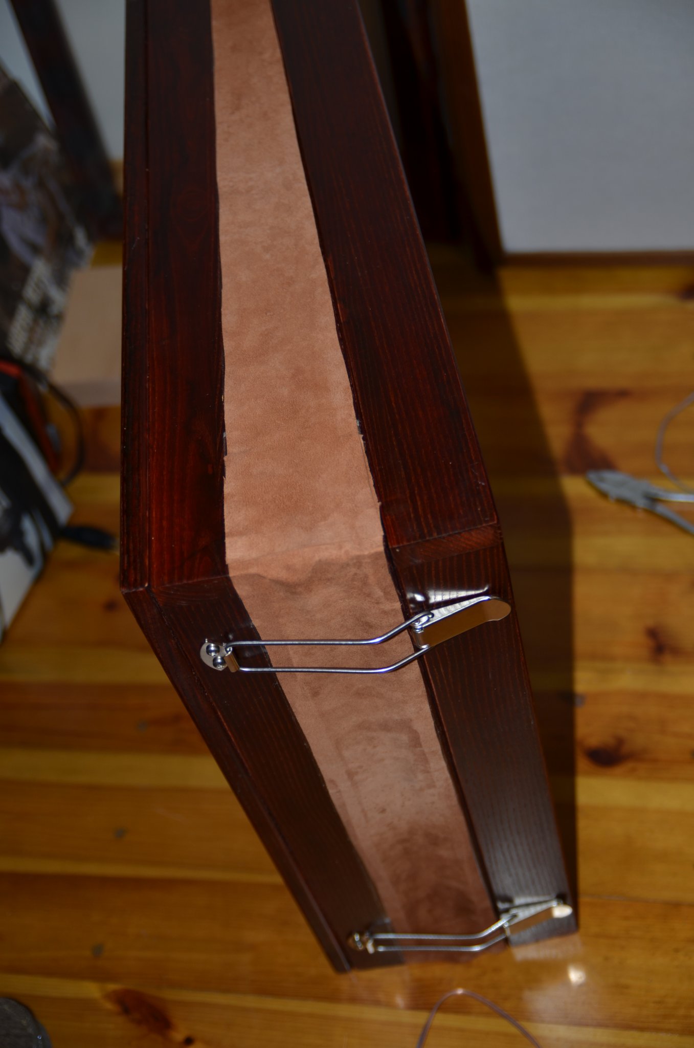

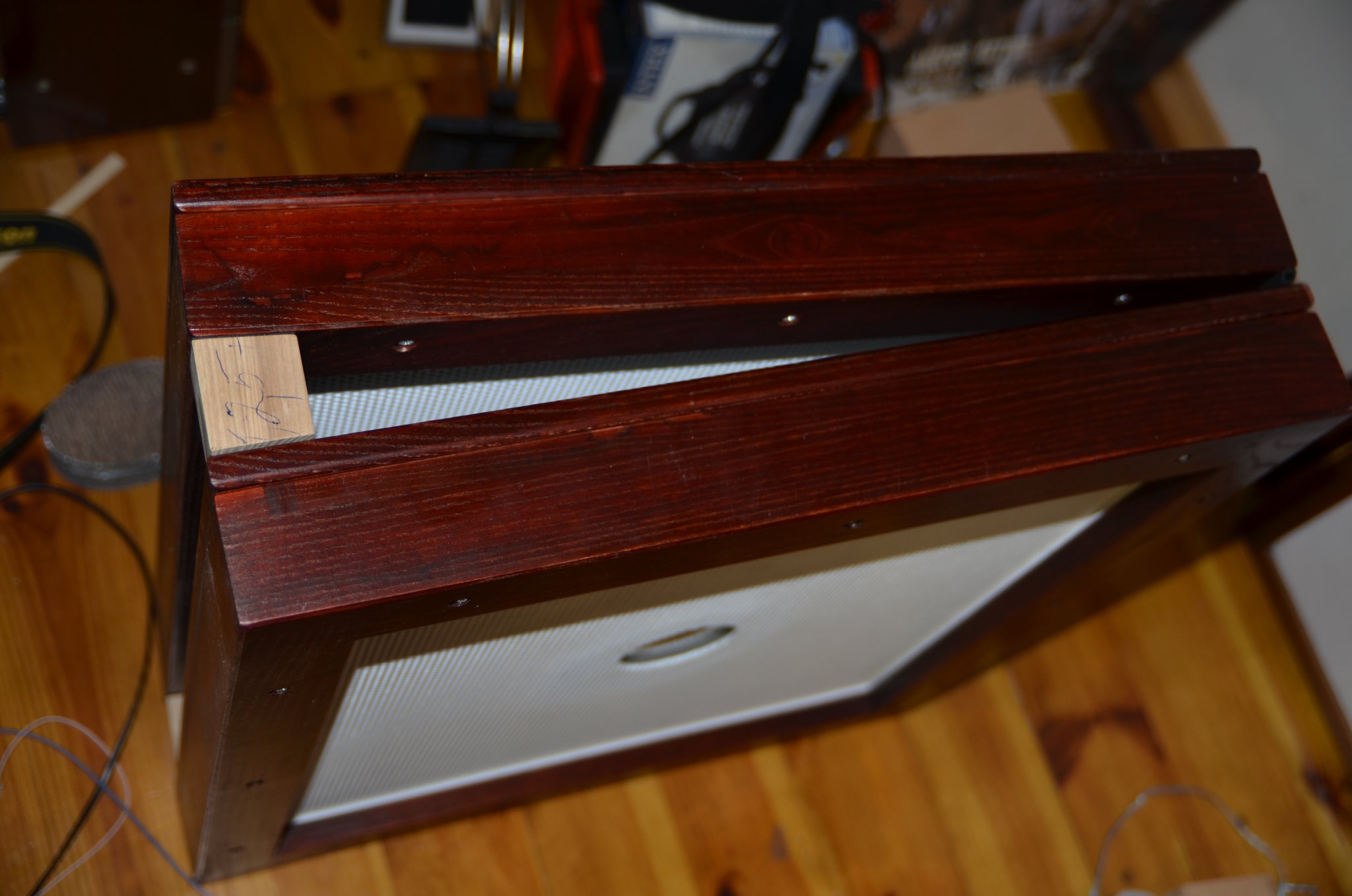

Parasitic resonances and their elimination are sometimes random. Having tried many damping materials, I abandoned them completely. I already wrote here that the following is happening to them - I put my head, my tail fell, I put my tail, my head fell. If your ESL is focused on the low-frequency region and you are going to fight parasitic resonances there, then be prepared for the fact that along with parasitic resonances, a useful low-frequency signal, which is already weak in ESL, will also go away. Here is an example of how I struggled with parasitic resonances in ESL subwoofers. These are two packages of isobaric construction, each with three membranes and four stators, as you can see, they are NOT parallel and connected by supple natural leather.

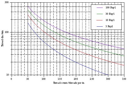

So what exactly is "acoustic" mesh? All I can find is mono filament silk screen mesh. Is that suitable?
An example of the acoustic mesh can be found on the Saarti website https://www.saati.com/en/markets/consumer-electronics/acoustics.
Another example of a monofilament mesh is bolting cloth - used to sift flour and other fine powders e.g. https://www.macrokun.com/News/screen-printing-mesh-news/281.html. I believe it is bolting cloth that Quad use in their ESLs.
Both the acoustic mesh and bolting cloth tend to be expensive. The cheapest option is the screen printing mesh, which is available in 25 m lengths very cheaply on aliexpress.

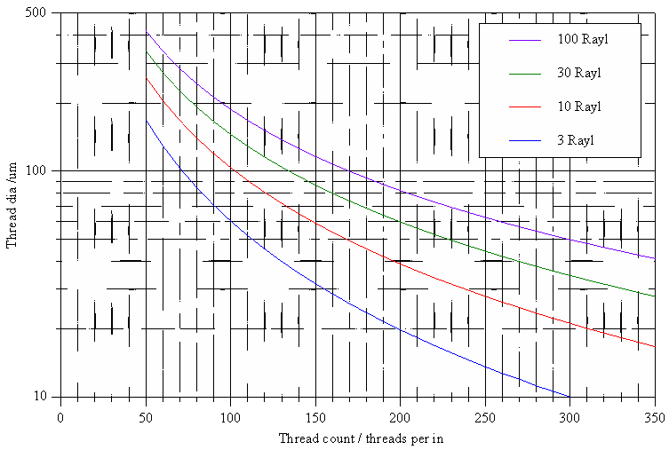

The trick is to get mesh of the correct acoustic impedance - the right balance of thread count and thread diameter. A few years ago I developed the following chart based on the Saarti specifications. Note the confusing mixing of measurement units - imperial (threads per inch) for the thread count and microns for the thread diameter - seems to be the industry standard.
The acoustic resistance required on an ESL depends on a bunch of things but usually somewhere between 40 and 100 rayl is about right. If you glue the mesh to the stator, the resistance of the mesh will be higher. If the open area of the stator is 40%, then the resistance will be higher by a factor of 2.5 (1/0.4). The mesh needs to be tensioned to work effectively, other wise it just moves with the air and does nothing at low frequencies.

No. rayl is the unit for measurements of acoustic resistance. Acoustic resistance is the ratio of the sound pressure to volume velocity (analogous to electrical resistance = ratio of voltage to current). The rayl is named after Lord Rayleigh who did some of earliest and most significant research on acoustics.
To determine the acoustic resistance from the chart, you need to know both the thread count and the thread diameter. Unfortunately, it seems that the sellers on aliexpress no longer include the fiber diameter in the spec. When I look at other mesh suppliers, I was able to find 160 count mesh with both 58 um and 65 um diameter mesh probably giving a resistance in the range 10 to 20 rayl.

The 160 count mesh(ie number of threads per inch) I was experimenting with back in 2009 had thread diameter of 64 µm.
I measured the acoustic resistance to be 18 Rayl, so 36Rayl total when used on front and rear stators.
Rather than attempting to hold a high tension on the mesh, it is easier attach it to the stator or closely spaced supports. Like diaphragm resonance, once you get the unsupported dimensions small enough you don't need much tension to keep resonance well above the bass range where the damping is most needed. I haven't tried it, but I bet if you glued mesh to the Acoustat stator frame with its unsupported dimensions of about 1/2" x 1/2" there should be no problem getting uniform LF damping by just gluing it down smoothly.

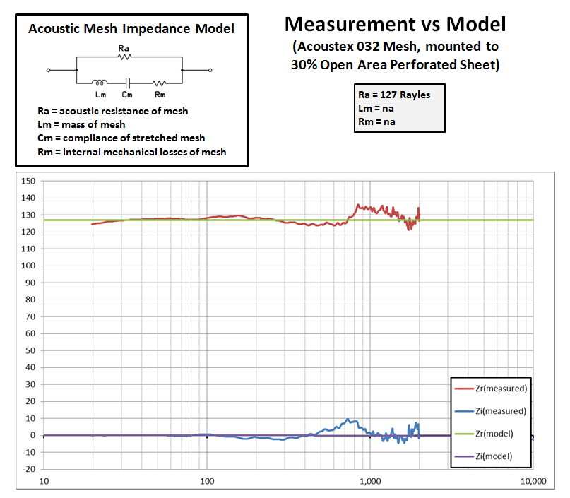

I had posted some acoustic resistance measurements for Acoustex 032 mesh in a test section having unsupported width of 2".
It didn't take much tension at all to achieve resonance above 200Hz which would provide adequate damping for a full range ESL. With high tension, resonance could be pushed above 1kHz!
Originally posted here: https://www.diyaudio.com/community/...ots-for-resonance-control.152979/post-5978781
Attaching the Acoustex 032 mesh to a perforated sheet with 30% open area, and you can see the increase in acoustic resistance mentioned by golfnut.
