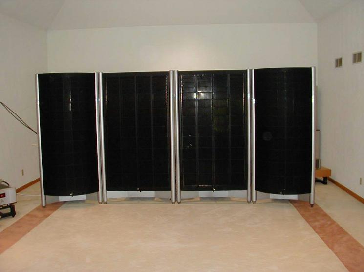

With Bolserst's 4 x Soundlab panels taking up 60% of the room x-section in #356, this should be the case in most of the room :eek: ie you could be operating in the Near Field with big panel radiators in most (even Texan) rooms

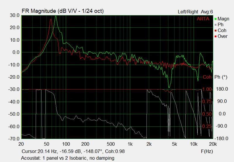

Thank you. Yes, it is .003"

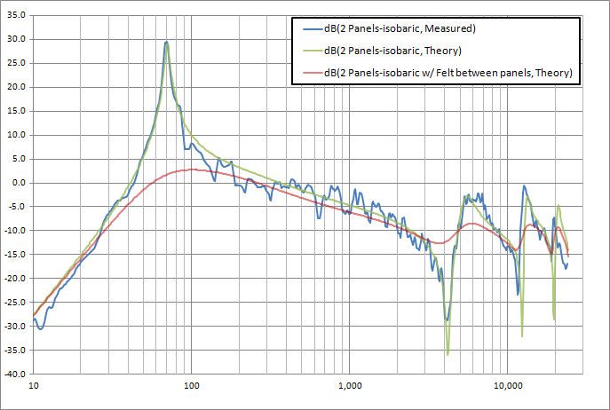

Great! then sounds like you have ~20 Rayl Mesh.
Looking back in your other thread: https://www.diyaudio.com/community/threads/isobaric-esl-alternative.364330/post-6487865][/url]
I see I had posted comments of what to expect measurement-wise with the thick felt between your panels, but never posted a set of quick-n-dirty undamped measurements I had taken of a friend’s Acoustat panels. These were near-field measurements about 2 inches from a location roughly 1/3 length, 1/3 width. First with just one panel, then holding the 2nd panel tightly behind the first. You can see the different things we have discussed in this thread...the increase in resonance frequency, the roughly 6dB boost in SPL, and the notches in the response due to the distance between the diaphragms. You should be able to measure something similar.
Using modeling techniques from an AES paper mentioned here: https://www.diyaudio.com/community/threads/superb-article-on-hf-esl-phenomena-imho.321111/post-5396518][/url]
You can see that theory matches the undamped isobaric response pretty well. I then added about 400Rayl of acoustic resistance between the panels to represent the thick felt you were using. The red curve was what I was describing in words in your other thread. (ie well damped LF response with roughly +/-3db ripples in the mid and highs. Using the 20 Rayl mesh front, back and middle should give you something midway between the undamped and the felt.
Also, don’t forget that the Acoustat has built-in LF boost to EQ the dipole roll-off. Since we are measuring near field, this tilts the response up at LF.

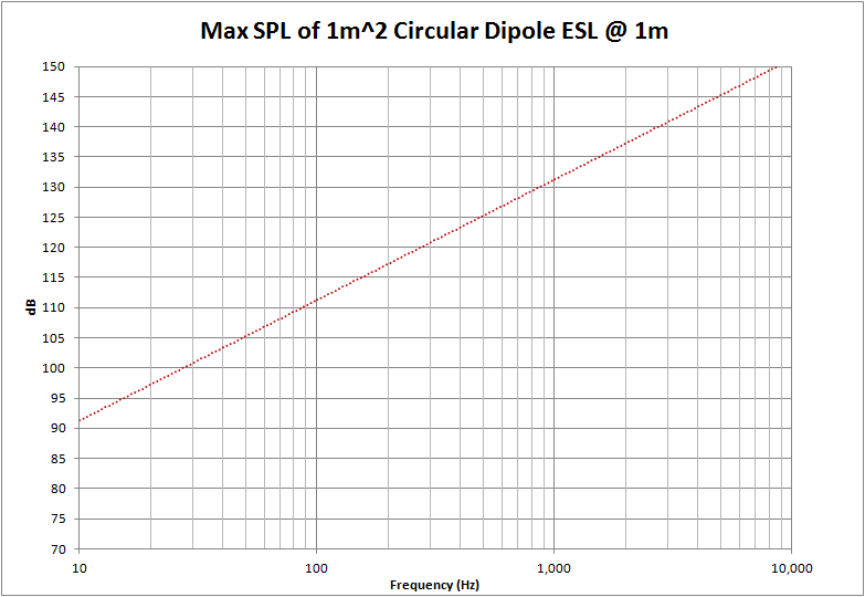

Your calculation is for a 1m^2 piston in an infinite baffle.
For a circular 1m^2 dipole ESL, the maxSPL increases with frequency and only hits 128dB above 800Hz and would be extremely directive.
128dB spl is simply 20 x log10(50N/m2) referred to 94dB (1 Pascal spl) and is at the diaphragm. This is the pressure exerted by the diaphragm so is also the spl over most of it.
For an arrangement like your #356 where the panels take up most of the room's x-section, you are nearly 'propagating' a Plane Wave into the room so the spl doesn't drop much with distance. Hence my comments about operating in the Near Field. Room effects apply but usually help rather than hinder spl in this case
You can envisage large full range panels (no segmentation bla bla) making up the walls of your room propagating 'Plane Waves' over the whole frequency range ... and this would some nice properties for stereo too :)
https://www.diyaudio.com/community/threads/open-cls-ii-stators-the-best-way-to-do-it.250559/post-3822064][/url]
Understood, makes sense. And if the width of the ESL is narrower than the width of the room, then there'll be a diffraction effect that can cause side lobing and beaming.
