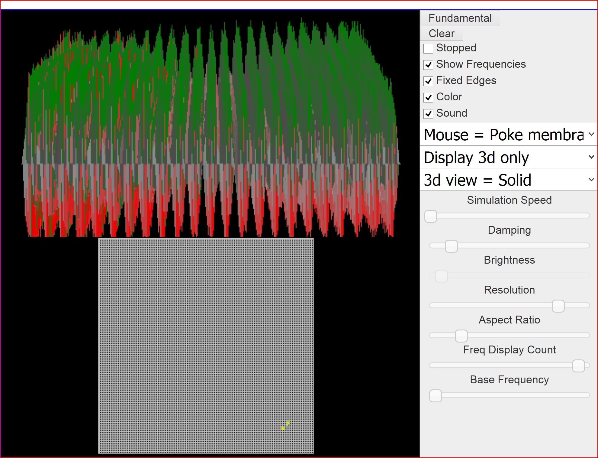

Am I right in thinking your considering high frequency resonances from a different model to Golfnut, as being boundary membrane reflections rather then air wave back reflections?
Like this fun visualiser?
Rectangular Membrane Applet

I did experiment with eliminating boundary reflections (to a large degree, not completely). Doesnt affect detail reproduction IMHO. It seems that human hearing can still pick out the details even with spurious resonances added. Though it sounded more relaxing, like instuments on a more black background. No measurements , just my subjective experience.
Thats fascinating. I'm curious how you managed to damp the membrane boundary reflections?

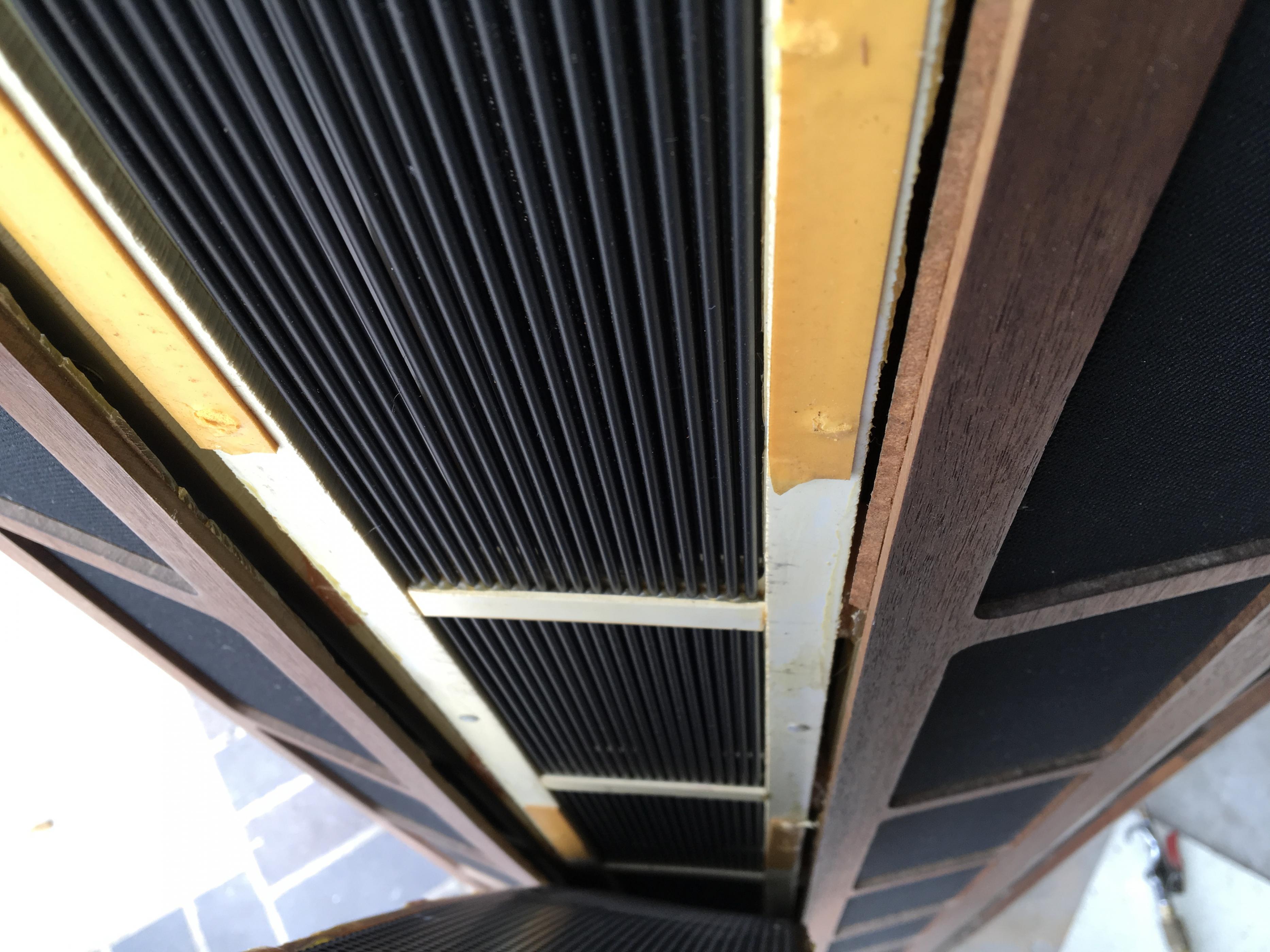

I picked up a pair of old 1980 Soundlab R-1,s in real bad dirty shape.
Pulling the wood latice/black grill cloth off, the wire stators and mylar were perfectly clean and absolutely no dust could been seen on any of the segmented strip segments. They looked like new !
Maybe this dust cover on the Quads could be illuminated or maybe its overstated too much as a worry. I get it that it affects 20k response a little

On the dust cover note
A simple stretched fabric might be enough if its tight enough and at the same time can pass 20k without attenuation
Is pcb construction vs wire that much more dust attractive ?

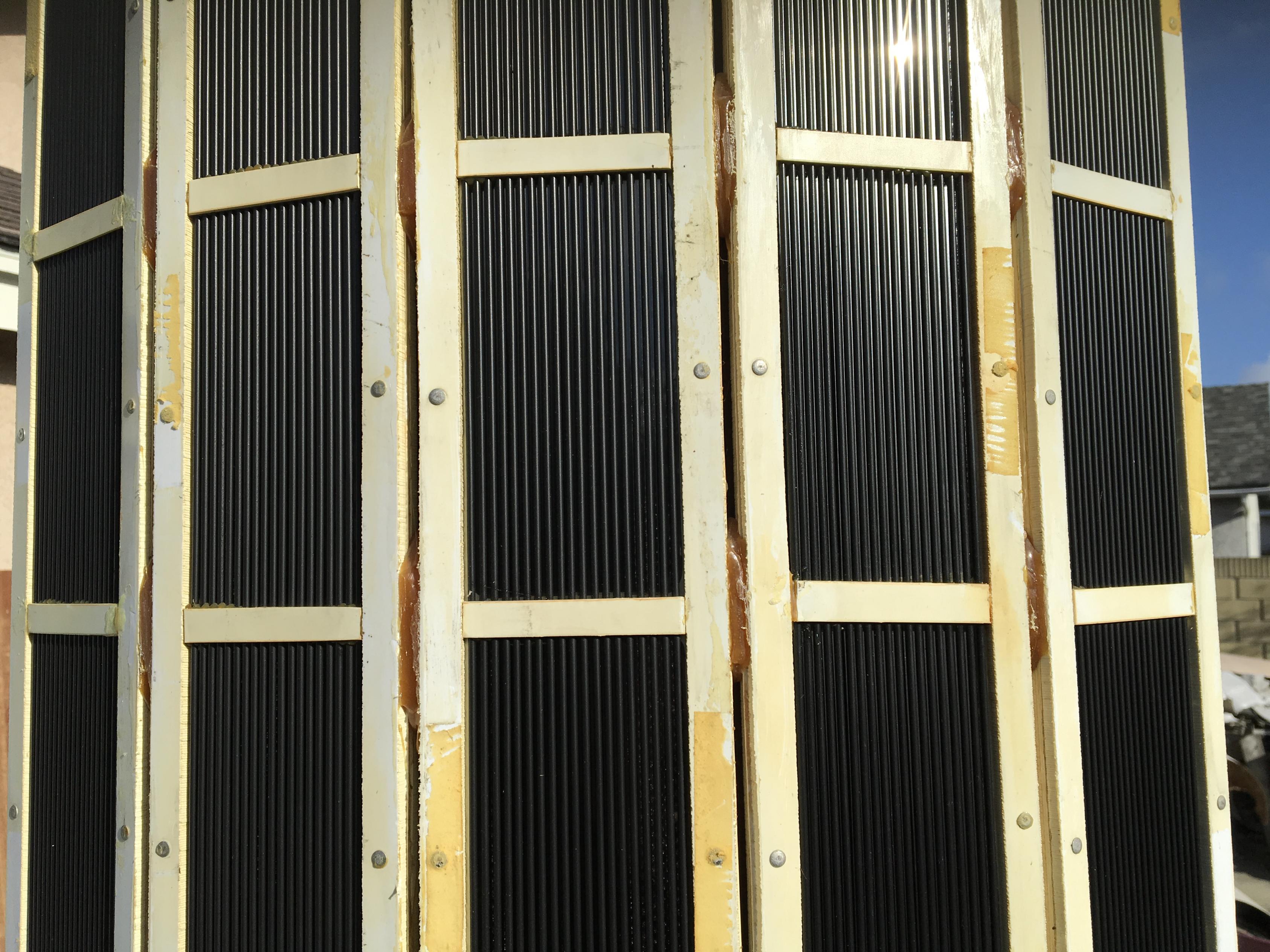

hmm funny they used hot glue and a very dull cutter for the frame :) never knew anyone would use hotlgue. i think it might work rather well to keep wires in place. i did it once years ago. but thought .,... it was to much scapbook style. but aparantly it holds well.
This was their first commecial offering I believe and well, effcient manufacturing has a learning curve for any company.
Looking at all the wood pieces, its easy to see this wasn’t the easiest way and they probably lost money on this model
Their next model did away with all the wood lattice pieces for good reason.
