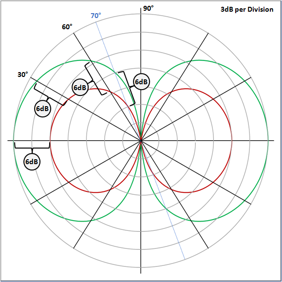

Forgive me if this has already been sorted out, but I didn’t see resolution of this topic in a scan of recent posts.
Only at 90 degrees off-axis from an ideal dipole piston will the pressure from the front and rear of the piston be equal and opposite and cancel. At all other angles, the different propagation path distance results in the phase difference being something less than 180 deg for low frequencies and will not cancel. This is what gives rise to the dipole figure-8 radiation pattern you referenced. Phase difference is minimum on-axis(peak SPL) and trends toward a maximum of 180 deg at 90 deg off-axis(Null). If the output is increased be a factor of 2, the SPL at all angles(except 90deg) will increase by 6dB. See Attachment #1.

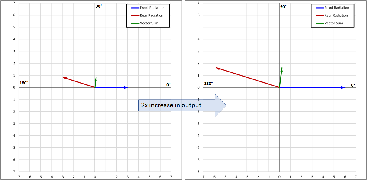

Since your comments were in terms of summation of front and rear radiation, consider an example with a 30cm diameter dipole piston driven at 100Hz and an on-axis listener. The phase difference between the front and rear radiation would be about 165deg. Attachment #2 shows vector summation diaphragm for this example. On-axis summed SPL @ 100Hz is about -12dB lower than for the same piston in an infinite baffle.
  • As frequency decreases the red vector will rotate closer to 180 deg, and the summation vector will get smaller by half for each halving of frequency. (ie -6dB/oct slope)
  • Similarly, for a given frequency as listener moves off-axis the red vector will rotate closer to 180 deg. (ie dipole radiation pattern)
No matter how low the frequency or how far off-axis you get(<90deg), increasing the output by a factor of 2 will increase the vector sum by 2x (ie 6dB) which is the SPL the listener hears.

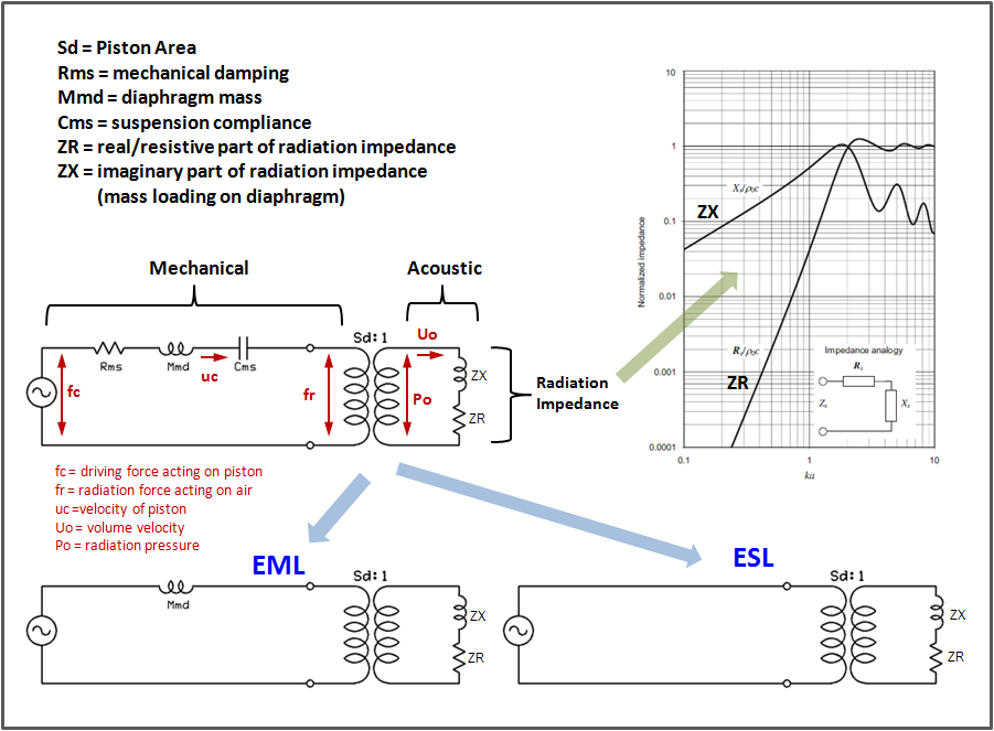

Only at the lowest frequencies (more than octave below resonance) does the linearity of the suspension dominate control of the cone motion. For the octave around resonance, damping is dominate. Damping in the EML is provided by the motor. Above resonance the motion of the cone is dominated by the mass of the (cone+voice coil). Since mass is constant, only the motor linearity comes into play. When trying to get an image in your mind of how EMLs and ESLs differ, focus on what controls the motion of the piston(cone for EML, diaphragm for ESL) over the majority of the working bandwidth. With EMLs it is piston mass which is constant. With ESLs it is the airload on the piston which actually varies considerably with frequency.
Consider the attached mechanical/acoustic analogical model for a dipole transducer. This is an impedance analogy where voltage represents mechanical force or acoustic pressure, and current represents mechanical velocity or acoustic volume velocity. Again, if we stay focused on the majority of the working bandwidth, the only real difference between the EML and the ESL is the piston mass of the EML represented by inductor Mmd. Note that fc is constant(ie frequency independent) for both transducer types if driven by the typical voltage source amplifer.
  • For the ESL, constant motor force (fc) results in constant radiation force (fr), and thus a constant pressure (Po) applied to the airload (ZR+iZX).
  • For the EML, since F=ma, constant motor force (fc) results in constant piston acceleration or velocity (uc) that falls -6dB with increasing frequency.

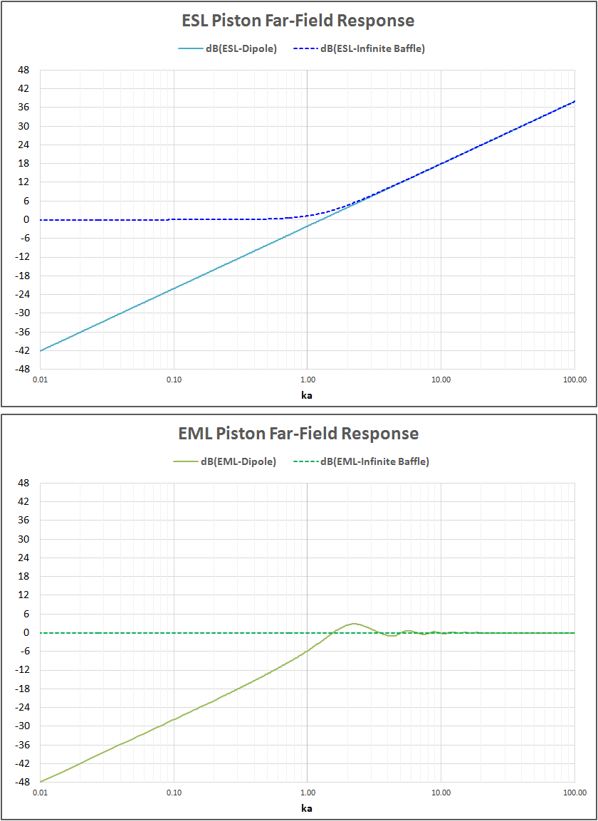

Attachment #2 shows the resulting far field on-axis response for EML and ESL operated as dipole pistons, or when placed in an infinite baffle. Let me know if anybody is interested in more details on why they behave this way or how you get these response from the model discussed above.
***NOTE: ka=1 represents frequency for which piston diameter is roughly 1/3 wavelength.
In #2, note EML in a large baffle is potentially capable of flat on-axis response across ka=1
Plain Constant Charge ESL can't do this under any practical loading condition. For flat response, you need to invoke Walker/Baxandall ie the CCESLpWB 😎
Of course this only addresses on-axis response but if this isn't flat, you already have serious problems. Along with flat on-axis, you want response off-axis to be sorta flat too ... or at least falling slowly & smoothly. This implies 'flattish' power response across ka=1.
