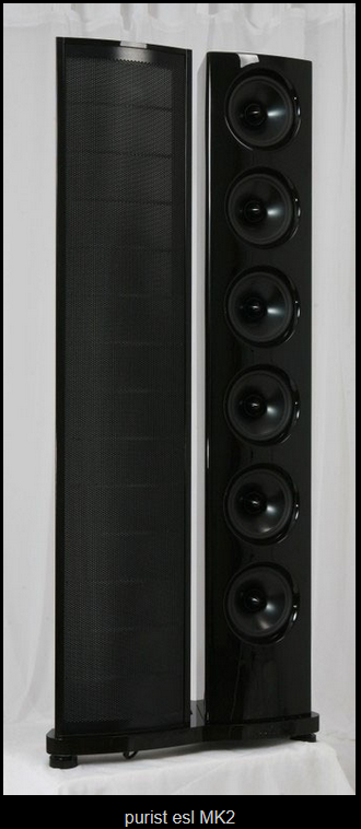

Are you talking about your hybrid configuration of an ESL line source crossing to a line array of dipole woofers?…That is almost exactly what I did with my ESELs ... apart from the 2 8ves response (could just achieve 1 8ve) and guess what? .... they sound absolutely awesome with no audible transition between the branches 🙂
This certainly was the most seemless sounding hybrid configuration I have experienced for line source ESLs crossed in the 500Hz – 150Hz range.
purist esl MK2 - calvins-audio-pages
