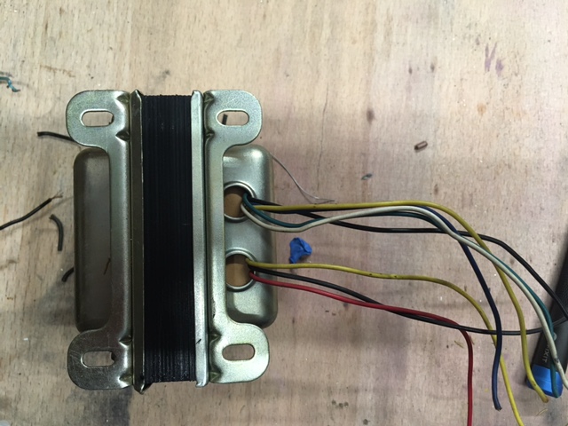

I remeasured the OPT backwards at the 8 ohm output, as suggested and the calculated impedance is 7.192k --> ((188/6.27)^2)*8

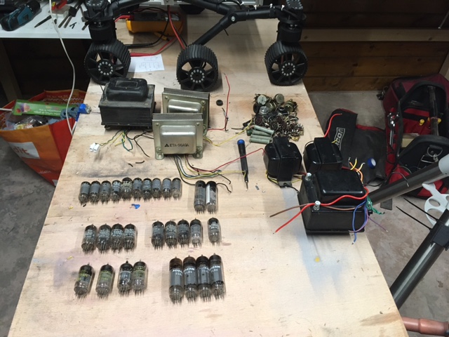

I'd indeed like to reuse as much as possible from the tubes and transformers. as those seems to be the most expensive components. All passive's I will replace as they tend to drift a lot over the years, and caps will probably have dried out. Btw: the amp was definitely not working when I got it (burned up resistor right before the output, so a non functional Tube is a possibility 🙁

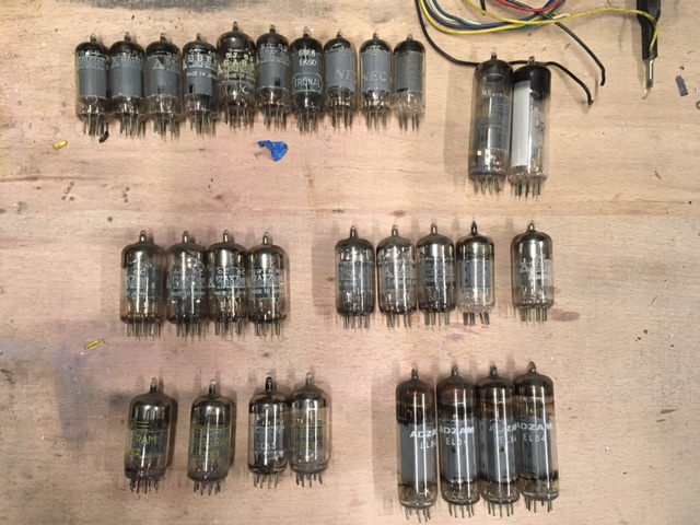

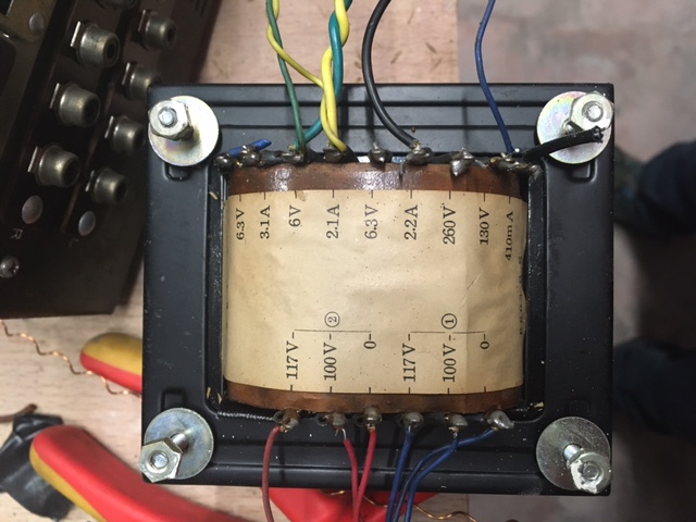

So here is the list of components I have and hope to use:
Power transformer (Pri: 2x117V; Sec: 6.3V@3.1A, 6V@2.1A, 6.3V@2.2A and 260V@410mA with center-tab)(picture included)
OPT(7.2K Pri: center tab, no tabs for UL; Sec: tabs for 4, 8, 16 and 32 Ohm)
Tubes: 4 EL84 tubes and plenty of 12AU7, 12AX7 or 12AT7 to choose from
I have no rectifier tube, so preferably silicon diodes 🙂
I'm willing to do some recalculations if needed, but need a proper design to start from that fits those components, and maybe some pointers to what wil need to be recalculated 🙂
If the OPT's really have a 32 ohm connection, you could test the voltages between 0-8 and 8-32 and if they are equal you can try anode feedback, ut that makes everything a bit more difficult. But maybe better.

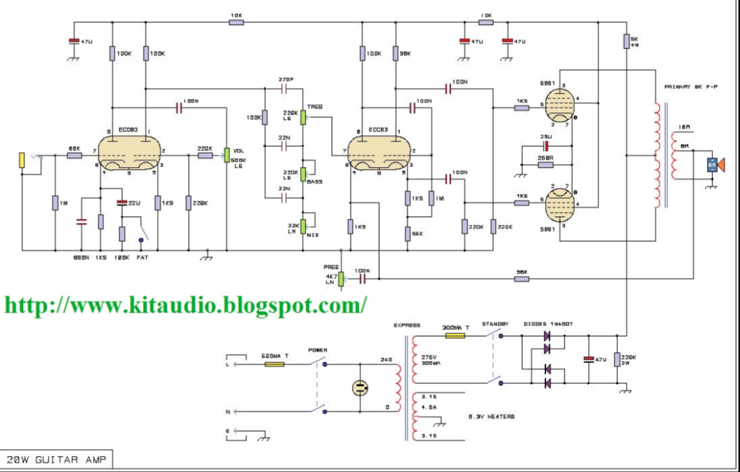

I found this schematic online that pretty much seems to match what I'm looking for (also in terms of Power transformer, but for an 5881 tube)
I recon I can replace the 5881 with EL34s. need to recalculate the biassing though.

The 260V outs can be put thru silicon bridge rectifier, then to PI network w/ coil separating big caps to give stout 360ish B+ with enough current to wake the dead.
Not sure about all those 6V outs... need some, but not all.

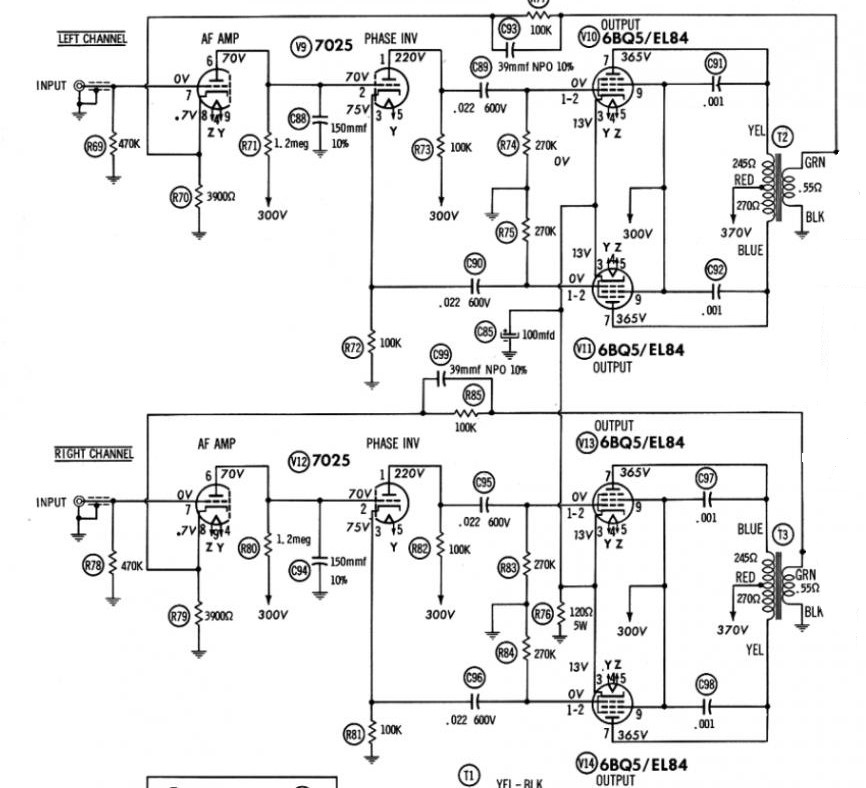

So for diagrams, I found this (attached)...
EL84 (6BQ5) PP w/ dual triode utility (7025)-- which I think you can sub your 12AX7's into... Not too complex for first endeavour, IMO.. and no UL taps required.
I recon I can replace the 5881 with EL34s. need to recalculate the biassing though. I have enough information for now to continue I think.
Thanks to everyone who contributed already. Once I'm a bit further along after a simulation or so I might ask some more questions 😀
I think you may only need the last two stages of your schematic. The first stage may give you too much gain. Depends on the global feedback. You could also consider using the outputs in triode and dropping the negative feedback. Should give you a decent amount of power. I think you're on the right track here - 5881s will give you a variety of options for future mods. Plus if you make larger holes in the chassis you can fit 9 pin sockets in octal holes but not visa versa. Drivers too - 6SL7 is often used in place of ECC83.
If you're using a new chassis make sure it's big enough. You may want to move up to some nice parts that are bigger then the standard ones. Thinking of capacitors in particular.

Sound advise, I would go for that setup.I found this (attached)... Not too complex for first endeavor.
Furst of all stop with that EL34 idea.It's not that the OPT is Raa=7k it is up to more power from bigger tubes.
Your schematic is for a guitar-amp, to sensitive input and that tone control 🙁
The oemcar one has missing stop resistors.
And both have a common cathode resistor
Every tube his own cathode resistor + decoupling capacitor !

Yes, about 7 kOhms isn't exactly what all EL84/6BQ5 datasheets call for the PP plate to plate impedance. But it isn't that far off. The difference even may take account for the ohmic losses in these OPT's. I guess (you didn't answer my specific question yet 🙄) that all four EL84's and both OT's were in the same unit before? Which would mean that it works!
Go for the schematics shown some postings above, but replace (as Mona suggested) the common cathode resistor by individual resisotrs/capacitors for each tube. Or, even better, go for fixed biasing.
