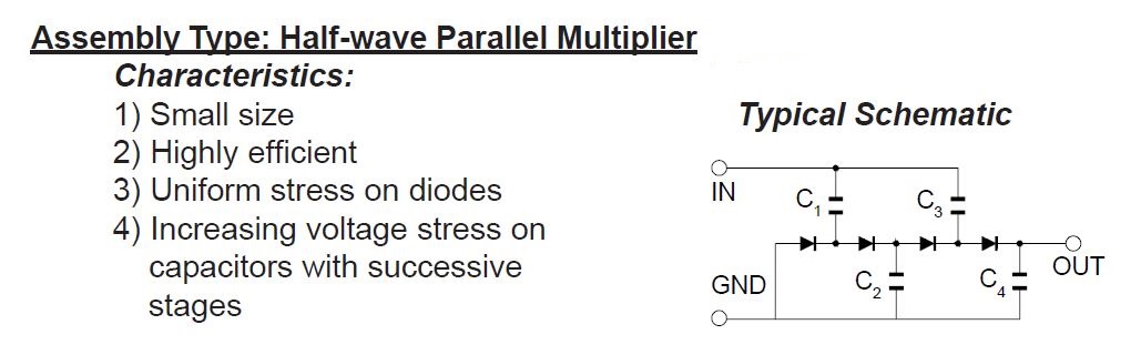

Possibly a hybrid bridge rectifier might be a solution to get into the working range for an EL84 tube amp?

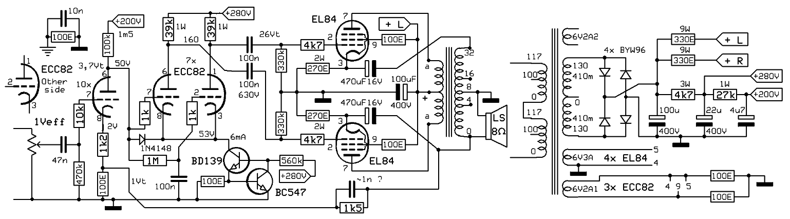

With the OPT having 0-4-8-16-32Ω out it's possible to ground the 8 an use the 0 and 32 for cathode feedback.
With the extra 8Ω winding in the tube anode-cathode circuit the Raa goes up from 6k7 to 7k2.
Series resistors to lower the supply voltage and a phase splitter capable of an output of somewhat over 50Vpp it could become a nice amp.

FWCT rectify the B+ with 2X UF5408 diodes. CLC filter the B+. A low cost Triad C-14X will do quite nicely.
1/2 parallel voltage multiply 1 of the spare 6.3 VAC windings to obtain a negative bias rail. Use individual bias trim pots. on O/P tubes whose matching is suspect.

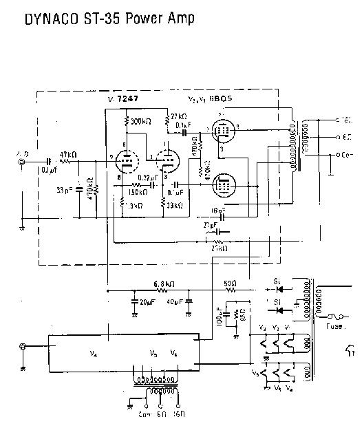

The Dyna ST-35 provides a straight forward signal topology. Use a 'X7 section for the voltage amplifier and a 'U7 section for the "concertina" phase splitter. The ST-35 uses self bias, but changing to "fixed" bias is NBD. As the "National" O/P transformers lack ultra-linear taps on the primary, full pentode mode will have to be employed.
Open loop linearity of full pentode mode is maximized, when screen grid (g2) B+ is regulated at some fraction of anode B+. I suggest you use 0A2 ("150" V.) gas discharge tubes (1/channel) to regulate g2 B+. I also suggest the O/P tube sockets be wired for the Russian 6Π15Π (6p15p). Sockets correctly wired for the 6Π15Π accept EL84s, without incident. 😉

But after some time you have to start making decisions, so I've decided to retain with an EL84 design (initially self biased) and to start with them in triode with a 30ma current bias. If I destroy a tube, there are very affordable versions of the EL84 so easily replaced.
For the power supply I recon I can unwind some turns from the PT to get a lower voltage, say 230VAC so I'll end up at around 320VDC minus the losses of the OPT will get me somewhere around 300VDC which will be ok for these tubes. I'm aware that once done I cannot go back, but If build a new amp in the future it will use all new OPT and PT so I think no harm done.
I'll end up with something similar to an ST-35 with that. If it doesn't work I'll be probably be buying a new power transformer anyway.

Thanks Eli,
According to this http://www.thehistoryofrecording.com/Manuals/DynaCo/Dynakit_ST35.pdf
there is indeed 370VDC (to chassis) on the tube. Va-k is 356.5VDC
So you think these tubes will survive that?
