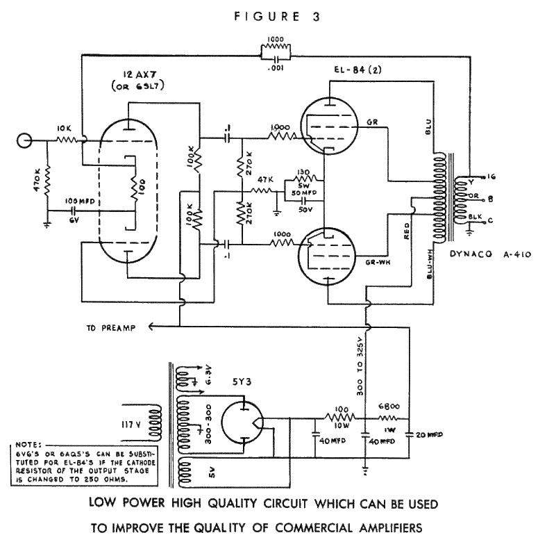

If your OPTs are truly 6.6K then you need to decide whether to get new 8K OPTs for EL84s or use a tube more like EL34. I imagine it's cheaper to keep the OPTs. I'm assuming that 6.6K is a little low for an EL84.
the 6,6k OPT is what came with the amp I disassembled which used EL84 tubes. I'd like to keep the OPTs if possible as new ones will be somewhat more expensive. I'd like to keep the cost down a bit for this one, just to see if I get the hang of it.
I found this schematic online that references EL84 tubes in stead of 6v6 tubes and uses the same PP approach as the original amplifier. Would this work by just swapping out the 6V6 tubes with EL84's?
The only issue I currently see is that the output voltage of my power TF is a little higher than 238VAC mine is at 260VAC. would that pose a problem?

Your mains transformer isn't a problem - you can use the size of the first capacitor to determine the output voltage. For 260AC you'd get say 230-240v with no cap and choke input (you have a choke?), after which you go up something like 2uF, 4uF, 6uF, 8uF and the output voltage will rise accordingly up to maybe 300v. You are using tube rectification or solid state?
Your operating point will be more like 250v, 34mA, -9v in triode which is what Mullard suggests. However the Ri is 2K which is a bit high for a 6.6K PP OPT. Mullard suggests 10K. Have a look through the data.

The data shows that a 6.6K OPT is suitable for UL (ultra linear) operation but for that your OPT would have to have UL taps, i.e. there would be 5 wires/lugs on the primary not 3.

Ok so if I understand correctly: If I want to keep the OPT's I need to go to other tubes e.g. EL34. Or if I want to keep the tubes, I need to go for different OPT's
I think i will go for option 1, keep the OPT's and change the tubes as I don't really know if the output tubes all work. The transformers are functional.
Would the schematic I posted in #23 be adaptable to EL34 tubes then? as it seem feasible.

There's nothing wrong with 6.6k OPT for a pair of EL84. It might be not perfect, but it's more than acceptable.
260VAC on the PT will give you 330-350VDC depending on the capacitors value and the choke's DCR (actually you can deliberately use cheaper high DCR choke to drop the B+). Avoid choke input filtering - you'll need pretty special choke for that, "general use" ones won't do. The PSU in the post #23 is kinda OK, but go for 450V capacitors for your PT.
Pentode-configured output stage without some sort of NFB isn't good for most modern speakers, and adding the NFB correctly requires some knowledge and equipment. I'd suggest going for the triode mode for the EL84. One good example of the triode-strapped EL84 PP output stage is the John Broskie's amp, though I'd personally would go for individual EL84 biasing and slightly higher quiescent current (680..750R+100uf for the each cathode instead of those 400R+1000uf common ones). You can actually use 12AT7 instead of 6N1P for this particular design and still get good results.

Probably full-pentode with GNFB then.
You can build pentode ST-35 variant indeed using half of the 12AX7 as the first stage and the half of the 12AU7 as the second one instead of those 7247s.

No, need some (little) changes.And the input sensivity goes up.I found this schematic online that references EL84 tubes in stead of 6v6 tubes and uses the same PP approach as the original amplifier. Would this work by just swapping out the 6V6 tubes with EL84's?
