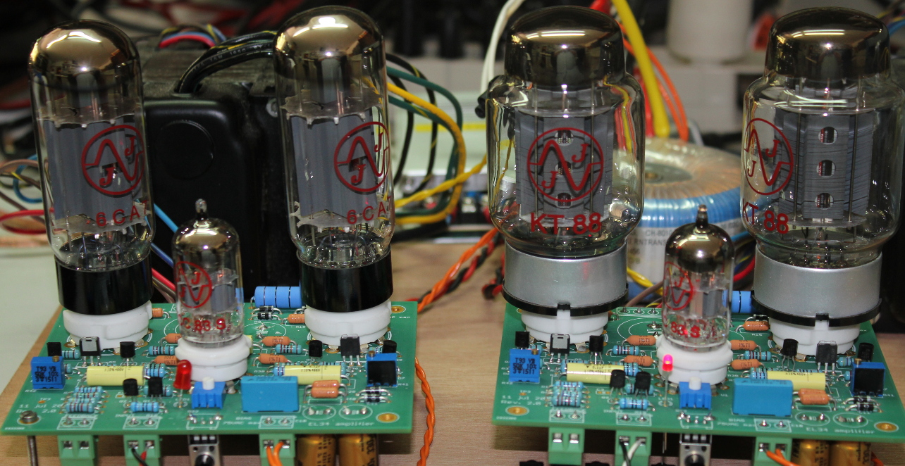

Regarding output tubes it is really dependent of the preference of each one, personally I have been very impressed by the sound of the amplifier with the 6V6S and the 6CA7, both new production from JJ bought at Banzai Music GmbH I haven't tested the 6550 on the Baby Huey (because they are on my Jolida JD-502B) but I tested the KT88 on one channel and I have preferred the 6CA7. I have also used the same KT88 on my Jolida and I also preferred the 6550... The KT88 were also from JJ while the 6550 were from Sovtek !
I have also read in a review of the Jolida that the KT88 are fragile : "This axiom proved to be true, alas, with the KT88's. The '88's, it turns out are fragile tubes, and are often damaged in shipping. On two occasions, I experienced failure of KT88's. The upside of this is that I experienced firsthand the durability and reliability of the JD-502B: nothing major or catastrophic, just a change of the line fuse and a tube change and everything was up and running again. According to Mike Allen, the internal structure of the KT88 is quite fragile, and if a set of tubes survives the first 30 days of use, they should last years. While I loved the sound of the JD-502B with KT88s, I couldn't live with the reliability issue of the KT-88's and substituted a set of Sovtek 6550's for the remainder of the review, where they performed flawlessly."
May be the KT90 or the KT120 could be a solution, but I don't believe that this architecture is for a very high power amplifier with more than 500V plates voltage, may be I will design one later with a quad output like the Norman Koren "TENA amplifier" ?
I have read from a builder of the first batch of PCB that the KT66 is a good candidate, I have not bought this tube yet, but I may try it some time. Tung-sol version seems to be very good : www.thetubestore.com - KT66 Tube Review

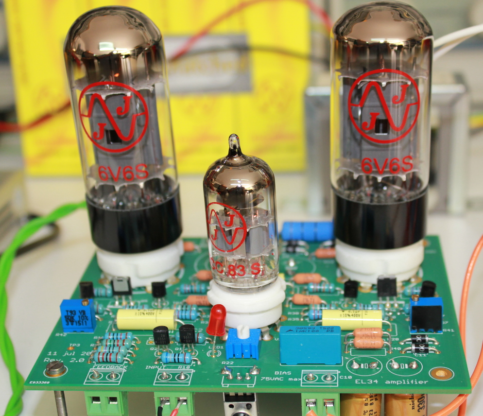

You can build the amplifier with the tubes on the top, I have mounted only the low profile components on the top side, but it is also possible to put all components on the bottom side, but be carefull with the transistor orientation! The power dissipation of the 4W resistor is not very high if you are using a 10 ohms, if you prefer, you can mount it on the bottom, you can even connect a 5 to 10 Henry choke for a C-L-C filter.
C1 and C2 can be any value higher than 0.1 uF 400V, the 0.22 uF I had were 630V and were too big to fit on the PCB, that's why I used the 0.1 uF. Again you can choose what you prefer, or what you have 🙂

You should really try the Electroharmonix line of tubes. Better than JJ. I haven't had any KT88 failures yet for several brands that have been shipped.
If you try the KT66, also try the 7581A. Similar tube, same plate dissipation, but it has the same characteristics as the 6L6GC. The KT66 differs a little. Interestingly, the Electroharmonix 6L6EH plate structure is much like a 7581A, and I have used these tubes (6L6EH) in tough situations - like Fender Twin amplifiers, and they work well with no hint of overheated plates.

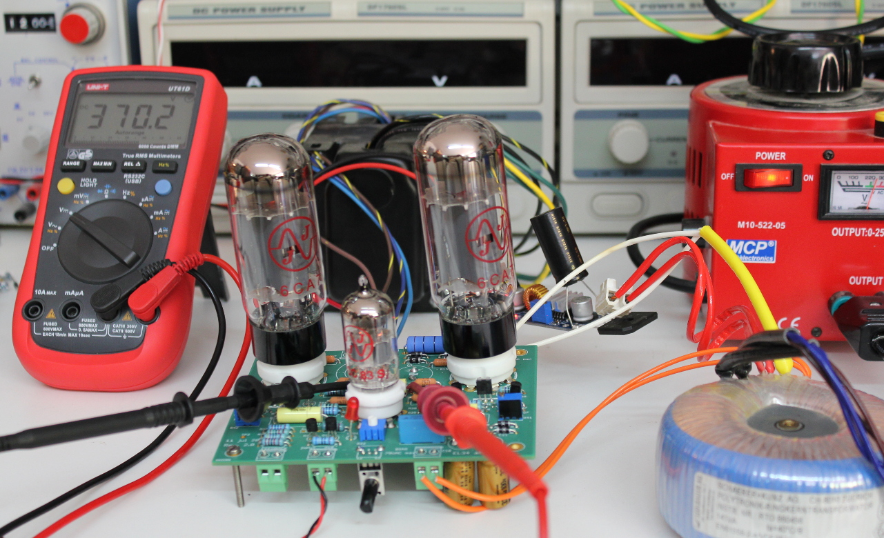

As you can see on the pictures below this PCB can be used with 6CA7, KT88, 6V6, or many other compatible output pentode or tetrode tubes...

So I am in the group buy and now looking at a parts list. For those more knowledgeable in tubes than I, would this transformer from Antek be suitable? AS-2T230 - 200VA 230V Transformer - AnTek Products Corp It appears the 6.3vac secondary would handle one mono amp. A pair of these if ok to use could supply plate and filament voltages.
Hi dpro,
Yes, 250 to 275 V will be perfect 🙂
You have to be careful however because 275 V will give (275 x 1.4) - (0.7 x 2) = 383.6 V DC close to the 400 V limit of the recommended electrolytic capacitors ! If you want to use higher voltage I would suggest 450 V capacitors...
