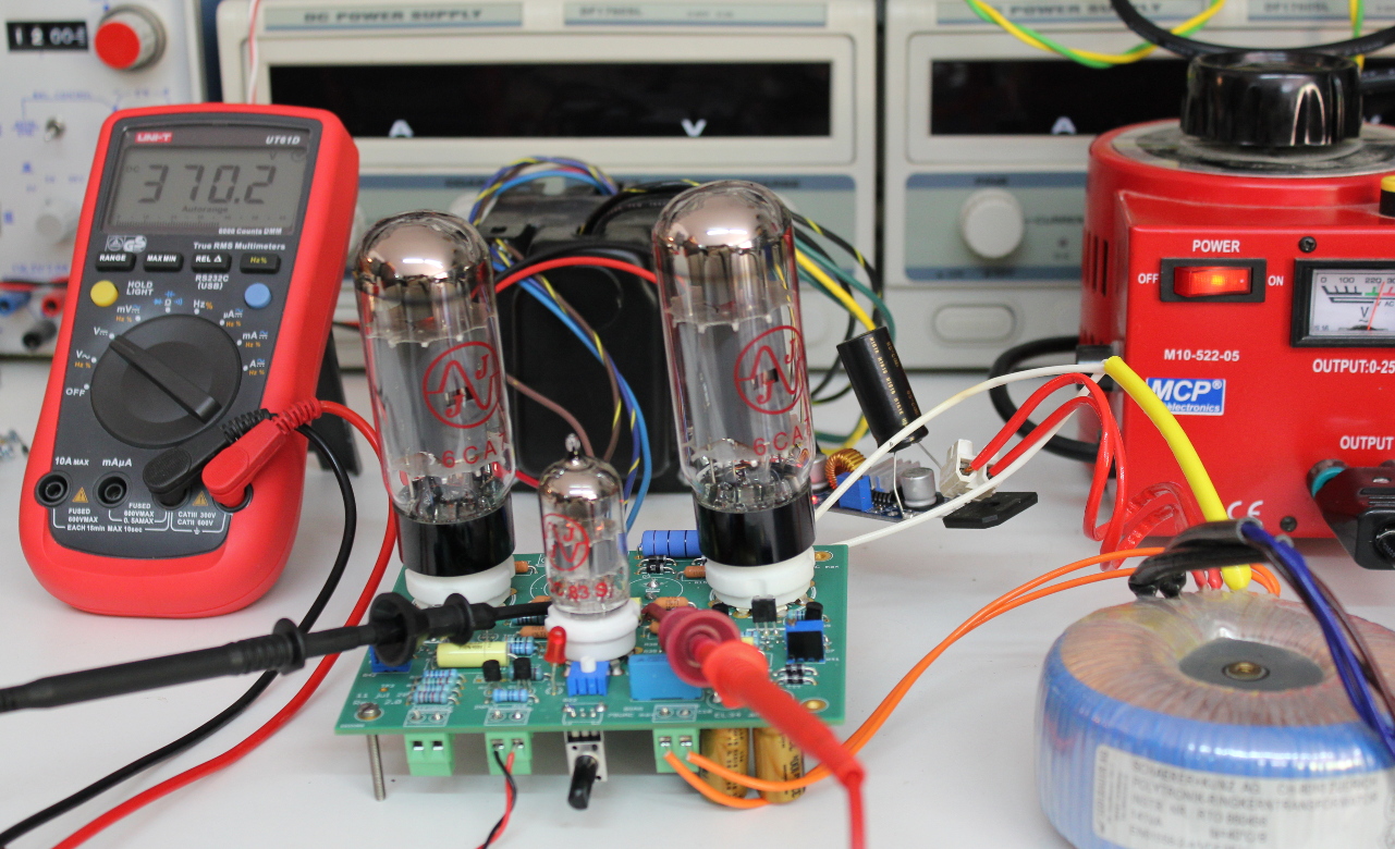

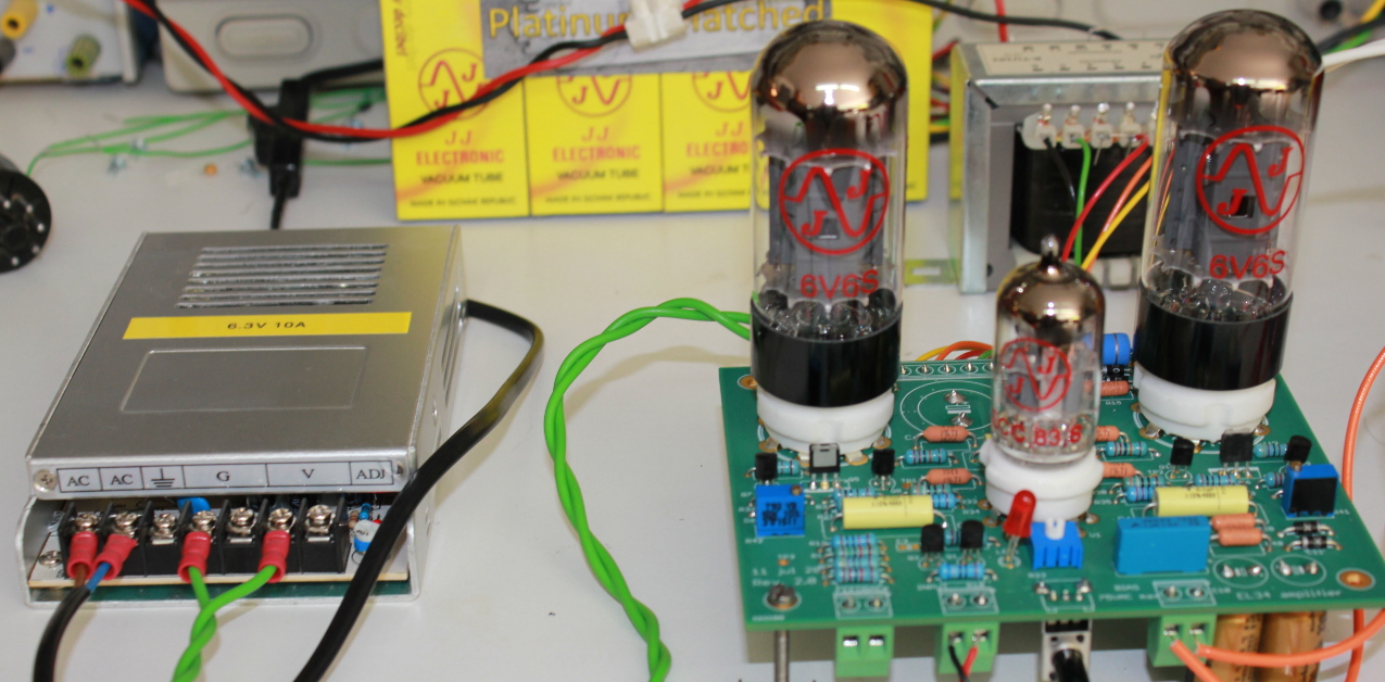

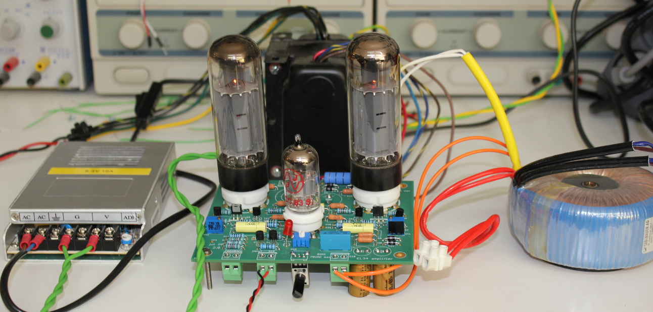

Yes, the 6CA7 is a beam power tube and they are bigger than the EL34 as you can see on the photos. I am listening the 6CA7 while I write this 🙂
I have also tested the 6V6 which is less powerful than the EL34, closer to the EL84 amplifier made last year, but I like it because it sound sweeter than the EL84. I like this PCB because I have been able to test different output tubes while only changing the high voltage, the output transformer and the bias !
Now I have to build the second board to enjoy the music in stereo 😀

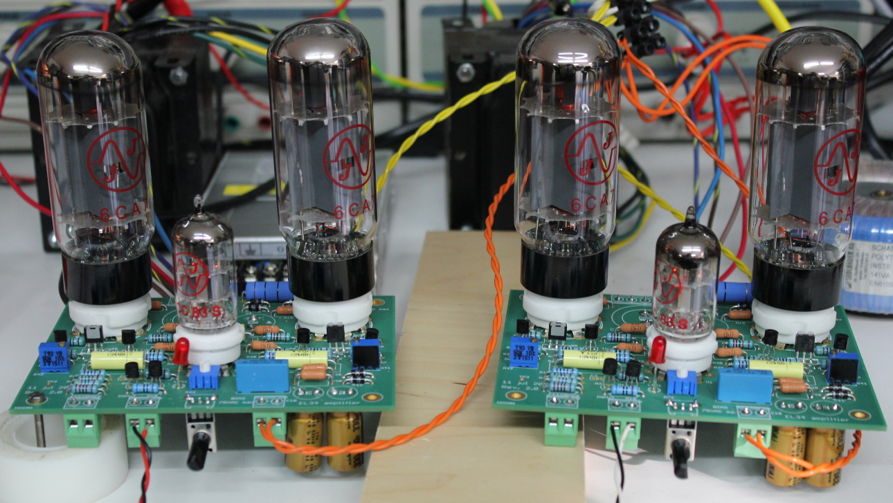

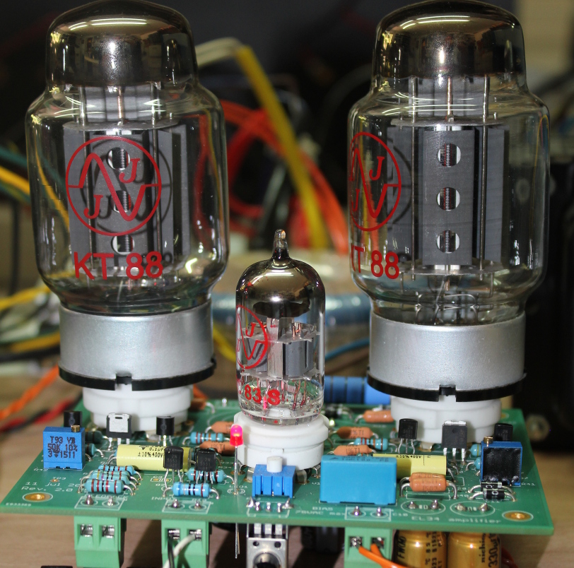

I have been quite busy recently, but I found the time to build the second channel and to test KT88 output tubes (you can see the size comparison with the 6CA7 on the photo), and they sound very good too, but like Chris, I also prefer the 6CA7 which are a good compromise between power, sweetness and finesse (it's french, I hope the English word is the same).
I am very impressed buy the Baby Huey concept : I have built ECL86 / PCL86 on the first PCB, EL84 on the second PCB, and 6V6, EL34, 6CA7 as well as KT88 on the third PCB, and all versions give good results with little or no modification beside the output transformer and some resistors values, impressive...
With this last version, I have finished my journey in the Baby Huey approach and I want to thank again Yves and Gingertube for this interesting concept and their friendly support along the road 🙂
Even if these tubes amplifier sound is very good, I found one weakness : it is the excessive cost (and weight) of the output transformer ! Therefor my futur project will be an hybrid amplifier with a tube voltage amplifier stage followed by a MOSFET output power section...

JJ's KT88 look rock-solid built, and I like their belly-ish shape. Could it be you just under-run them? Try to experiment with a bit higher quiescent, another option would be a higher OPT impedance with UL-strapped, I'm quite happy with mine operating like this.
