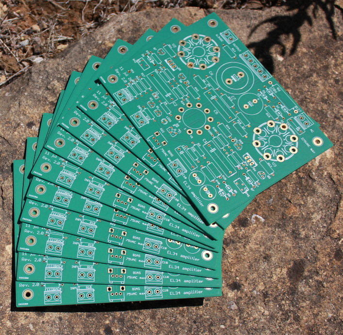

Hi Rootz,
Thanks for the suggestion to increase feedback resistors, in fact Ian told me the same things in post 1728 and I have followed that recommendation.
I agree also for the driving voltage, I answered too quickly without thinking enough 😱
If nobody find an error on the design, I will send the PCB files to the subcontractor and let you know when it will be assembled...

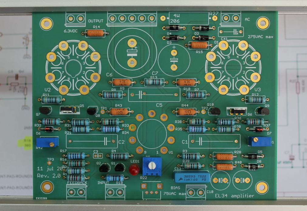

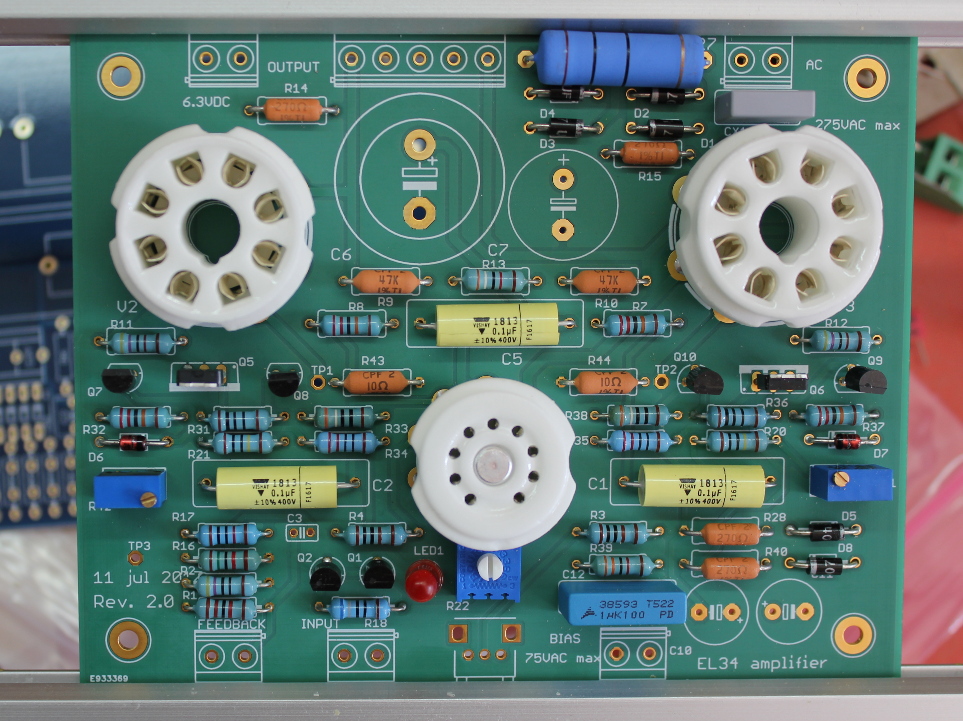

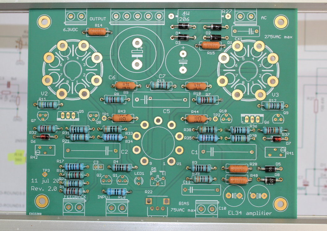

I am back after some time on the Merlin Blencowe RIAA preamplifier (see this thread : http://www.diyaudio.com/forums/tubes-valves/308369-merlin-riaa-preamp-4.html ) and while I was waiting for the RIAA amplifier PCB, I take some time to check the EL34/6CA7 version of the Baby Huey, and the break was very useful because when I came back to my design, I have found that I used a wrong library for the output tube with a bottom pattern instead of the top on 😱
Now I have corrected this and made some optimisation on the layout and I hope to send it to the PCB shop next week...
You ca find the latest version here and I will be very happy if there is no more mistake or if in case there is an other one someone find it and let me know 🙂
Marc

After spending a lot of time on the modified Merlin Blencowe RIAA amplifier and running in trouble with the power dissipation of the MOSFET source follower, going from the ZVN0545 to the STQ3N45K3-AP which is specified at 3 W but still running very hot at 200 V and will probably die at 300 V, I have decided to redraw the schema and the PCB of the EL34 Baby Huey version and to implement a TO220 pattern for the MOSFET stage.
This way I will have more freedom to select the best solution and I will buy the following devices that seem to fit the requirement, specifically for a very low Crss :
FQPF2N60C Vds=600 V, Id=2 A, Rds=4.7 ohm max, Crss=4.3 pF
STF2N80K5 Vds=800 V. Id=2 A, Rds=4.5 ohm max, Crss=0.5 pF !!!
STF7N60M2 Vds=600 V, Id=5 A, Rds=0.95 ohm max, Crss=0.68 pF !!!
I hope that one of these will give the best result 🙂 Here are the corrected schema and PCB...
Marc

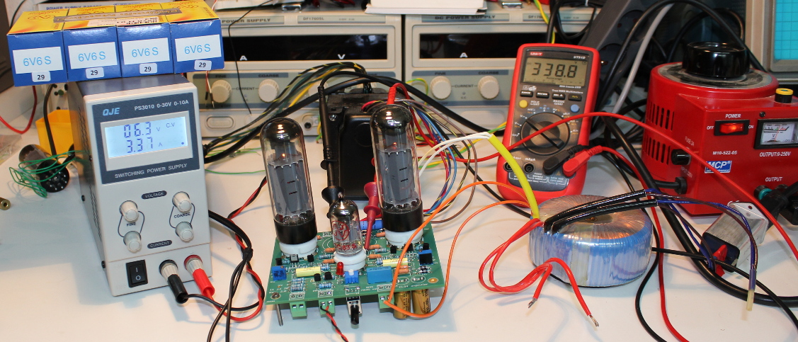

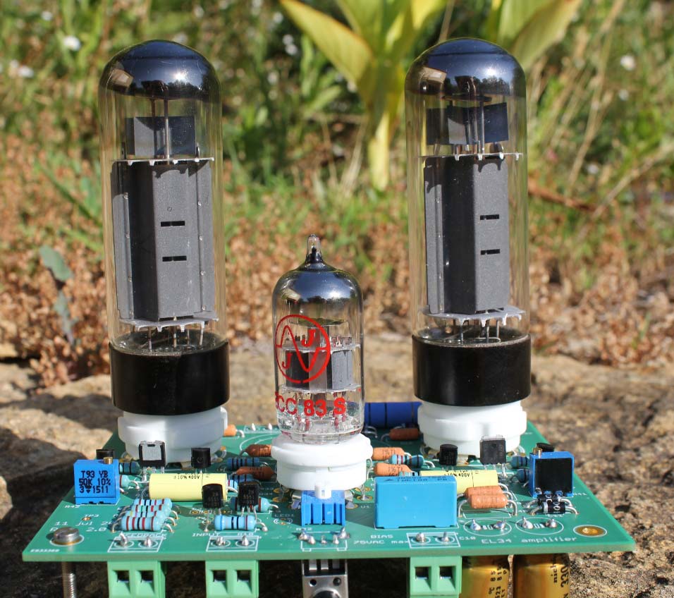

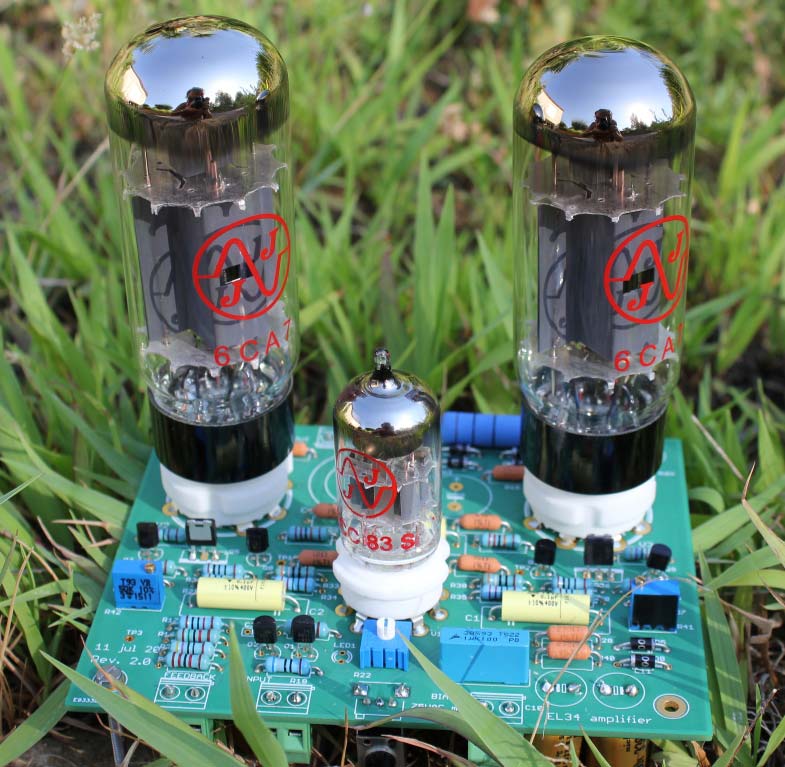

EL34 Baby Huey finisched
Now the amplifier is finished (only one power supply CRC capacitor is missing but that is not a problem for starting the test) and there you have photos with three different push-pull of output tubes : EL34, 6L6, and 6CA7 (the US version of EL34)...
So now I can test the amplifier, that is why I send the photos before I burn the board 😀
Marc
Marc
They didn't burn 😀
I have started the tests and the amplifier sound very good like the EL84 Baby Huey but with more power of course, it has a very tight control of the loudspeaker and give very good bass even with a small speaker (I am sorry if I can't explain it very well but English is not my first language).
When I started the test I found that the bias was too high with more than 2 V on the 10 ohms cathode resistors which mean more than 200 mA and the max spec for the EL34 is 150 mA 😡
When I try to reduce the bias with the trimmer it didn't change ! I measured -3 V on the grid instead of -16 V ? Therefor I checked all the -50 V circuitry and everything was OK ? I finally found the mistake : the trimmer and the test point were switched, that mean that when you change the adjustment on the right trimmer you must check on the left test point 🙂
After I had found that I could correct the bias to 90 mA for both tubes... Nothing to worry about or to change on the PCB, but just something to remember... I have also adjusted the balance between the two input triodes with less than 1 V difference between their plates at 160 V. No problem with the MOSFET they are not warm.
For the test I have used some old EL34 and they survived to the high bias without any problem. Now I have to build the second channel...
