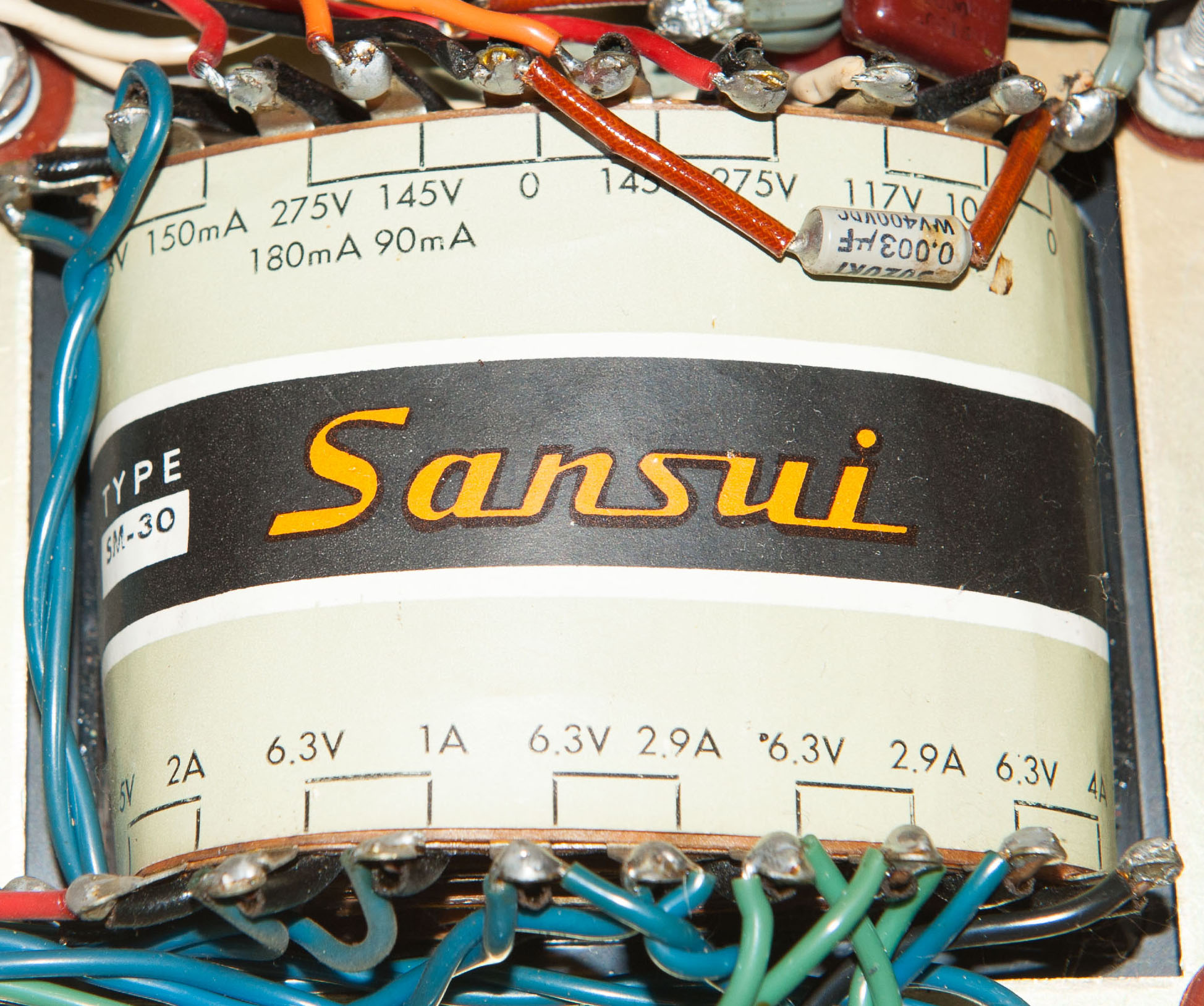

Here is my next question, The power transformer that I'm planning to use has a 275V secondary winding.
Can I just adjust the 220K ohm and the 47 Ohm resisters to dial in to the 300-330V B+
or would it be better for me to try and use an additional 38V secondary in series with the 275V
( the 38V 150mA tap is a bit hidden behind the blue wires in the photo).

Just Use the 275-0-275.
That will give a B+ which is a bit high (probably around +350V to 360V).
The 47 Ohms resistors were reduced to 4R7 which is noted on thread somewhere. Not sure which 220K you mean but it won't affct the B+ (which ever it is).
I am assuming that you are building the basic BH with the CCS Bias blocks on the output tube cathodes. For that higher B+ then change the current set resistors in the Bias blocks from 16 Ohms up to 22 Ohms. That will set idle currents to 29.5mA and keep output tube dissipation within limits.
The tranny rating of 180mA is a little light but should be OK.
Ian

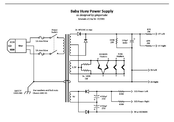

I'll change my schematic to reflect the 4.7 Ohms on the B+ and 22 Ohms in the bias blocks.
Here is the schematic of the power supply I'm using and where the 220K resistor I'm referring to. It is the resistor in the RC circuit of the B+.
Is the schematic not the current one?
-Brad
Hi Brad,
That is the current schematic, except for the change of the two 47 Ohms to two 4R7.
The 220K is just a bleed resistor so you don't get nasty surprises when you power off and then go working on the amp. It discharges that 220uF filter capacitor.

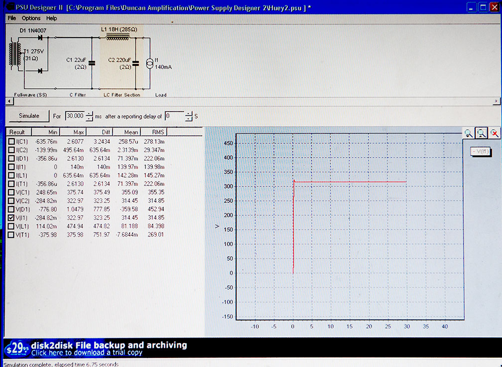

Would my power transformer having higher B+ and lowish amperage be suited for using a choke filter? I have a 18H, 285 ohm choke out of a Hammond tone cabinet. When I run the simulation it puts the B+ at 315V .
-Brad
What is the current rating of the choke?
If 200mA or greater then OK.
On PSUD do a step load change after say 2 seconds from 140mA to 200mA to see what happens when you max the amp volume.
Ian

I don't have the specs on the choke other than the resistance and inductance. I found the schematic online and to me it looks like it was originally used with about 50mA going through it, I will nix the choke idea.
On the BH power supply schematic you have the separate 4.7R voltage dropping resistors after the capacitor filter going into each channel.
Is the use of 2 resistors done primarily to reduce the wattage size that would be needed? Can I just increase these resistors and get the B+ down closer to the 330V you recommend? By my calculations using 330 ohm 5 watt resistors in each channel would get it close.
-Brad
The 4R7 resistors were just to provide a little separation between the supplies for the two channels.
Don't obsess about getting the B+ down too much. 350 or 360 V would be OK.
Tube circuits are +/- 10% at best on any parameter you care to pick.
Ian
