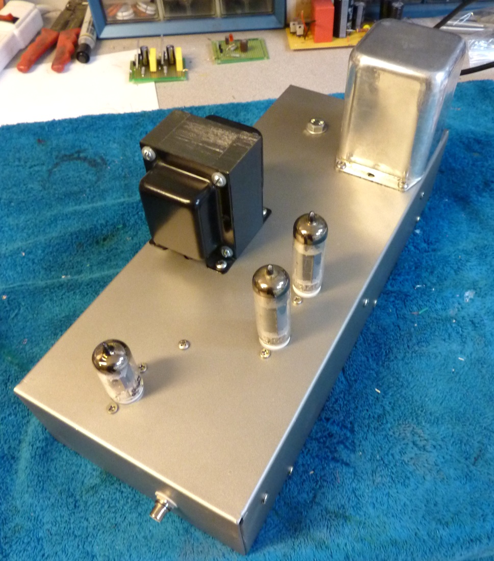

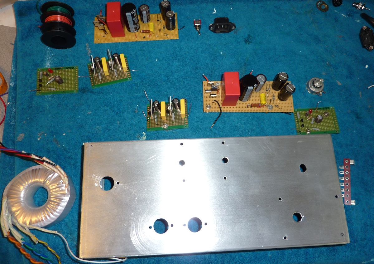

I have built the sub-assemblies for the BH amplifier. I'm making it 2 monoblocks with (I think) beefy CLCR power supplies. I've scouring this 152page thread for helpful tips.
I have a question about the PS for the CCS at the input tube. The schematic shows the positive ground is supposed to go to "0V at ECC803S". Does this mean grounded near the input tube? Grounded on the CCS board? Likewise with the CCS itself. Where are these supposed to ground? Surely they connect to other grounds indirectly.
I am using the schematic on the original pages. Picture shows one aluminum chassis, toroidal PT, PS board and small Bias and CCS boards.
I have no Vol pot so will ground input jack with 100K R.
Thanks, cheers

Yes connect to 0V near the input tube. At the 0V end of R2 and the volume pot is ideal.

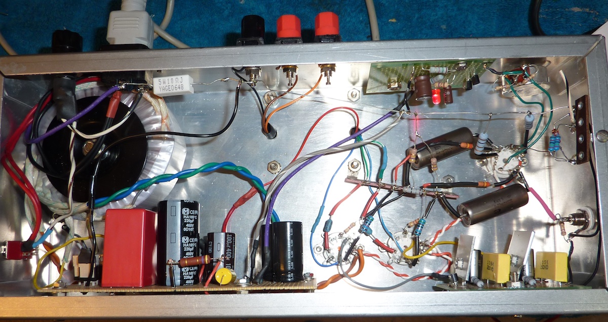

Here's one of the BH monoblock amplifiers - just completed and tested. Triode Z-565 OPTs. Antek power tranny. The silver box on top is a Stancor 5Hy choke from 1948 Scott amp.
Sounds very good. 325VDC B+

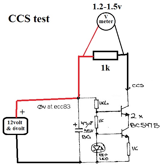

Hi all, Is the correct test for the constant current sources as per the attached drawing? Sorry to bother you with such a basic question but mine don't seem to be stable in relation to supply voltage variation so I must be doing something wrong. Thanks.
