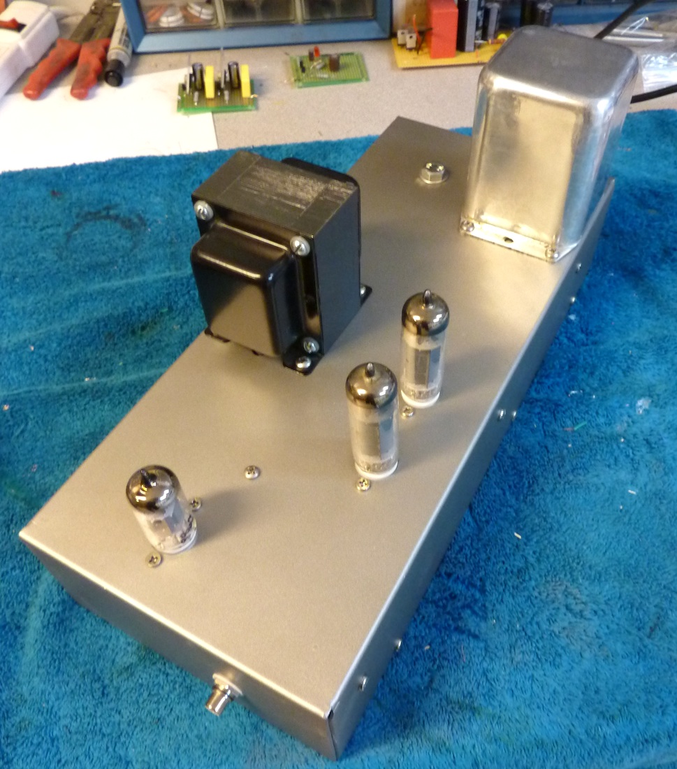

My Baby Huey is broken
After functioning (and sounding) just fine for the last 10 months, all of a sudden this evening one channel started squealing. It sounded like a cross between fingernails on a blackboard and breaking glass. It had just been loping along with the radio playing at low volume. I immediately killed the volume - the noise continued - and then I killed the power switch. As the voltage dropped away the general screech resolved into what sounded like a tonal of something like 5kHz. I've got no idea what harmonics were there too, but it's probably not diagnostic anyway.
Nothing smells horrible, there was no smoke and I can't see any signs of damage. The fuses didn't blow in the few seconds before I shut it down.
Is this how valves normally fail? Is it some other "obvious" thing? I changed the Mullards out for Genalex about 8 weeks ago when I replaced the output Hammond 1615 transformers with James 6228HS, but there has been no problem 'til now.
Since this is my first tube amp, it has now become my first attempt at fixing one. Any advice on the most effective diagnosis strategy would be very welcome. Thanks

Hi psupine,
One of the advantages of building your own amp is that you stand a good chance of fixing it yourself 😀
I would remove the valves taking note of which socket they came from. Power up the amp and measure the voltages at the pins of each socket with respect to ground. This can be done from above. Look for a significant difference in voltage ( 10% ) between the good and the bad channel. If nothing significant is found then I would check the valves.
With the power off put the valves from the good channel into bad channels sockets. Power up being ready to turn off imediately if the bad sound returns. If all is well then it's likely you have a faulty valve.

psupine,
As a first step - Swap all tubes from one channel to the other. Check if fault stays in the same channel or follows the tubes and advise.

Thanks Soonerorlater and Gingertube,
That worked a treat. One of my EL84 valves was the problem, and a couple of swaps identified it, as you say.
