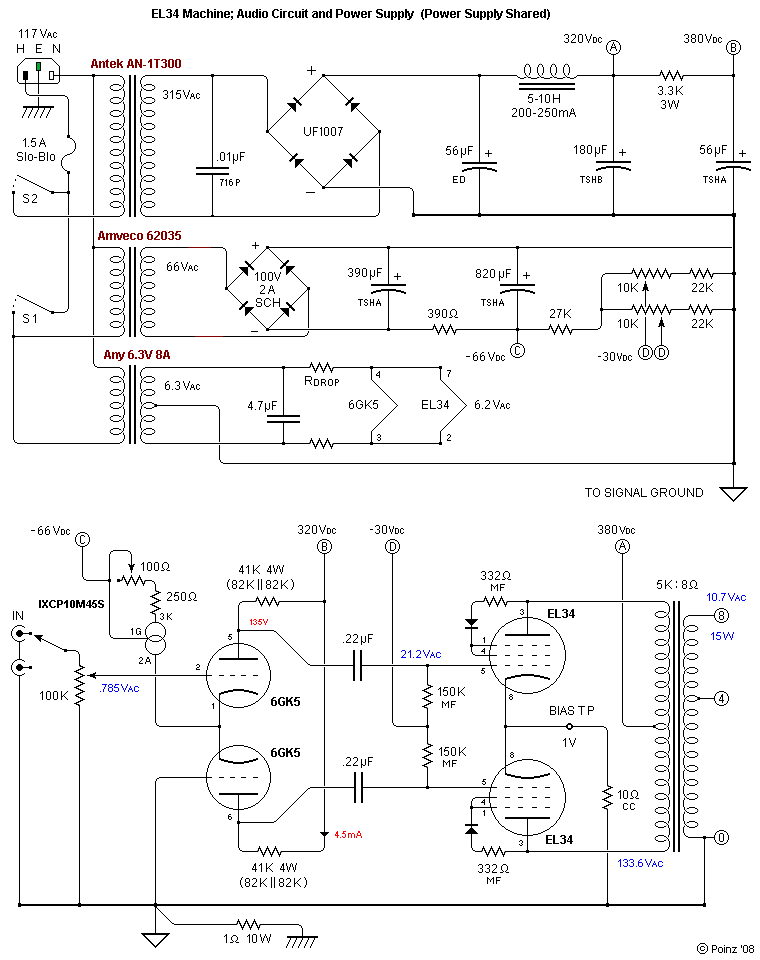

Two things...
1) Would the increased Miller capacitance of paralleled UL EL84's cause a problem for a single 12AX7 LTP? I suspect it would, and Ian will probably say the MOSFET-follower version of Baby Huey would be the best candidate for wiring up with paralleled EL84s.
2) The Poinz Musical Machine uses triode-wired EL34s, not the plate-to-grid feedback Baby Huey uses. I've wondered how a 6GK5 LTP would do driving EL34-triodes. I figure they yield just barely enough gain to swing the 30V peak needed to drive the EL34 grids to full power.
